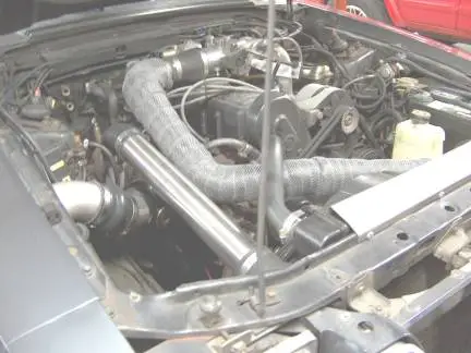

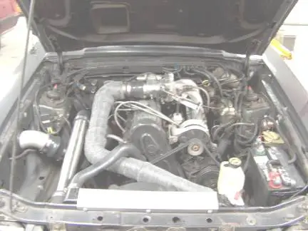

Doc, I'd recommend you buy some header wrap off ebay for cheap and wrap the cold side pipe going into the TB. On my LX car the intake is rotated so of course, it doesn't pick up the header/turbo heat. I can't rotate the inline intake (and wouldn't want to) on the 'vo - and w/o the header wrap, the TB & upper were getting pretty toasty sitting at stops, even w/ the fan on. W/ the header wrap - nice and cool TB, feels just like the cold side of the volvo IC. Doesn't matter how long it sits there w/ the hood down.

Do you have a pic so i can see what you are talking about? I am not against wrapping it, but i spent a bunch of time painting it so i would only do it if its worth it. Any reason why i shouldnt wrap the "hot" pipe too? Does it tend to lose heat? or gain it as it travels from the turbo to the IC. Also would i be better wrapping my Downpipe instead of the IC tubing? Looking at it i wonder if it would be worth it to try and make a shield and bolt it to the studded manifold bolts.. cover the whole turbo so the heat would go down...

lemme try here
Ok, you wrapped the whole thing.. Ill have to look into picking some wrap up. I also noticed today that the cold tube has settled on the Upper radiator hose, Im not sure i want heat transfering though there either.... Ill look into getting some of that.
