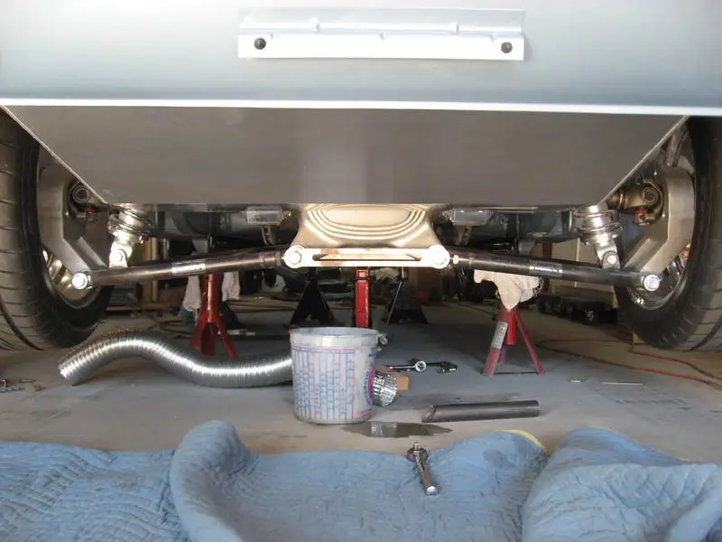

Pics sent, here's one for everyone subscribing, and avatar changed.
That Heidt's IRS looks sweet! :nice:

mustbereel: then you have found a route for your exhaust piping over/around the IRS?
Socal,
I reworked the TCP subframe x-brace substantially to fit the X-Pipe. I have the exhaust tacked up as far as the back of the subframes. The piece of flexible duct in the picture is to help me visualize the path the exhaust need to follow throught the various struts. There are about 3 compound curves to negotiate but I think I can do it. I'll probably have no more than 1/2" clearance anywhere. I'll post some pics when done.

I would imagine the exhaust run would possible right under the center section or just run it out the sides...
The center section is a little too low, although that was my first idea too. The Cobra IRS has little "humps" under it to allow the exhaust to go under it with more ground clearance. I considered side exhaust but between the subframe connectors and forward IRS struts there really isn't room for mufflers (maybe glasspacks but... no).
