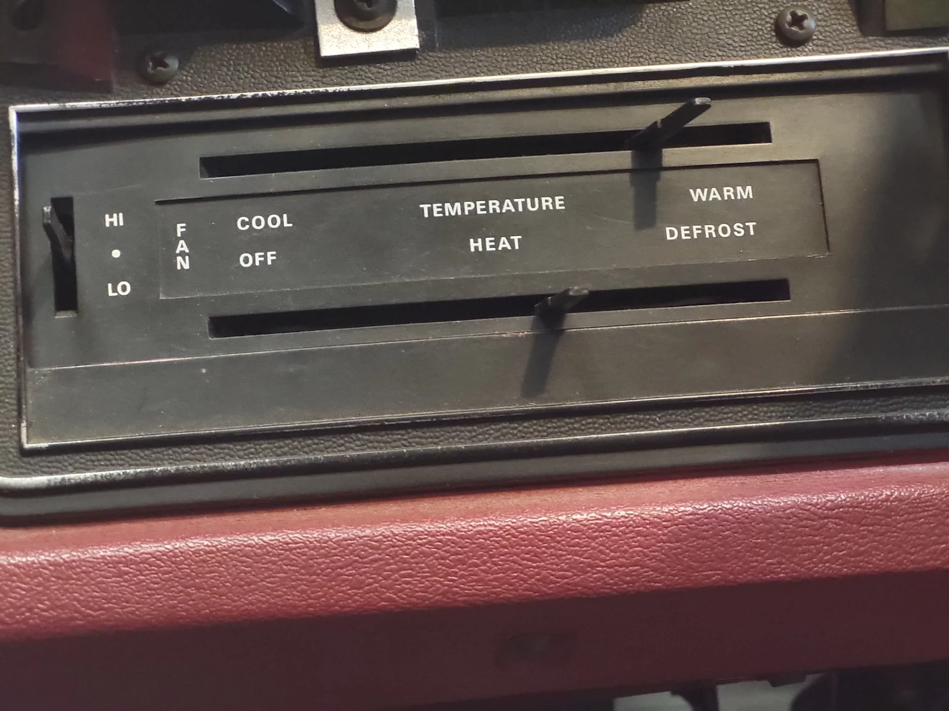

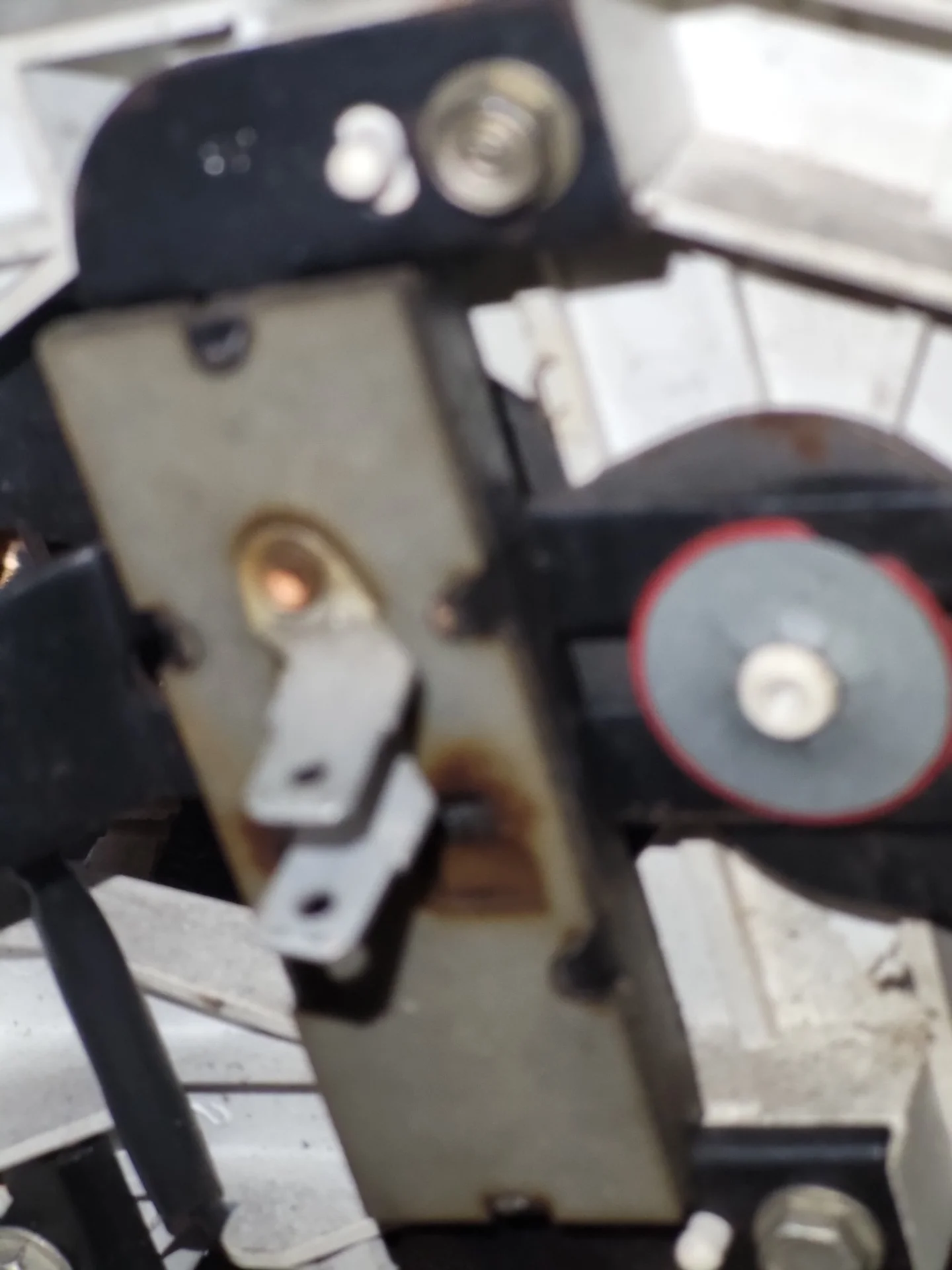

could someone tell me does the fan blower only operate when the car is running, or can it be turned on to by turning back the ignition switch to the aux position.. Also could someone tell me what this two prong clip is for, on the back of the of the heater control. is there any pics on this site showing the wires connected to it. thanks

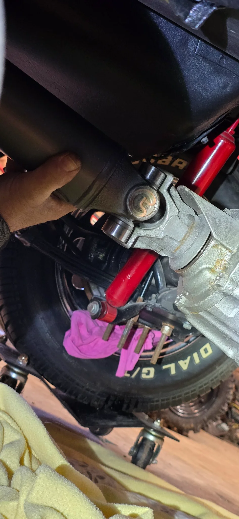

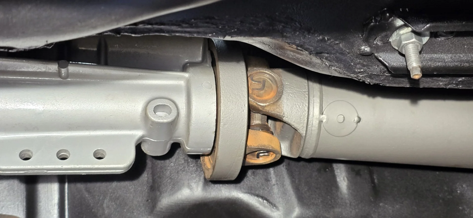

hi guys trying to move forward with the car, hit another snag. When to put my drive shaft on after having it ballanced.doesnt quite fit. the only thing i can think of it because of the new leave springs. Any one ever run across this problem

I can't remember which way it goes, but the driveshafts between the 4 speed cars is different than the automatics. I believe it's an inch if memory serves. Also, if you were to install a T5, I believe they need a shorter driveshaft than either of the originals. So I don't think it's anything you've done wrong or anything, just need to have the driveshaft shortened. It's been a little while since I've had it done, but it wasn't all that expensive. Judging by your pics, an inch is about all you need. (And before someone makes a joke of it, let me beat them to it..... 'That's what she said!' :cool:)

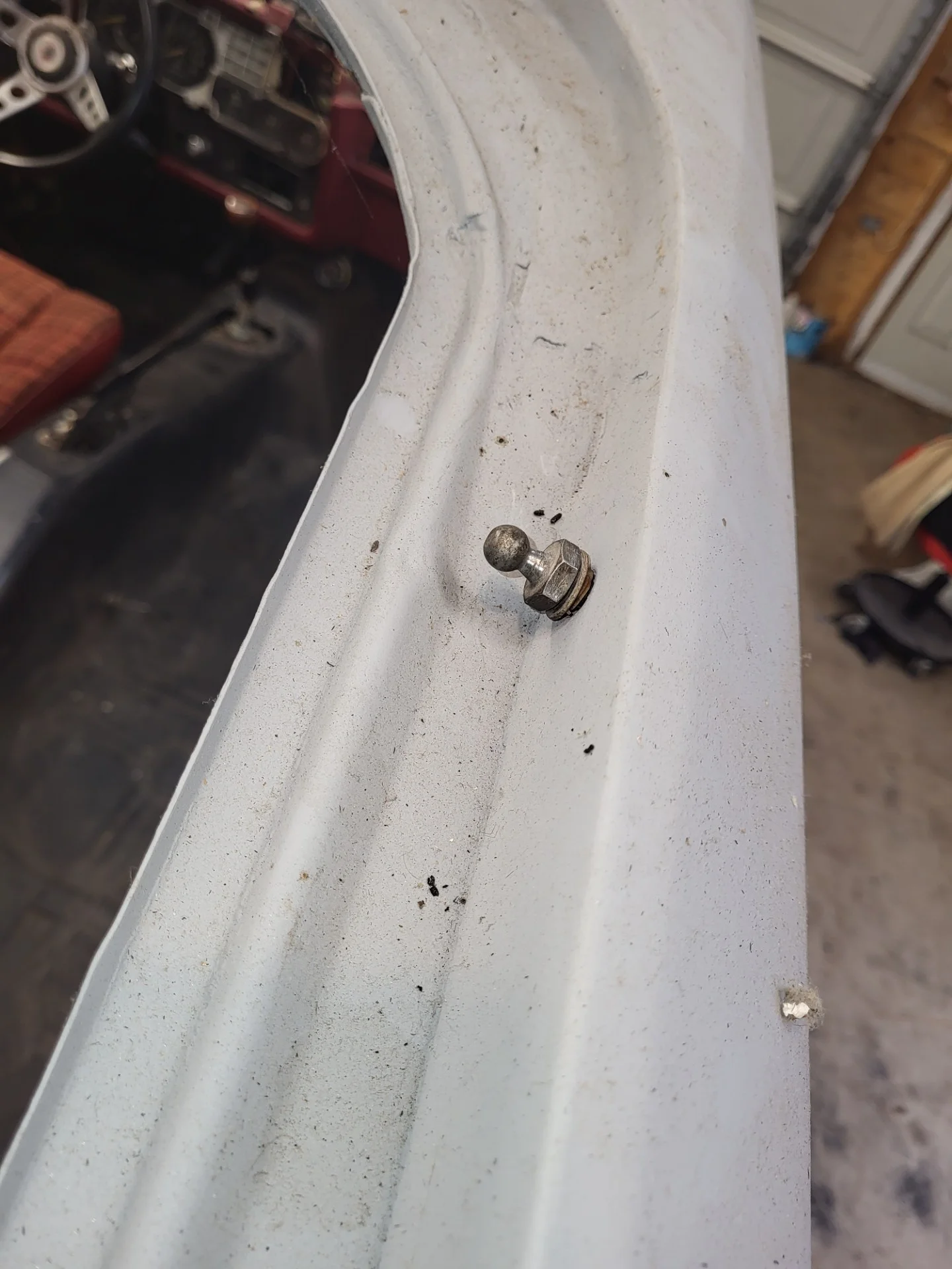

hi this might sound like a stupid question but can some one tell me if the four shock mount ball studs are all the same on mustang two's .,i thought the two that go on the hatch itself were different than the ones in this pic..i have to order new ones, this is one i found. Its been so long can remember where i put the darn things.

If you go on Amazon and search for 'gas struts' you'll get results for all kinds of lengths and push strength etc...
The other thing to note is that most of them come with the studs already:
Now, whether the threads match the inserts in the car is a different matter. O_o
ya may be metric. I have the new shocks which i ordered from rock auto. i am sure ill find them after i buy a set. has any one here bought parts from Phil Schmidt,i am ordering some hard to find parts. Wondering what he is like to deal with.

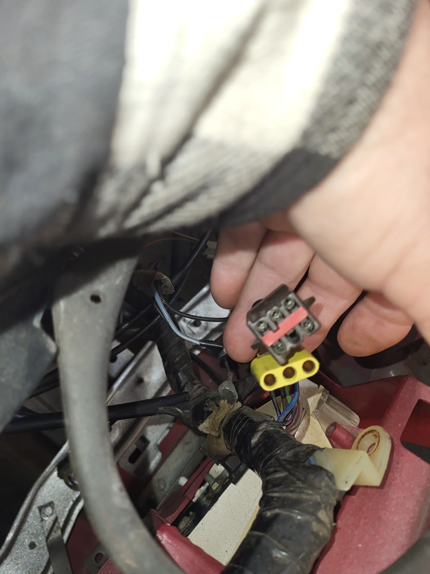

ok,just ordered some parts' must say though the the cost difference between can and the us dollar is crazy. does any one know where these go, what they are for. Just below where the speaker goes.
My only guess - and that's all it is - would be for the stereo. There's no connection like that for the gauge cluster and there's nothing else in that area. The yellow connector also kinda looks like it could be for vacuum connections for the HVAC controls, but it's hard to see clearly enough if it's hooked up with vacuum lines or wires. If it's wires, it's possible it's also for the stereo, dash clock, or maybe a lighted ashtray? I think your best bet would be to get the wire colors and check out one of the diagrams and see what they say.
