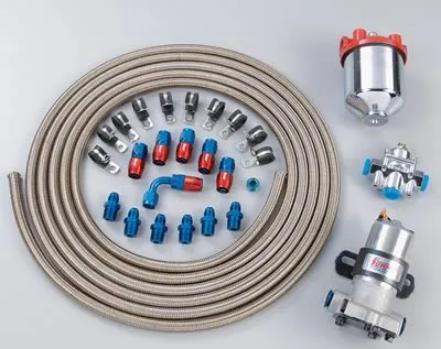

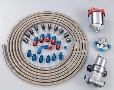

Here is the perfect setup for you
http://store.summitracing.com/partdetail.asp?autofilter=1&part=SUM-PUMPKIT7A&N=700+115&autoview=sku
its a holley blue pump, regulator, lines, fittings and basically everything you need wrapped up in 1 kit. There will be 2 questions on installing the kit... how to tap into the fuel tank and how to connect the hose on the carb. If there are barb fittings, then you wont use the last couple AN fittings, just use a hose clamp. You will run a line on the suction side of the pump from the tank to the pump...I just connect the filter to the pump with a 3/8" pipe coupler then out of the filter towards the front of the car to the bottom of the regulator. From the regulator, choose your favorite side and you will use an 3/8" to -6an fitting into a fuel line to the carb. The kit has everything + some that you will need. To regulate pressure, you should buy a pressure gauge...it will mount to the regulator...or you can buy the carb feed lines with the regulator attached like this: http://store.summitracing.com/partdetail.asp?autofilter=1&part=SUM-G3120&N=700+115&autoview=sku it has a 3/8" pipe inlet, so you can run an AN fitting straight into it (you will need a 3/8" to 6an fitting...which is included in the kit)
wiring is pretty easy... you just need to run a switched hot out to the fuel pump..the ground can be done under the car with a short wire and an eyelet...
I RECCOMEND THIS KIT.. MY FRIEND BOUGHT THIS FOR HIS CORONET WITH A 383 ENGINE HE RAN ABOUT 8-10 PSI ON HIS.. IT COMES WITH ALOT OF EXTRA TUBING..
GO WITH THE 3/8 LINE.... EVERYTHING IS IN THAT KIT TO DO THE INSTALL ALL YOU NEED EXTRA IS TEFLON TAPE and some other things thats all....
