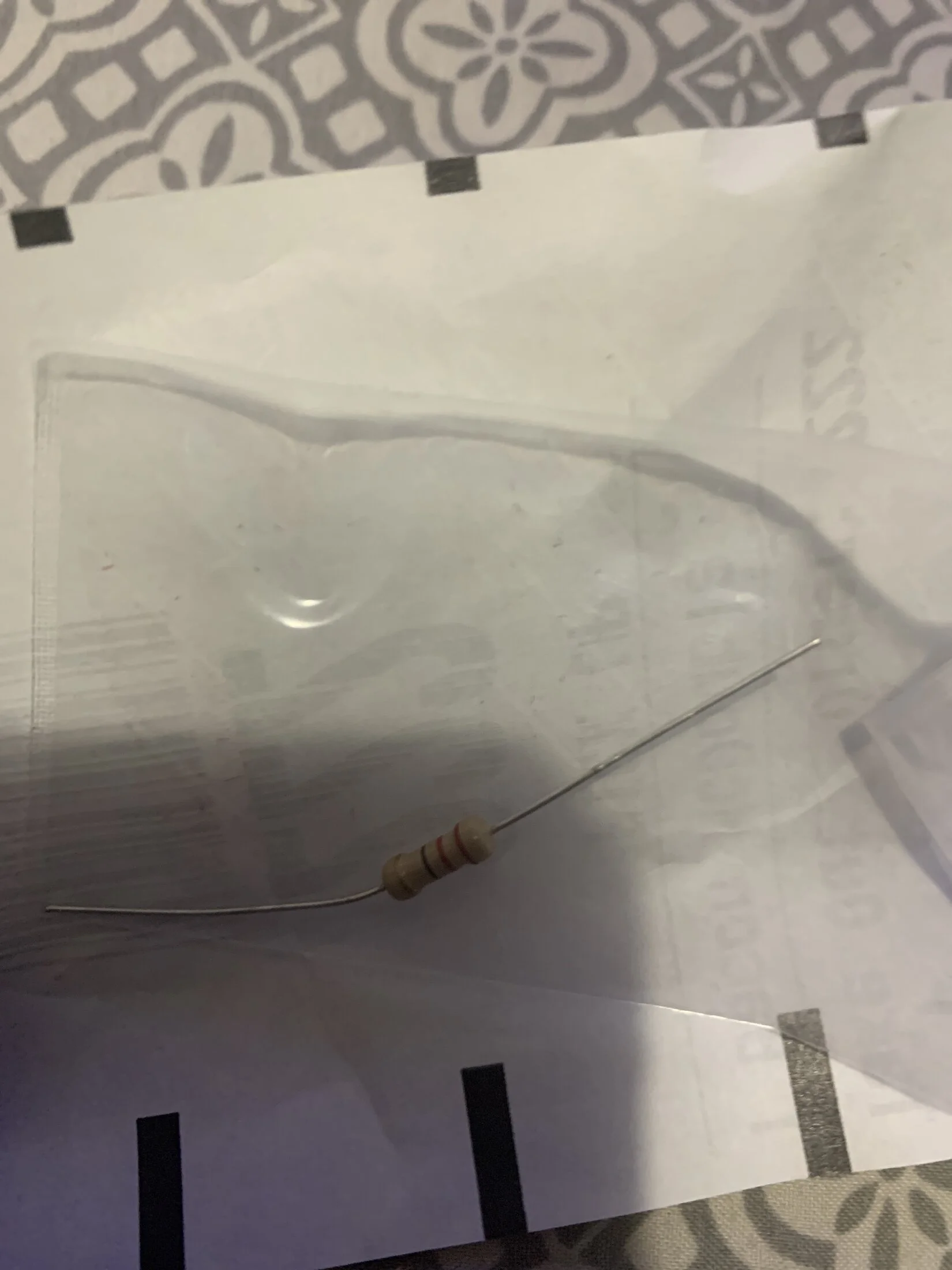

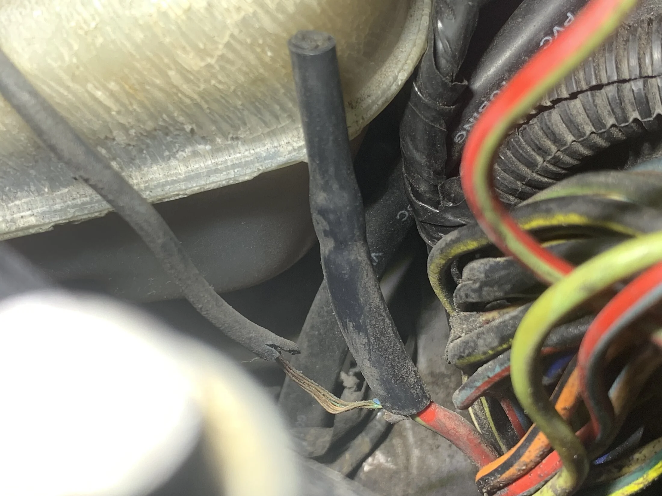

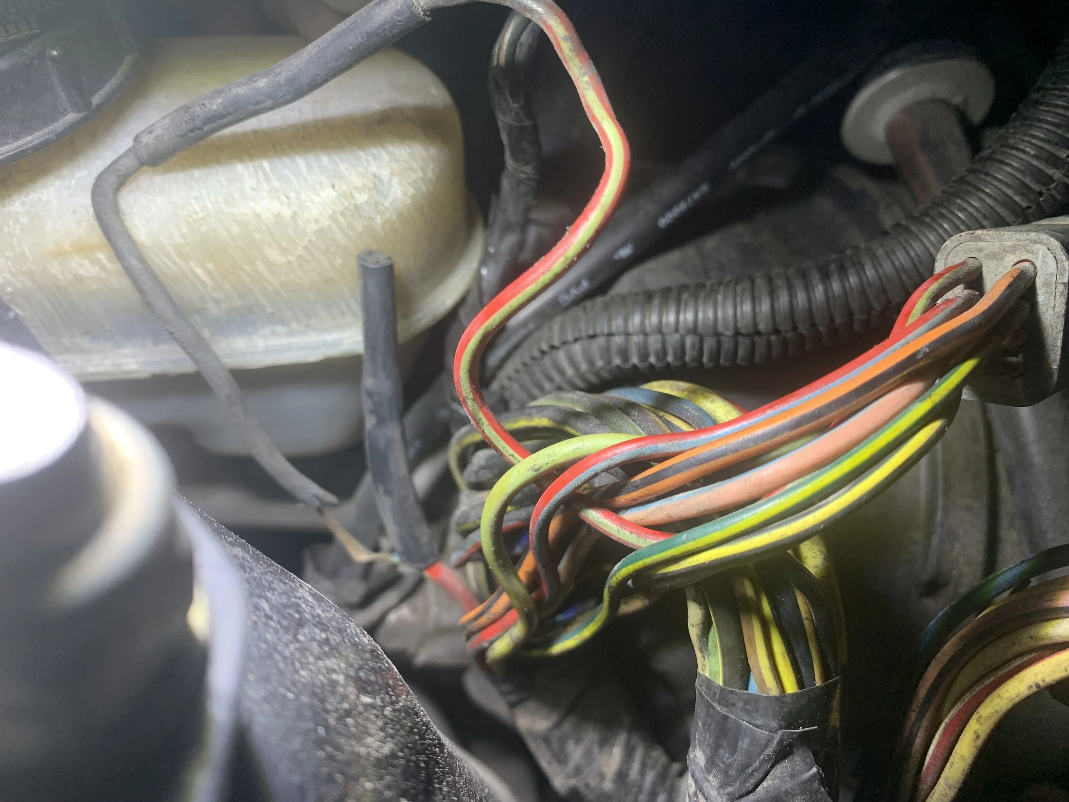

I found one but does lot look like the wire one. The one on car looks like a fuse link this one looks like this. It’s a 22ohm 1/2 w .Is what the guy said also that 22ohm resistor is one the wire for -coil. The 22 ohm resistor looks good at least to me and I have no idea what I’m looking at. But I know there is an issue with the coil wiring. The fuse link on the red/green coil + wire looks soft. I peeled off the blue covering and the wires were a little corroded. Where can I get a fuse link? When I get fuse link can I use a butt connector to splice it to the wire?

You never tried running this thing without the SPOUT connector, right?
Hmmm . No I haven’t ran it without the spout. I didn’t try any of those things mentioned. I have some issue where the coil sometimes has 12v & sometimes it dosent. When can turns on it has 12v. But it shuts off & then I go with multimeter & check for voltage & not even 1 volt when car dose the crank no start after it shuts off. So I figured there is an open in the wiring. By the way checking voltage key on & coil connector not connected to coil. Just probing the connector.
Gotcha. I was just thinking in my head that maybe code 18 was set because you ran car without the SPOUT connector. Im going to search up a few videos i watched on how the coil operates so you can get a better understanding of how it works. Be back in a bit
I have the tools I think I found the issue to this thread & the shut off on hiway. Voltage not going to coil. It was the fuse link n drivers side pillar tower. Pulled wire out connector 201 or c201 then found fuse link soft & corroded. Still gotta swap it. If that doesn’t work I’ll splice into red/green coil wire kinda but the ignition switch & just run a wire straight to + coil. Thanks you and yea I saw hat video as well . Thanks to all of you but ultimately got help from some guy named Kennith Collins. Thank you all o yea the code 18 was coming from me swapping distbutor multiple times pulling spout while on to set timming I hope lol once I straighten that coil wire I’ll check for codes to see if that 18 went away
