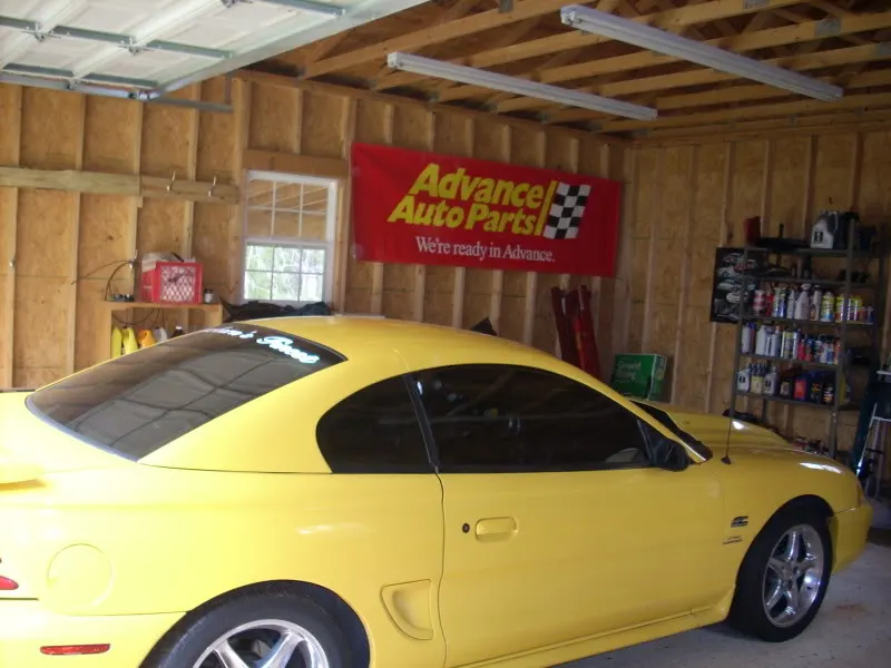

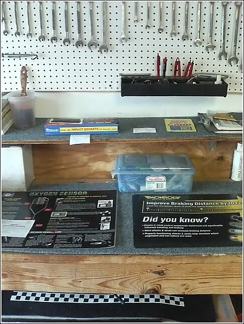

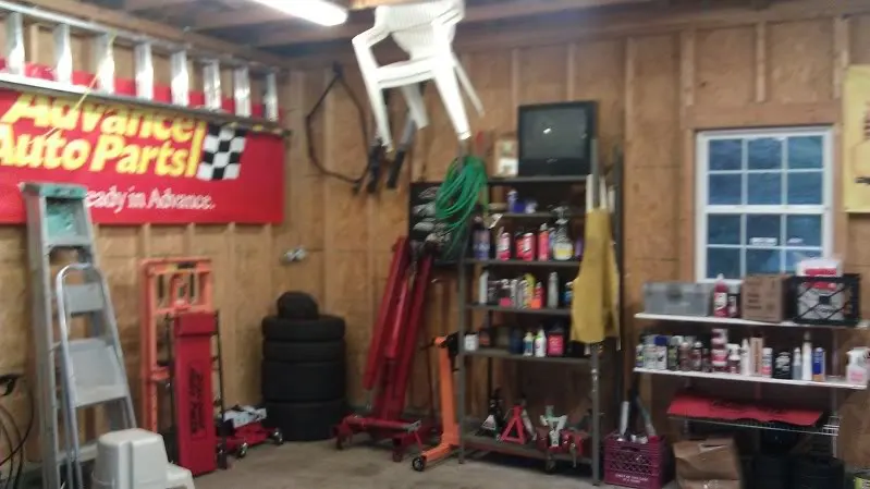

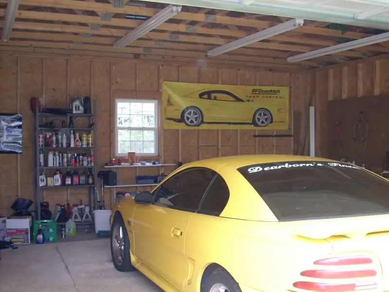

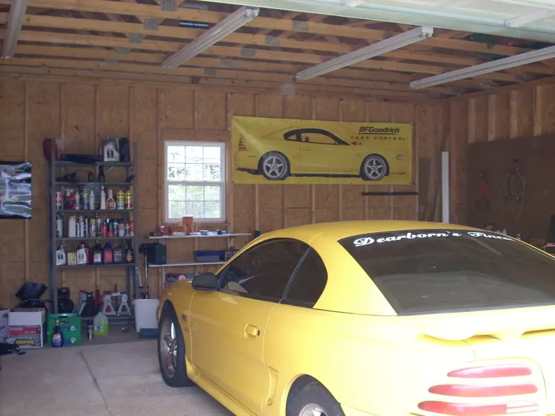

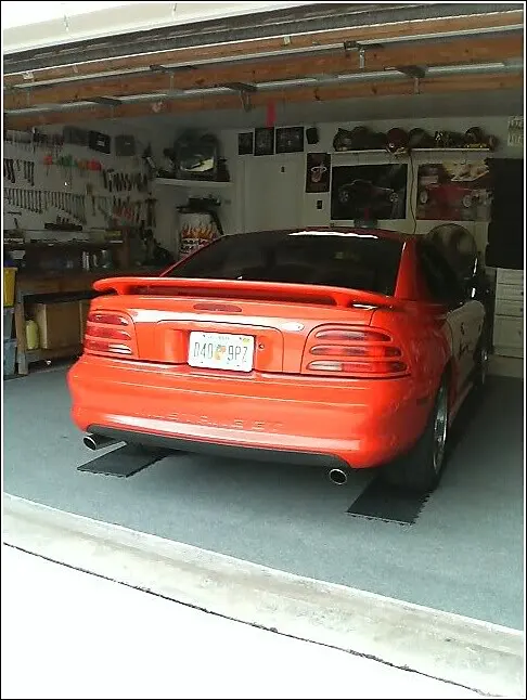

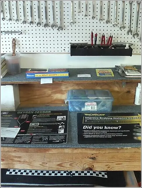

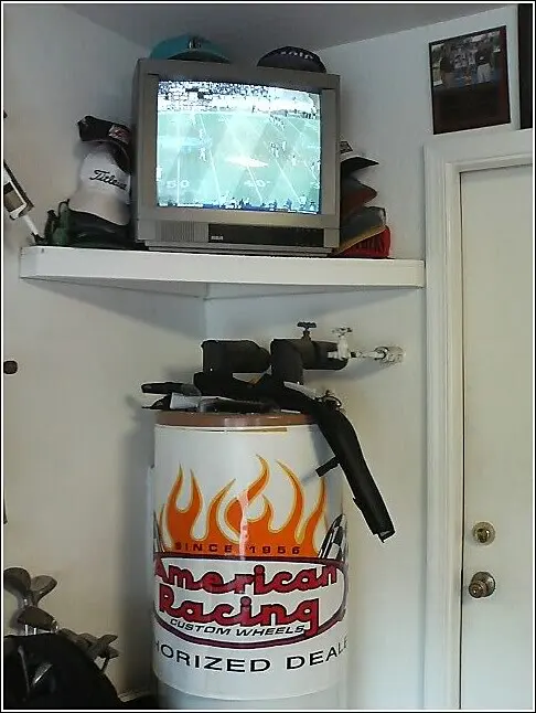

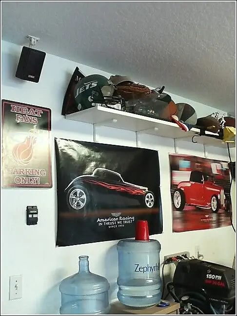

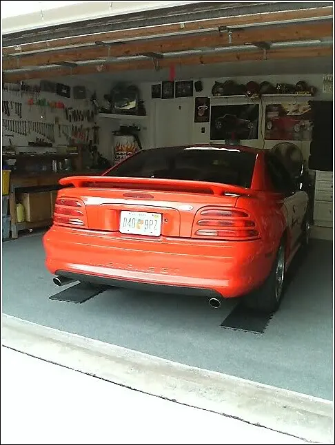

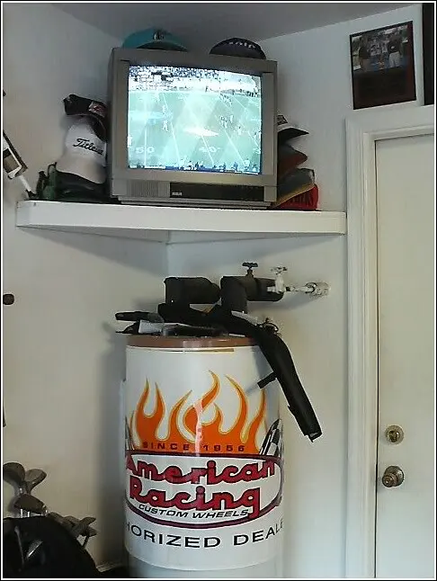

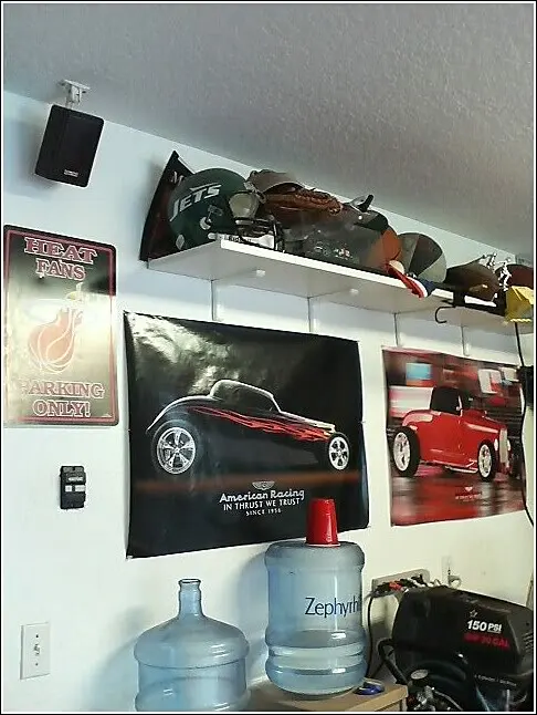

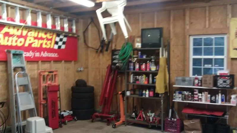

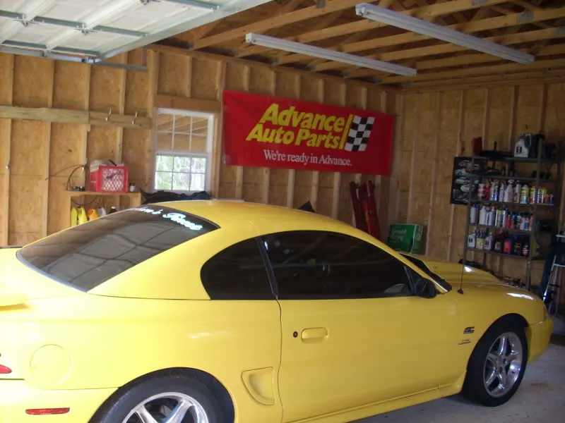

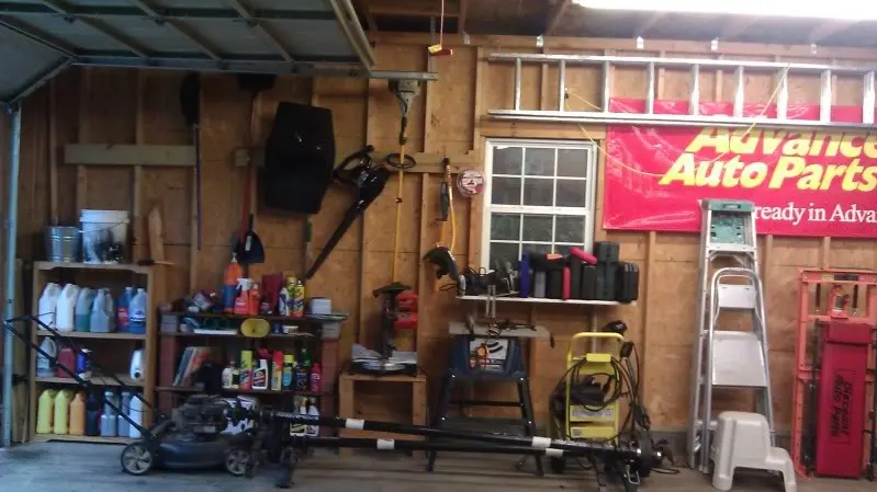

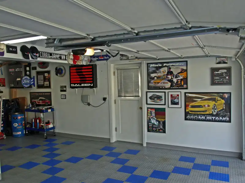

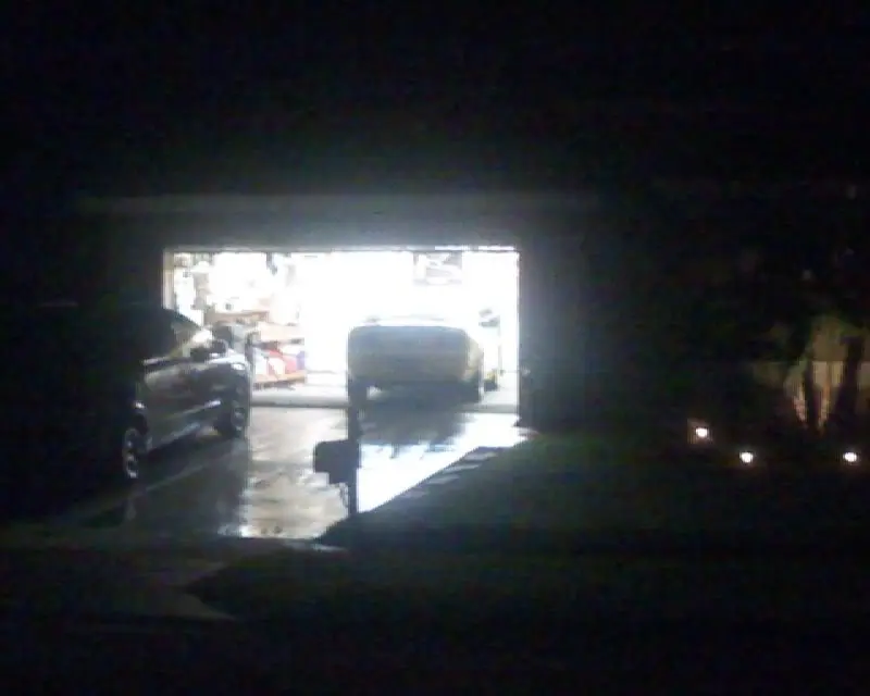

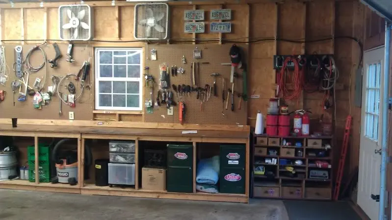

I've got a 2 car garage. I want to put a shed out back to get a lot of this stuff out of there so I got more room. I've pretty much turned it into a shop. It's got everything. I got three 6 foot tall cabinets I put on rollers that have doors so I can put all crap inside there and close the doors. I've got 700+ watts of lighting so I can see everything clearly plus work at night. I've got work lights hanging from the ceiling. I've got peg board with all wrenches in order, screwdrivers in order, pliers in order. I have a Craftsmen 5 foot tool box (3-tier), Craftsmen 26 Gallon Air Compressor with drawers full of pneumatic stuff (chisels, cutters, drill, ratchet's, impact guns, etc.). I've got a TV with cable, CD Stereo with Bose Speakers and 10" sub for surround sound.
This first pic is really old. All that stuff to the right is gone, have cabinets now. All the tires and clutter is gone. The small tool box bottom left has been replaced with a big red Craftsmen. I'm using this shot for the floor.

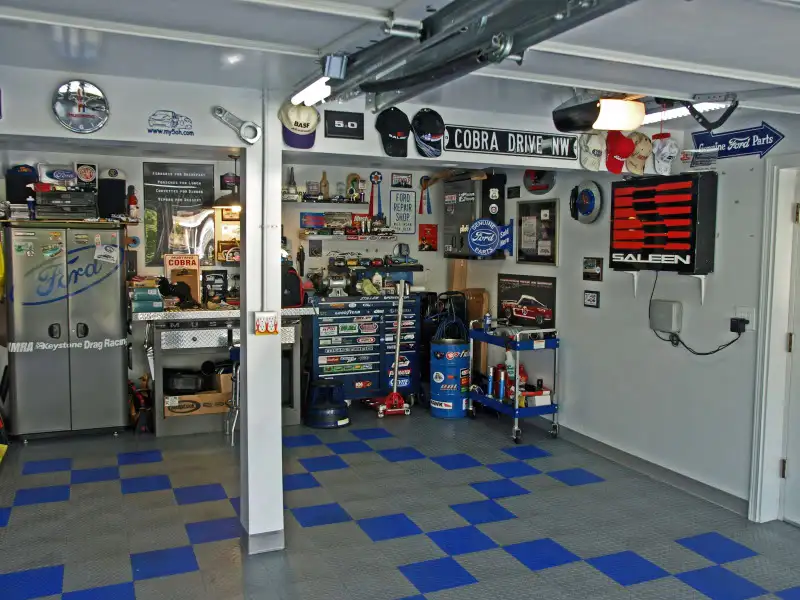

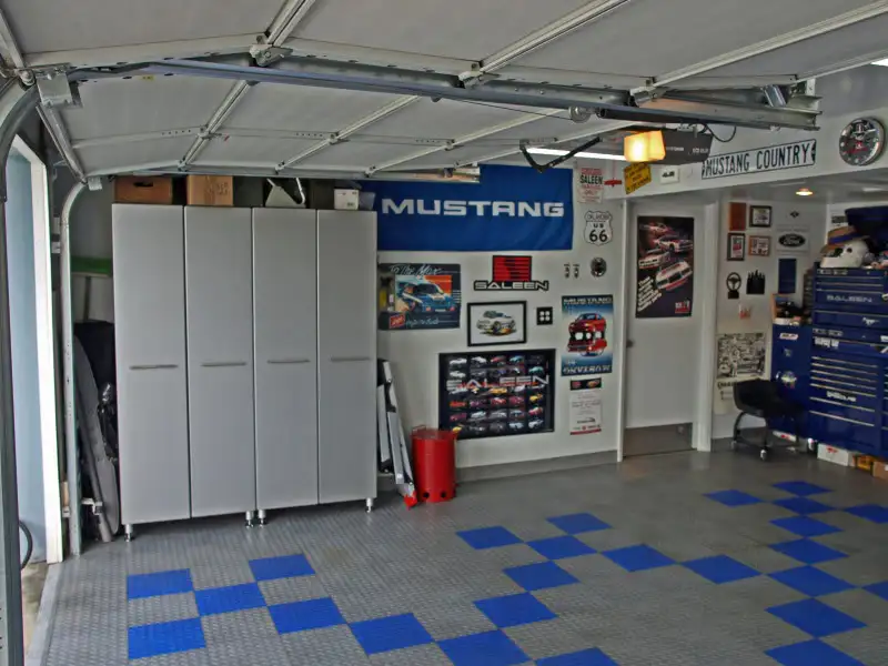

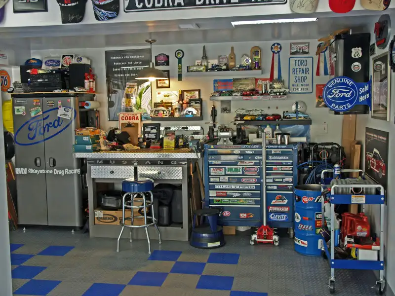

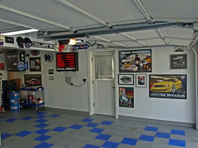

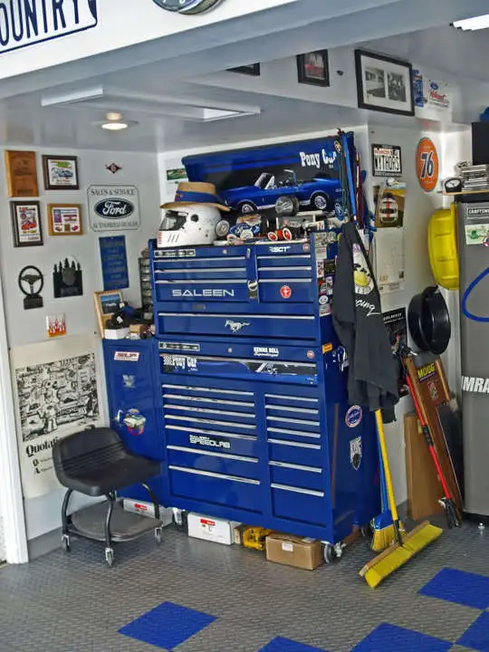

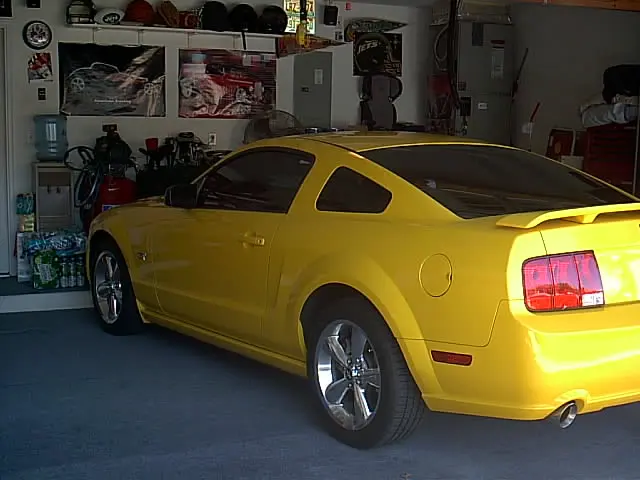

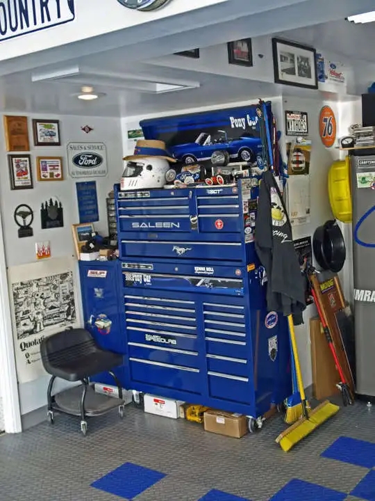

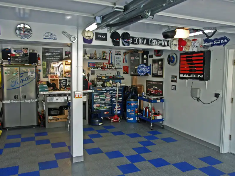

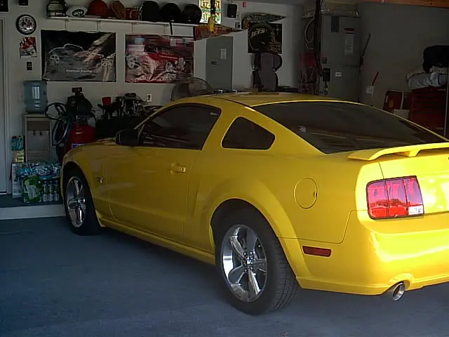

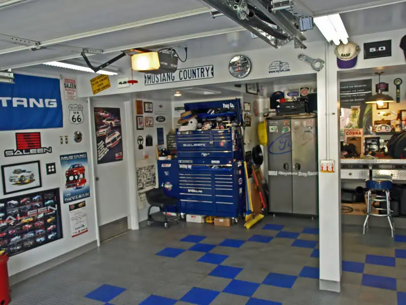

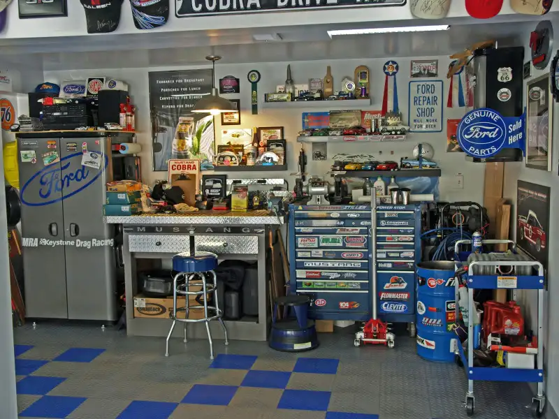

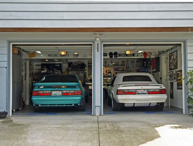

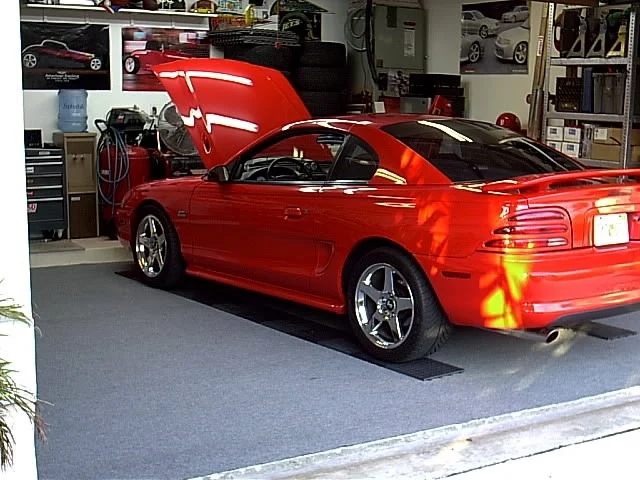

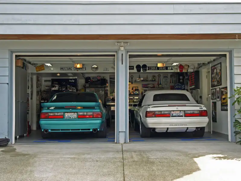

I have a fairly small 2-car garage. It is 19 wide by 23 deep. When I finished it, I bought a 6x6 garden shed at Sears. It's big enough that all the yard stuff fits in there. The garage is strictly for car stuff. For storage, I have a Craftsman Professional floor cabinet and one of their wall cabinets for all the car care products and miscellaneous liquids like carb clean, oil, etc. Those cabinets are great because they have storage in the doors, as well as shelves. I also have two 6-foot Craftsman cabinets for general storage. They're shallow enough that I don't lose much width for parking cars, but wide enough to be useful. My two 42-inch tool boxes, the work bench and my compressor take up most of the extra space. It's cramped with two cars in there, but I can still work under the hood of one of them easily. For big projects, one car has to move outside.

Don't be jealous. What you see there is almost 50 years worth of collecting stuff and it took me over 40 years to have the combination of a house of my own and enough disposable income to pull it off.
My basic advice would be get all the non-car crap out of the garage, have lots of organized storage and do something with the floor besides bare concrete. Floor paint, epoxy or something like the Racedeck I have will make the space brighter, more pleasant to work in, easier to keep clean and make it MUCH easier to find that nut you just dropped than the unfinished concrete floor. Take it one step at a time and do it right the first time. It will save you time and money down the road.

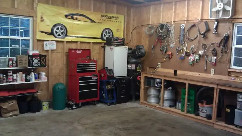

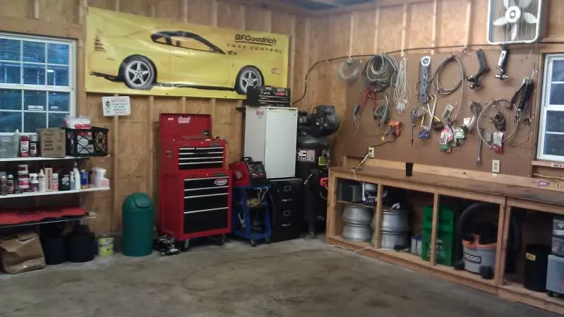

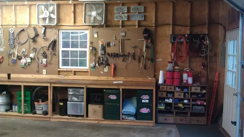

Ok, I finally remembered to do this and uploaded more pictures to photobucket. I am a very cheap person, not like I have a choice, but here is my shop space.

Thanks Kurt. I'm sure i'll end up with something more like your setup than the others. I am also a cheap person. The big difference for me will be the floor and painting the wood stuff to make it fit in more with the color scheme of silver and black.
FWIW, mine is at the same time more disorganized, dirty and cluttered than yours that is it truly embarassing.
That's my shop after I spent 2 days cleaning and organizing it. I just got a customer's truck out of there that weekend. So that's about as good as it gets.

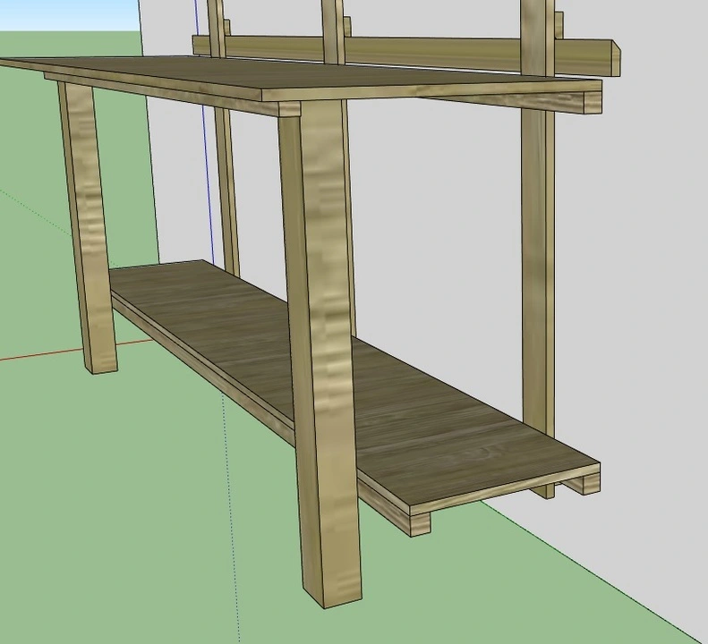

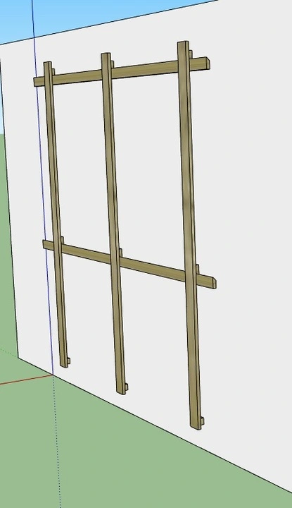

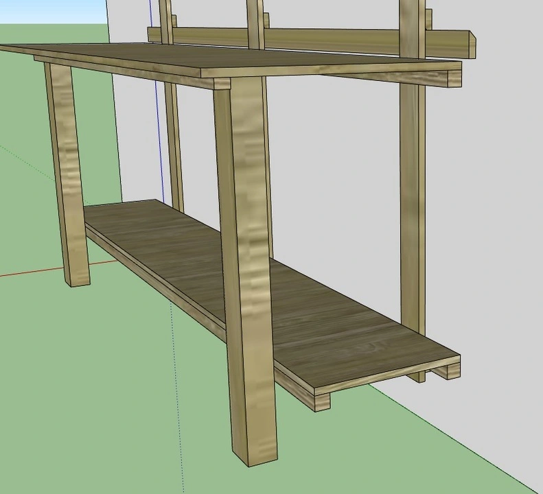

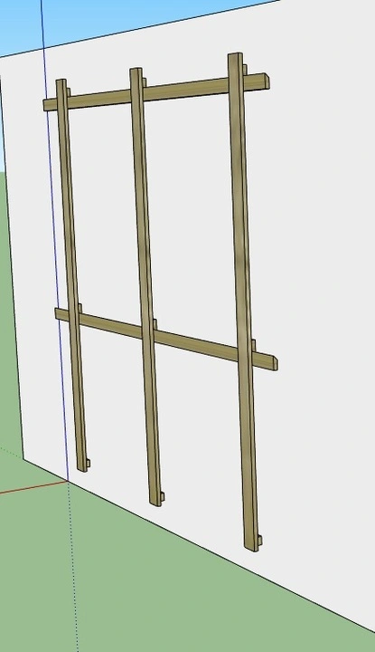

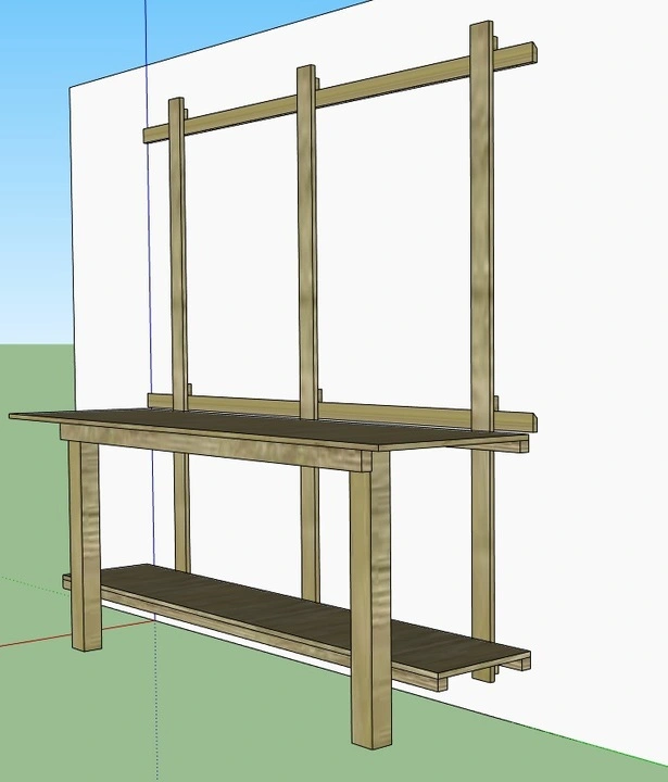

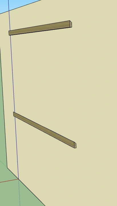

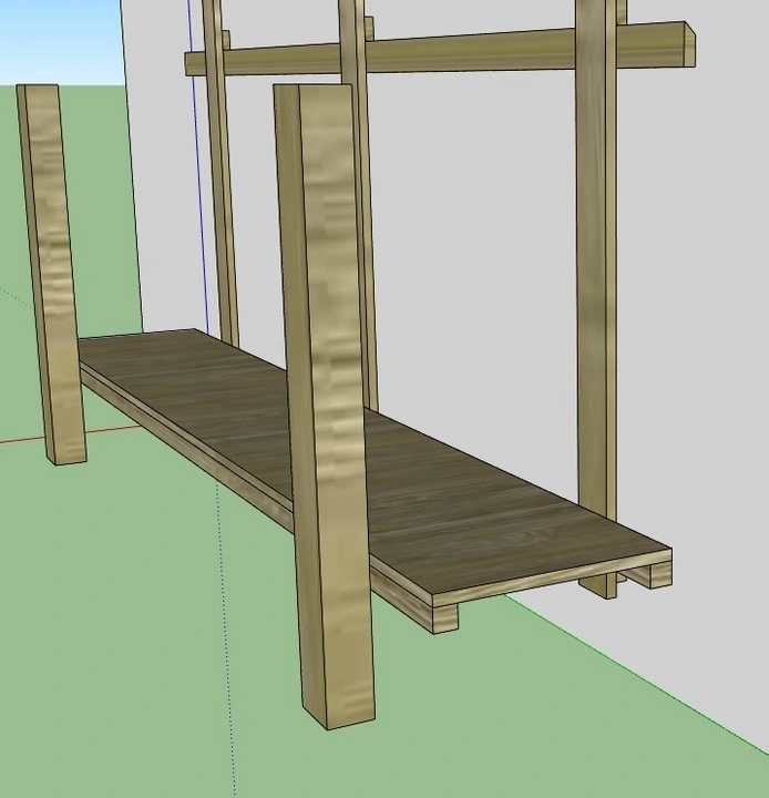

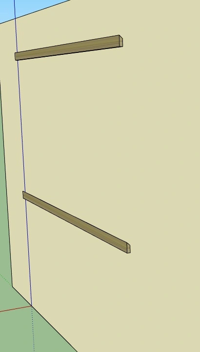

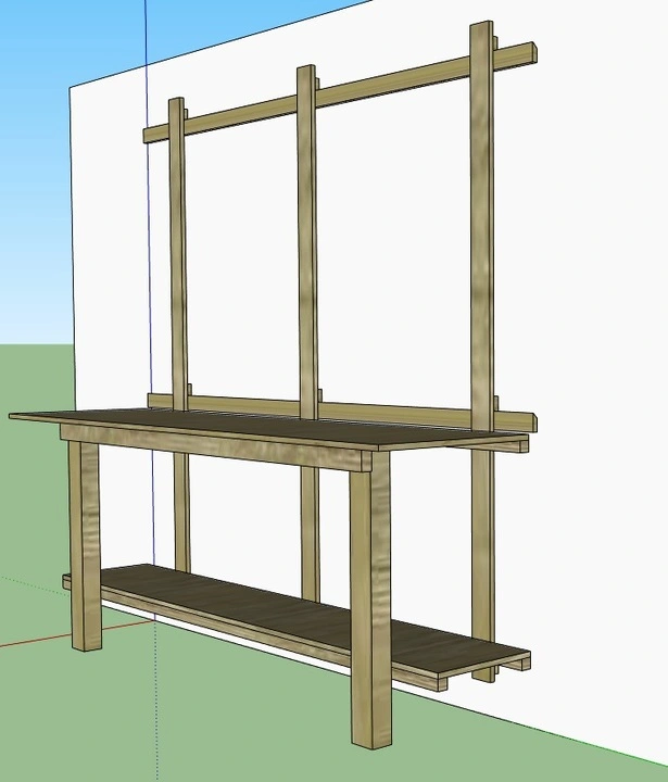

after much research, i have decided to base the whole organization system off of 2 long french cleats that will run the length of the garage. one cleat will be near the ceiling, the other about 1/2 way up.
i'll post up the plans as they develop

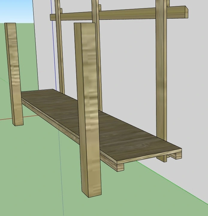

here is the plan ... i really need to get back to work ... :(
a cleat. this is a 1x3 ripped at 45*. the other side is also a 45* piece that hooks on. this is used alot for cabinetry, and they are amazingly strong
the cleats, on the wall with toggle bolts. there is no possible way these will fail!
the brackets everything will hang off. there is a spacer at the bottom
the bench support. i will bolt the 2x2s to the brackets and legs together for added strength, and i might use 2x3s
the bench top. i currently have a 24" piece of plywood, thinking about going to 30" though
the workbench
... still not sure about pegboard, or more cleats on the brackets to hang stuff on ...

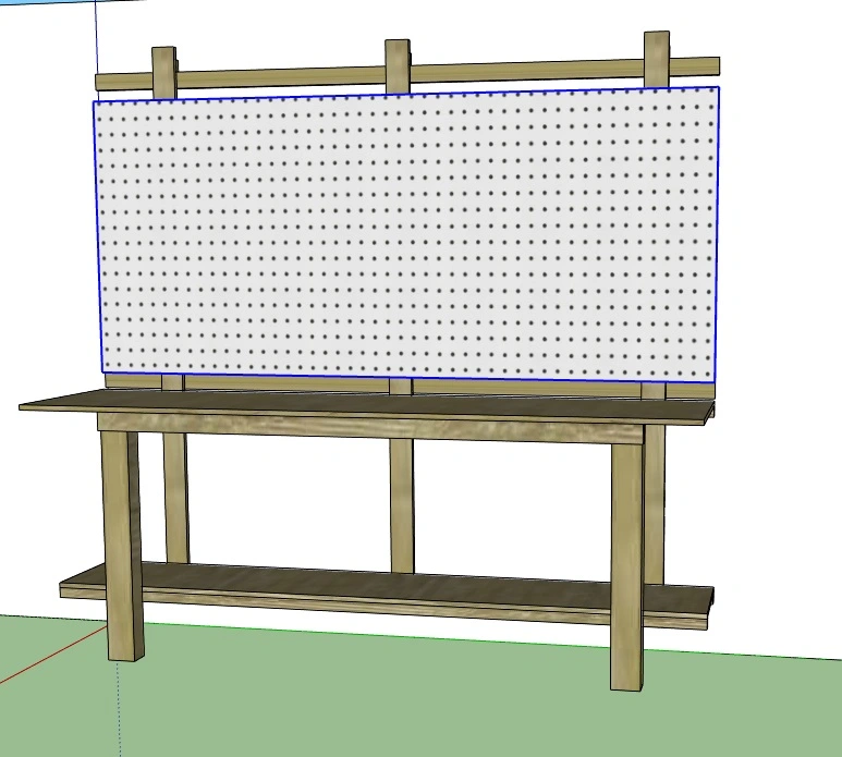

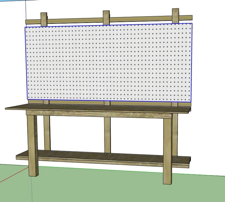

The peg board can bolt to the top portion the way you have it. You'll probably need to put one 2 x 2 in the middle of the top part. I have 3 rows, your diagram shows two. The peg board comes in specific lengths. You'll have to have your top proportioned with the peg board sheet. I did mine the same way. I have the peg board over the work bench.

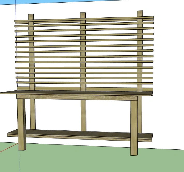

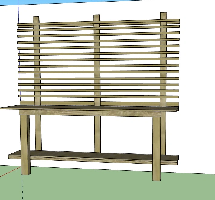

Yeah, that is what makes this approach so attractive to me ... it is extremely flexible.
I'm not 100% sure I want a peg board. The way the hooks come off so easily bugs me, even if you use those little plastic hold down things.
Another option would be 1x2s going across, sort of like this. Then screw in hooks or nails would be the hangers.
