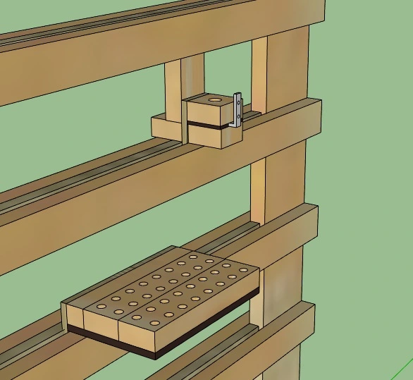

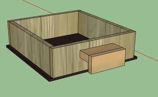

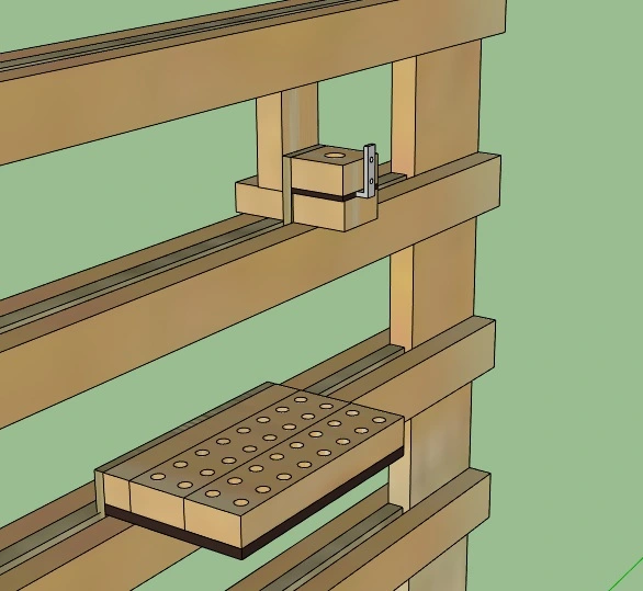

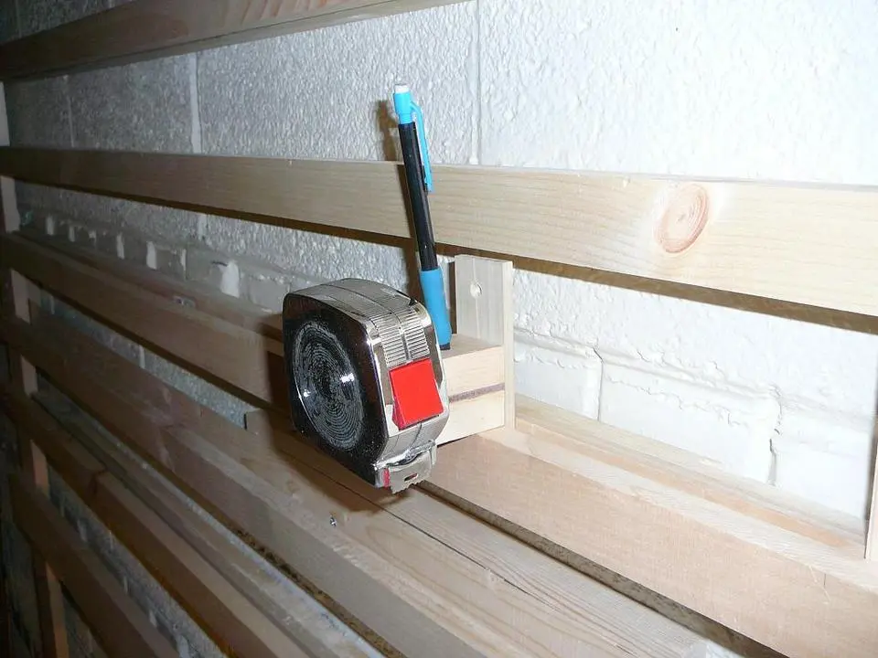

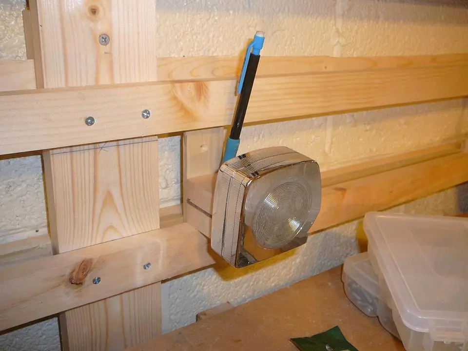

Here is a rendering of the first 2 holders I have made: the top one is to hold my pencil and tape measure, the lower one is for the quick change bits for my drill/driver. They all have 1/4" shafts, so a 5/16" hole holds them all ...

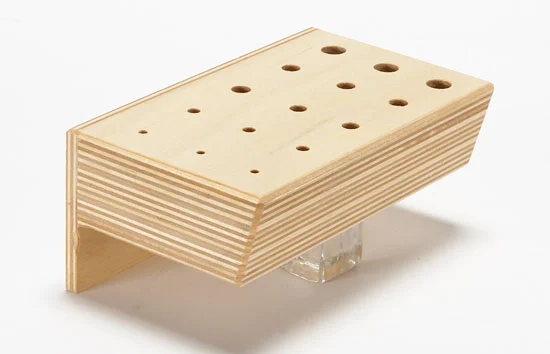

Here is another holder the guy who wrote the article has ... this one for allen wrenches (he uses plywood for everything):

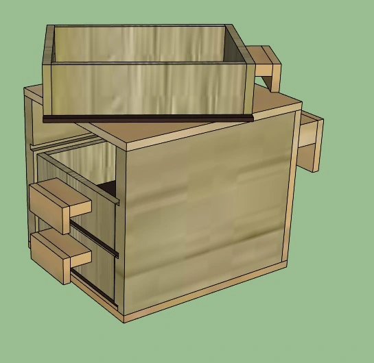

Ok, I promise to stop with the Google Sketchup stuff ... last drawing until I have real pics to post.

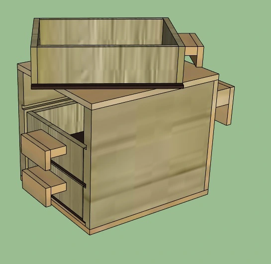

Here is what a little cabinet with 3 drawers would be like:

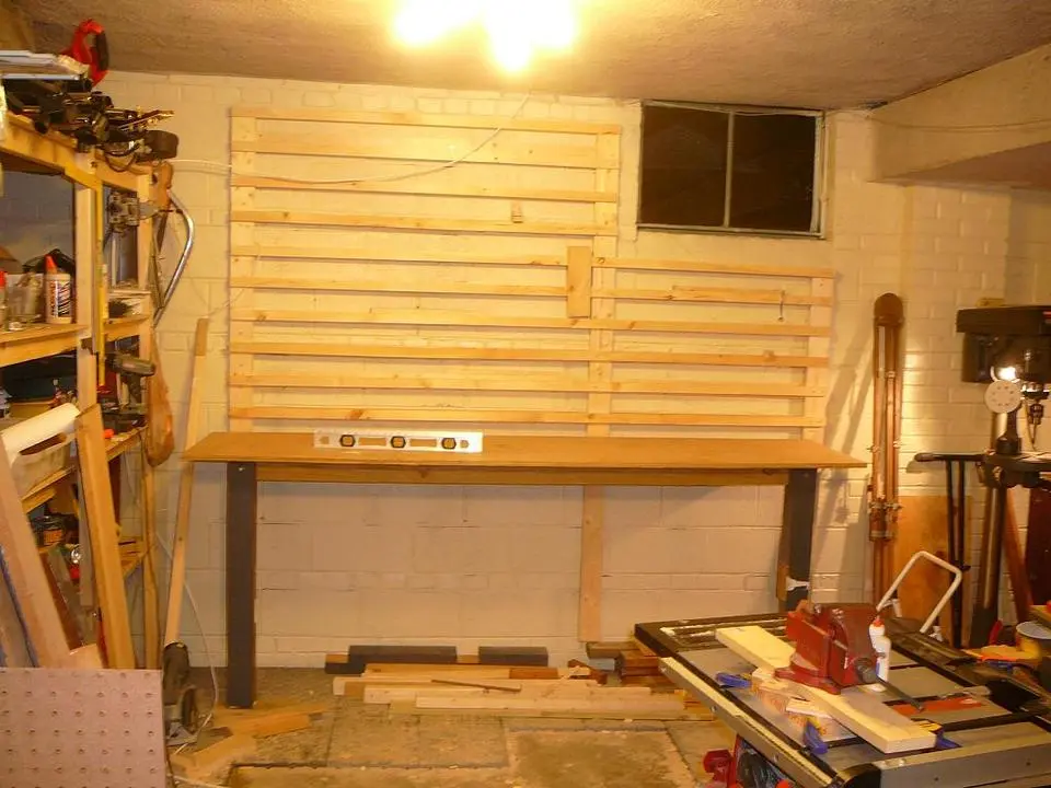

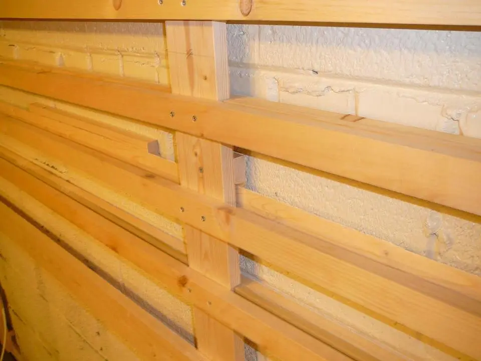

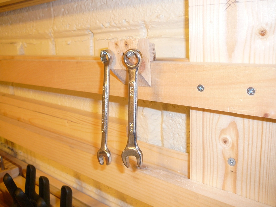

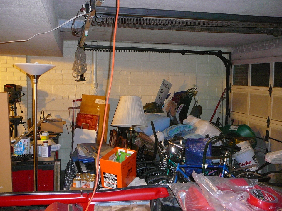

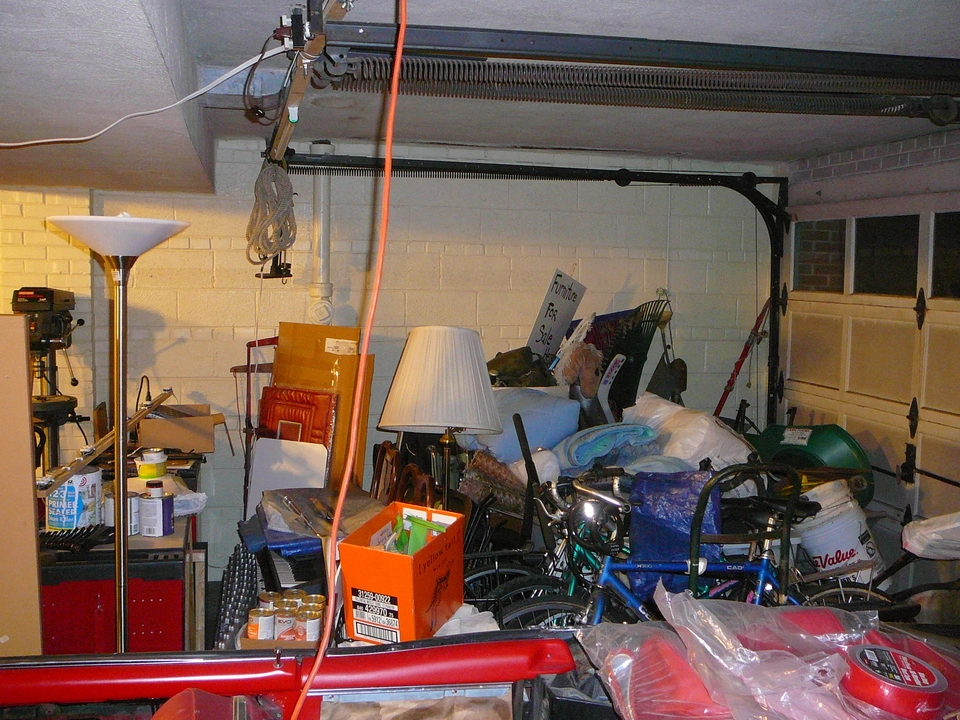

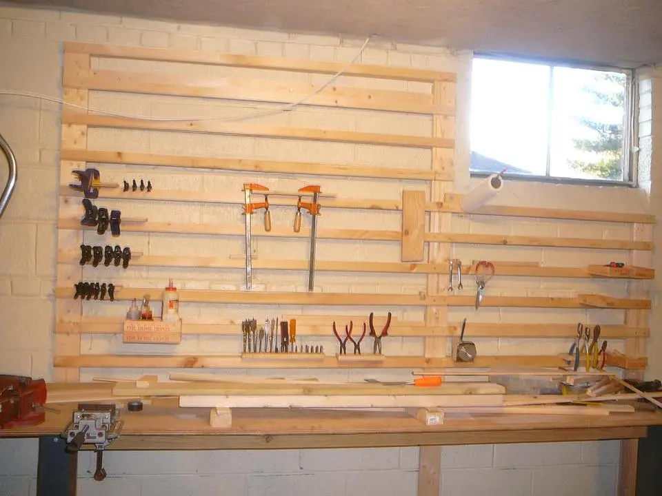

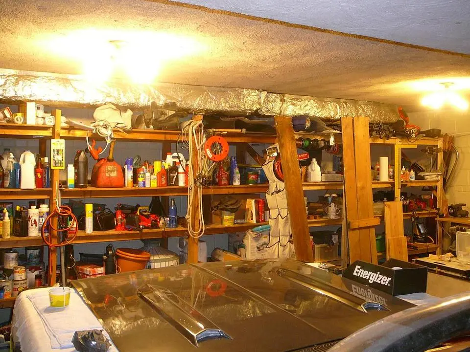

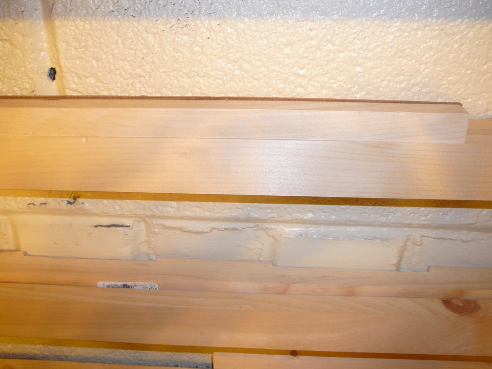

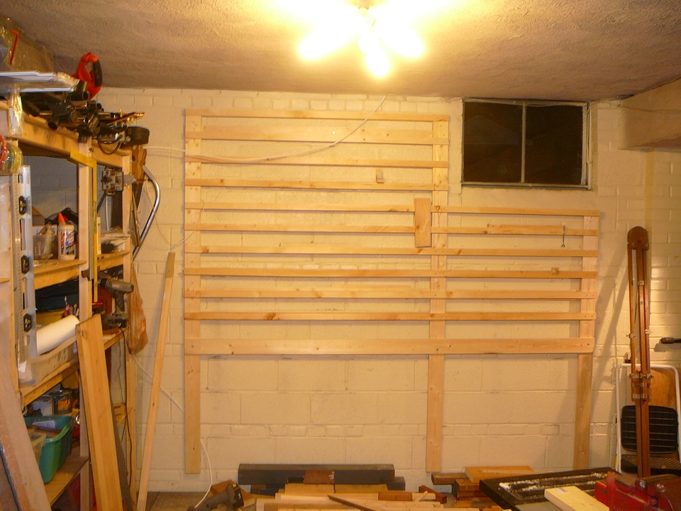

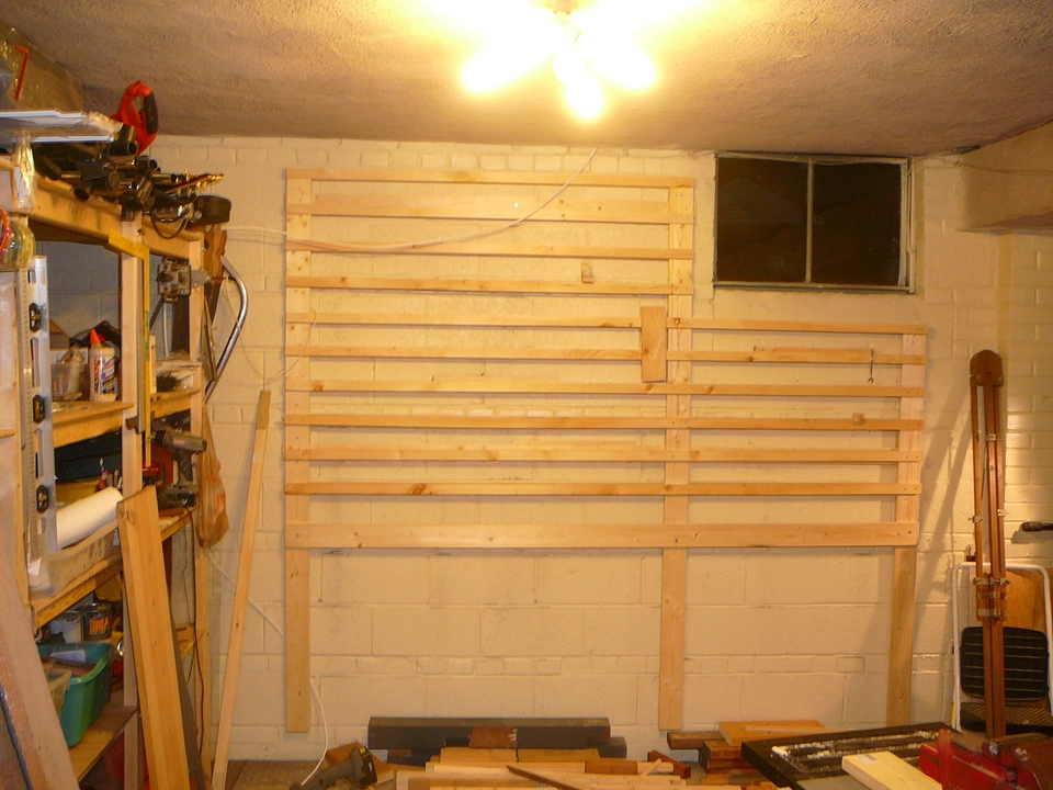

before

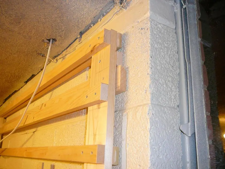

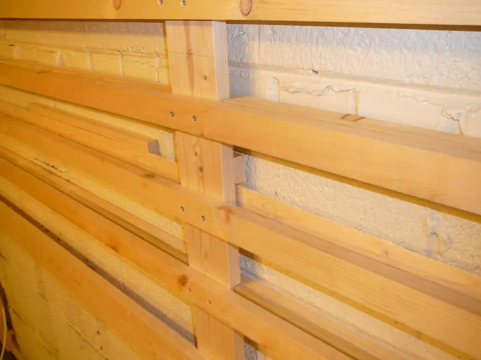

the cleat
some bricks were sticking out
the base
it is very strong

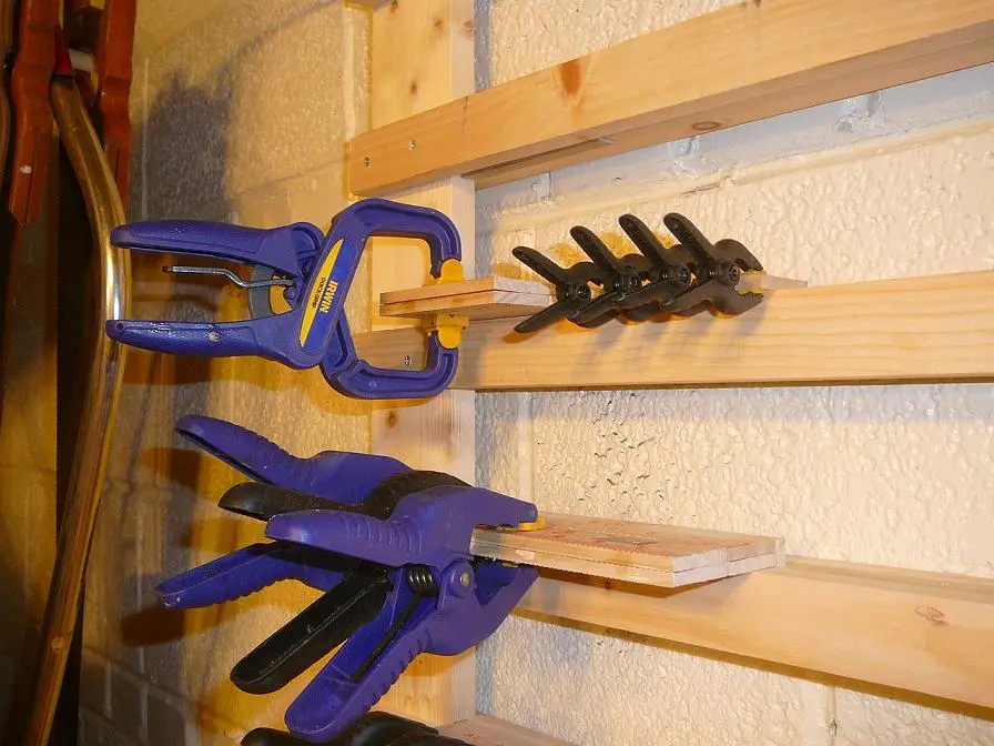

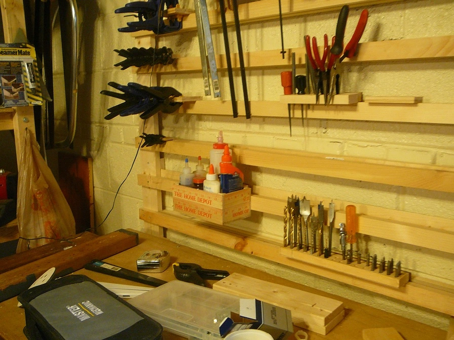

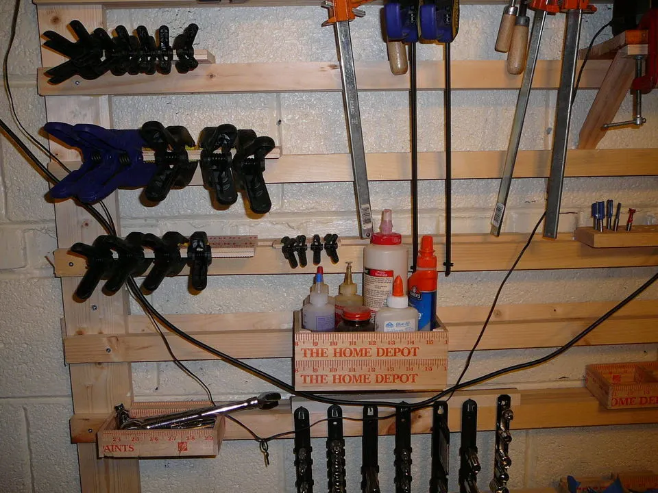

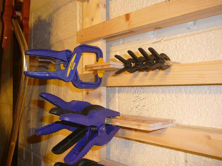

a few hangers

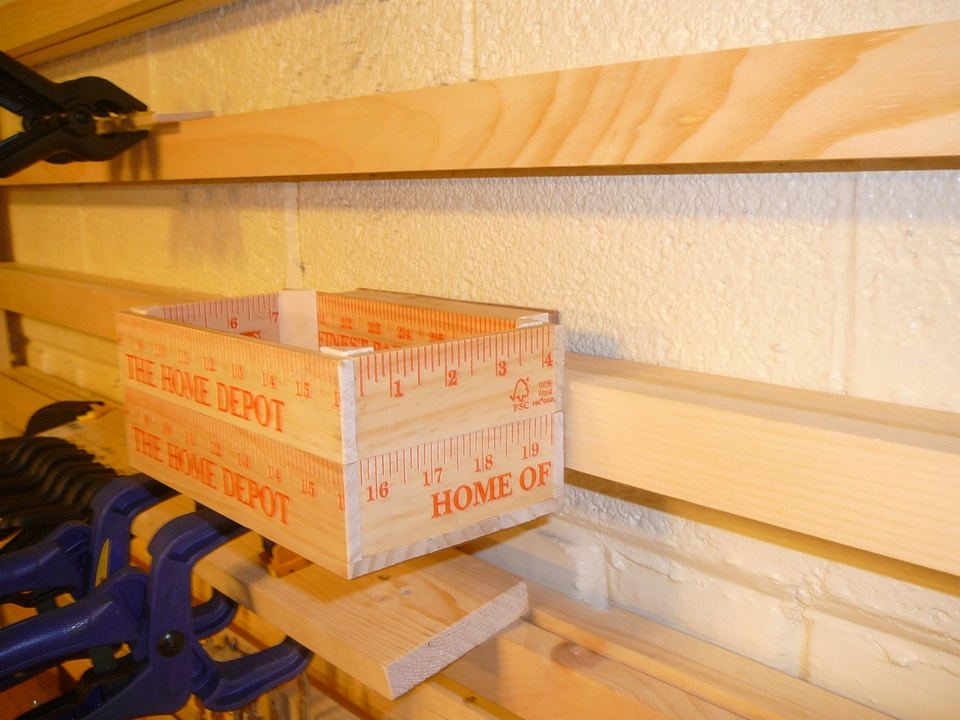

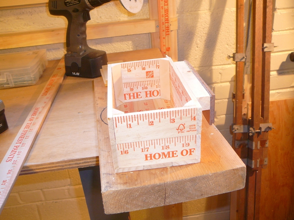

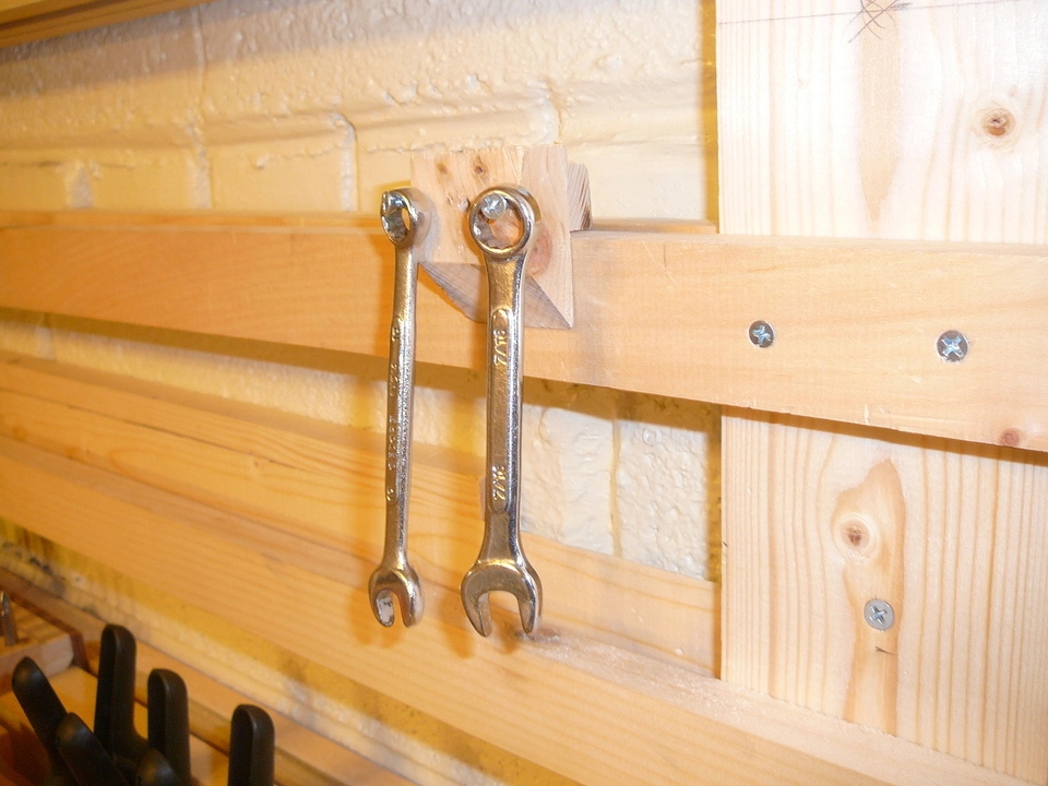

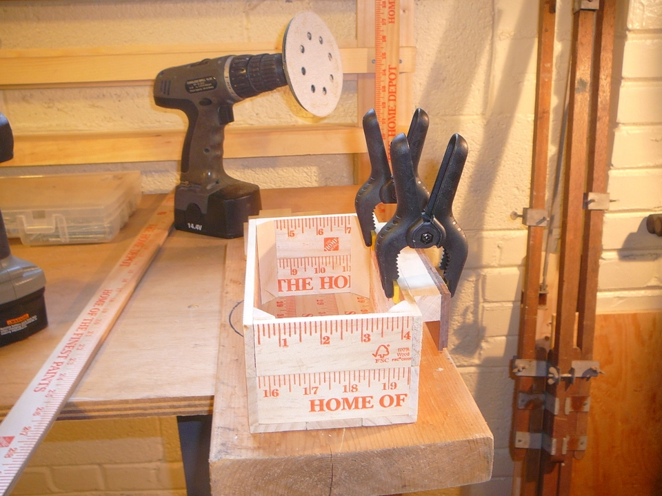

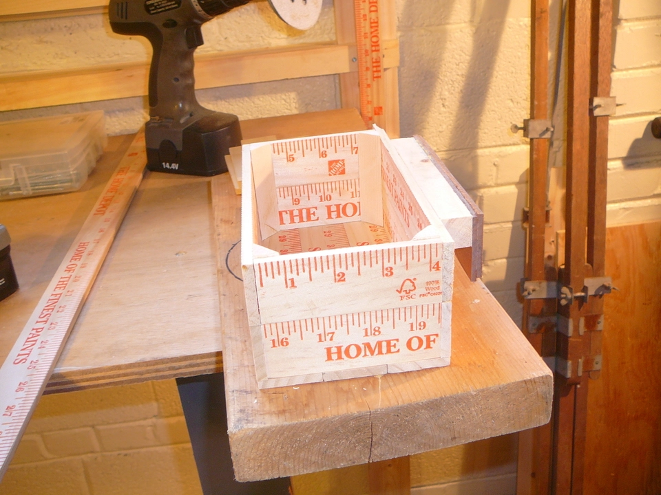

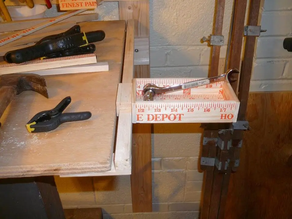

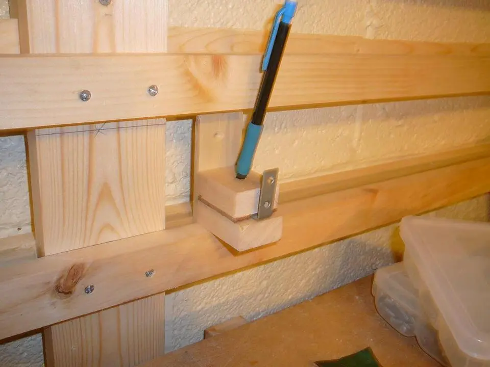

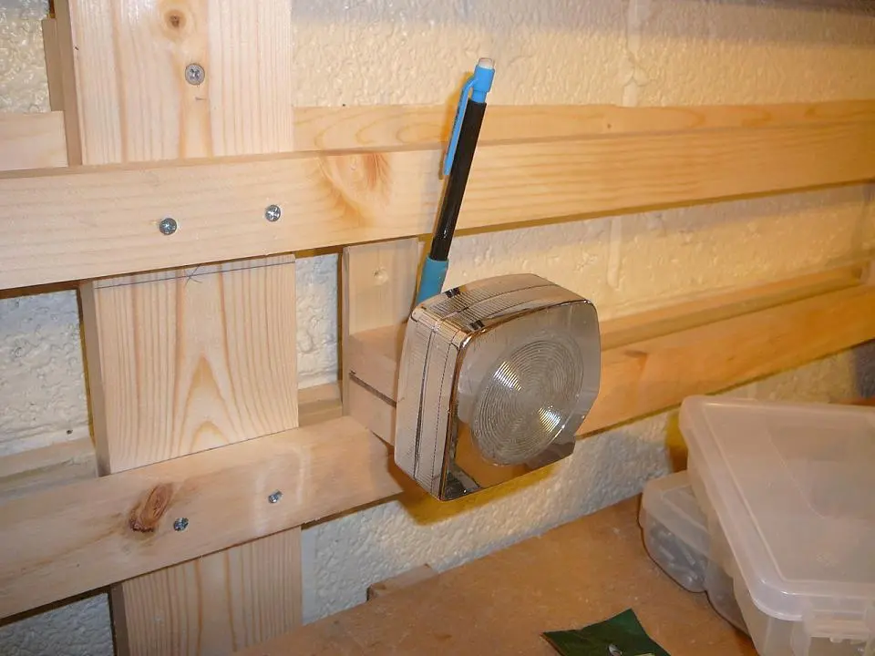

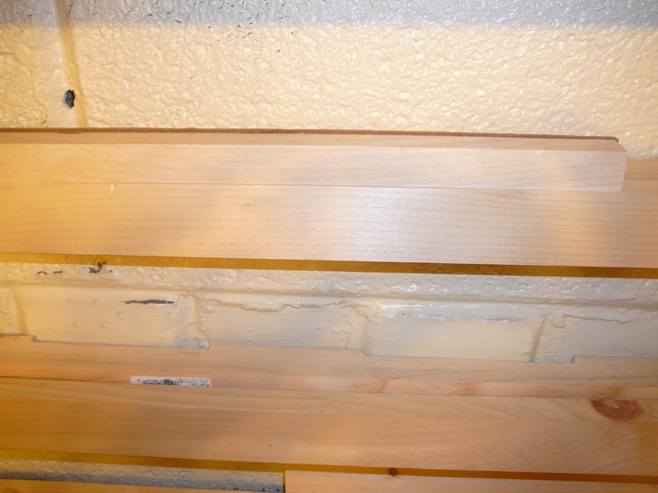

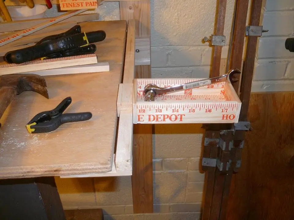

those home depot yardsticks happen to be just the right size for lots of things, and they are very cheap!
i am always using my 7/16 and 10mm wrenches

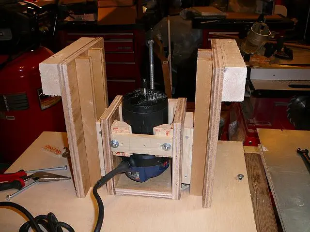

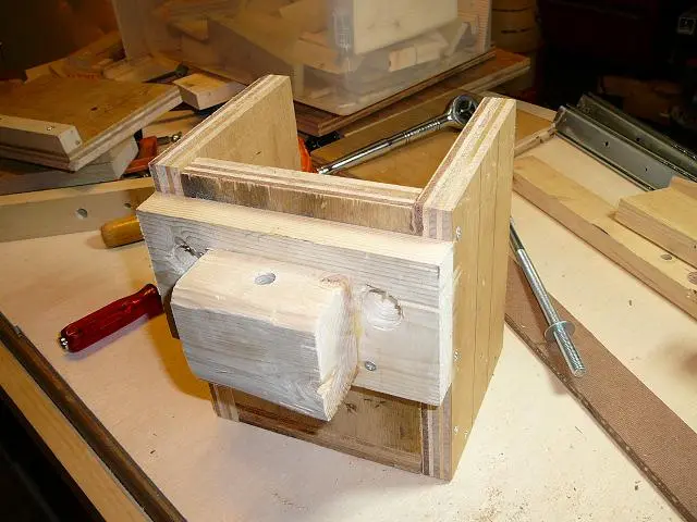

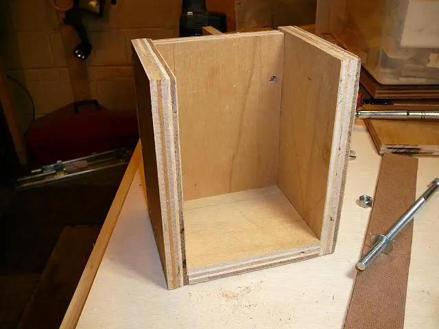

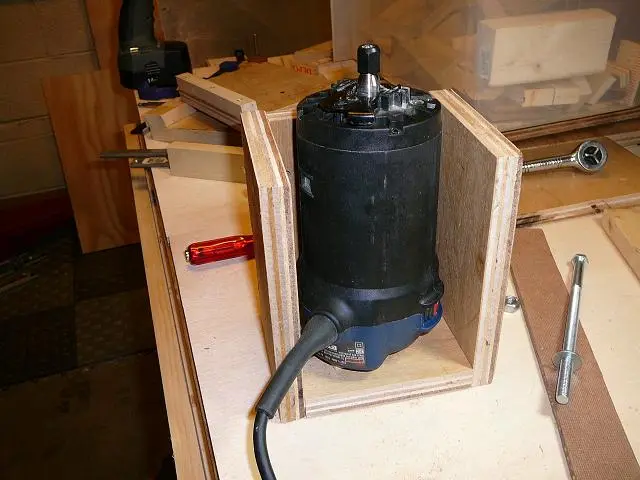

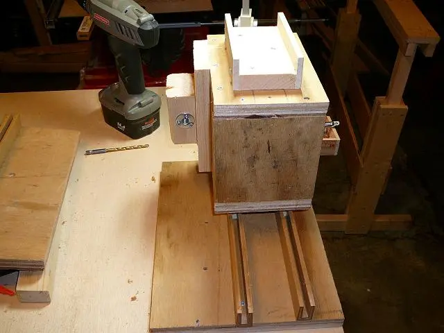

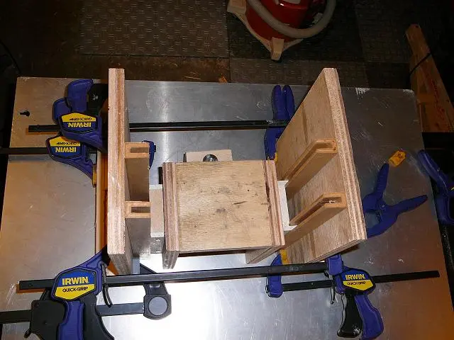

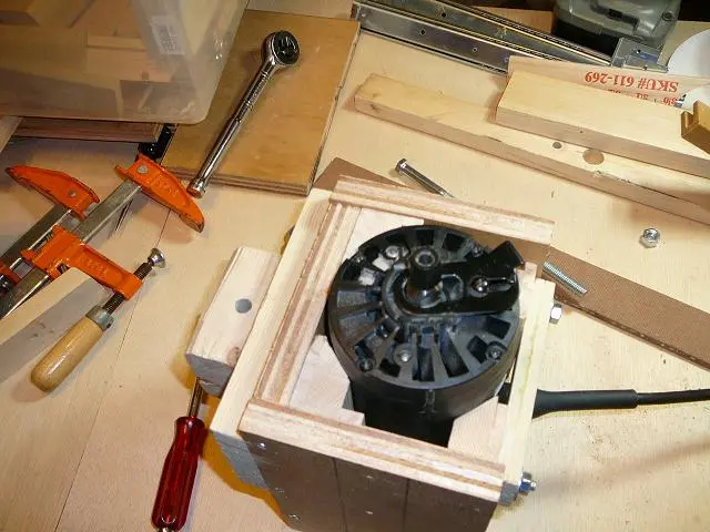

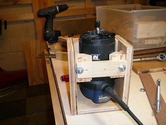

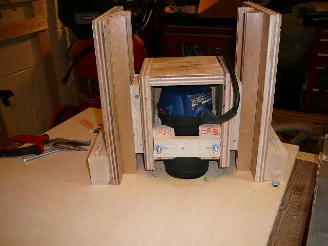

Since you folks are the people who can appreciate a DIY project, I thought I would document my latest project, a drop in top for my workbench that holds and lets me raise and lower my new router. This is (naturally) the least expensive router I could find, and 95% of the parts were in among the clutter already in the garage.

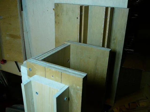

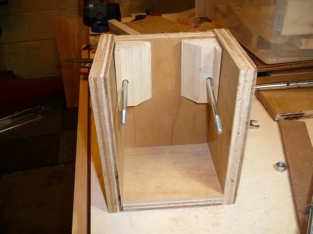

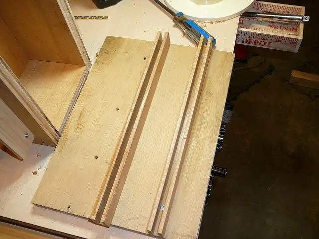

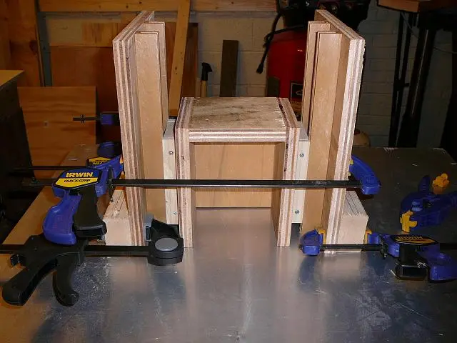

the holder for the router ...

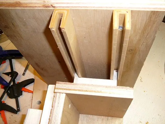

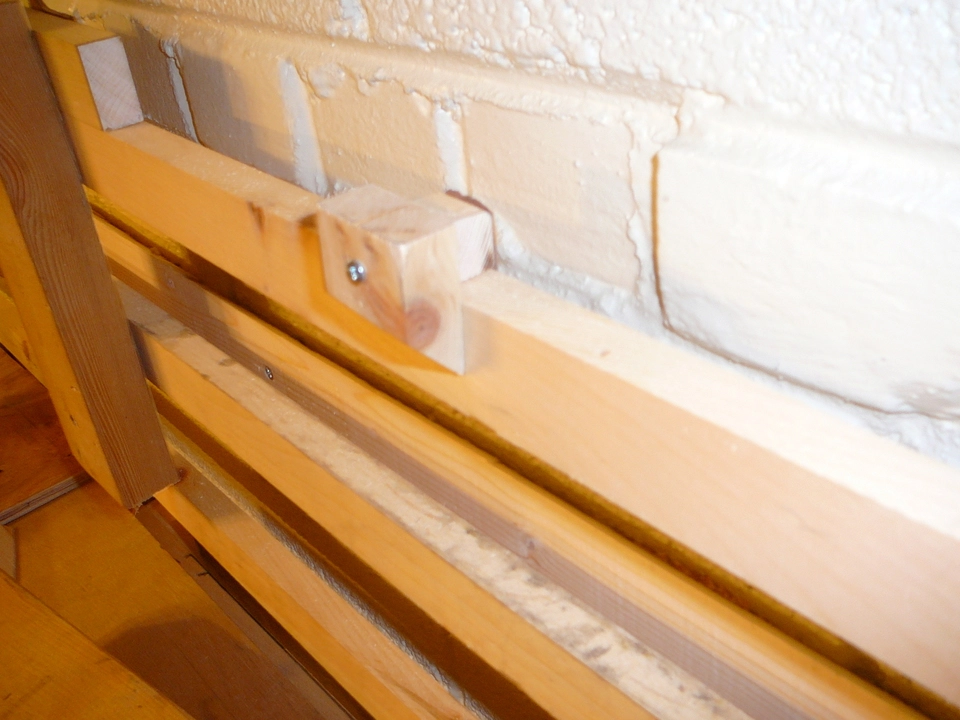

it will slide on 4 tracks. that should keep it firmly in place ...

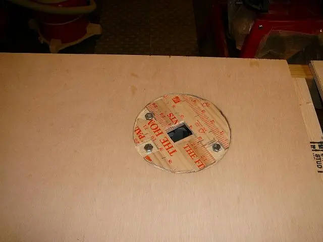

here it is mocked up on the table top into which it is going
A pretty getto insert huh?
now that's some james bond shibby if i ever saw it. now make the work bench shoot poisonous darts if someone disturbs you!
on a more serious note, how are do you turn it on? you could wire in a simple wall switch to the leg of the work bench.

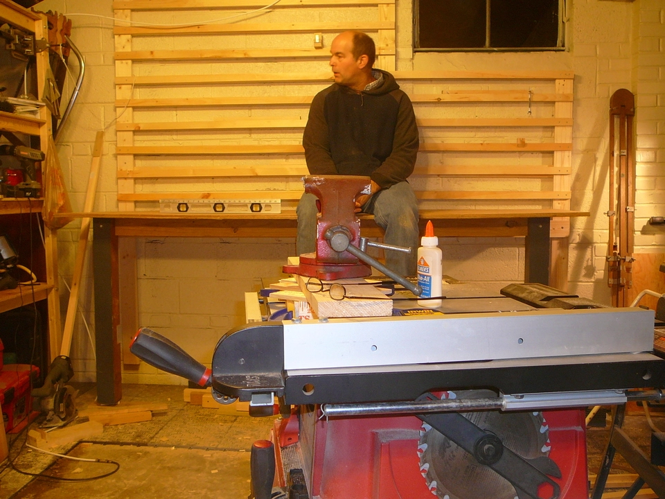

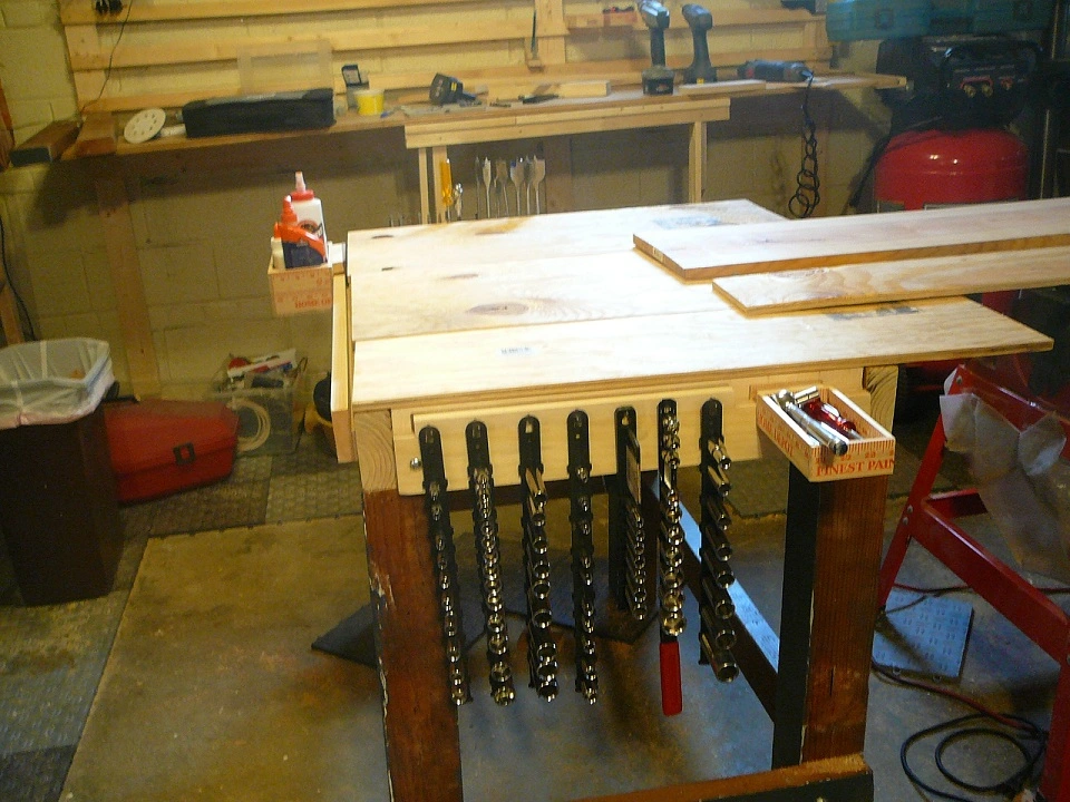

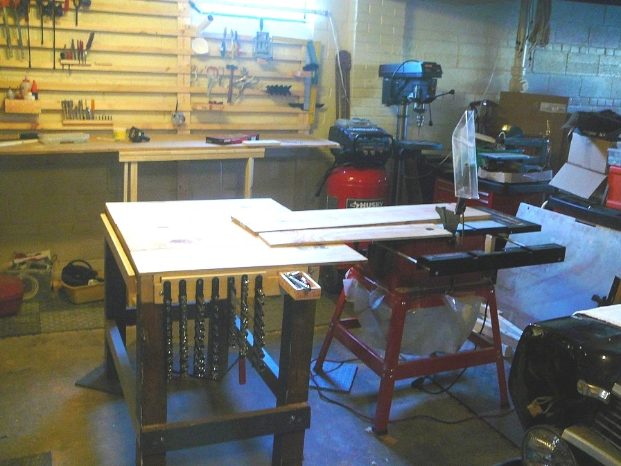

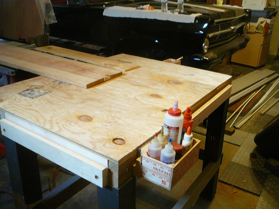

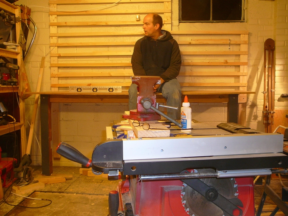

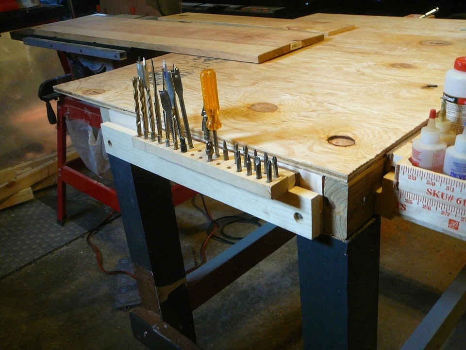

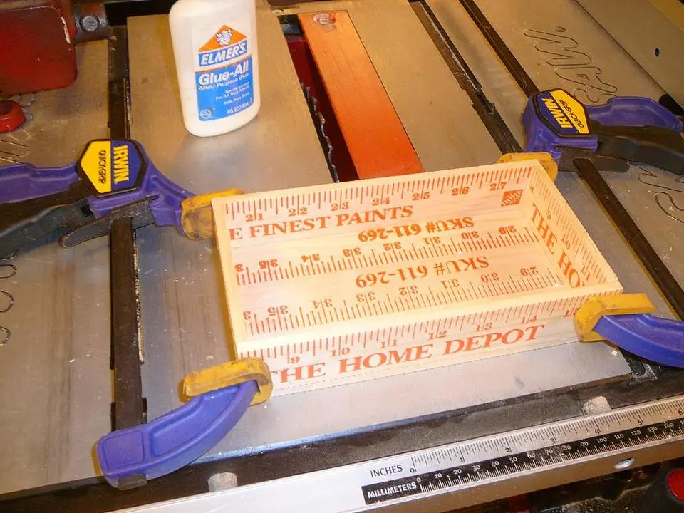

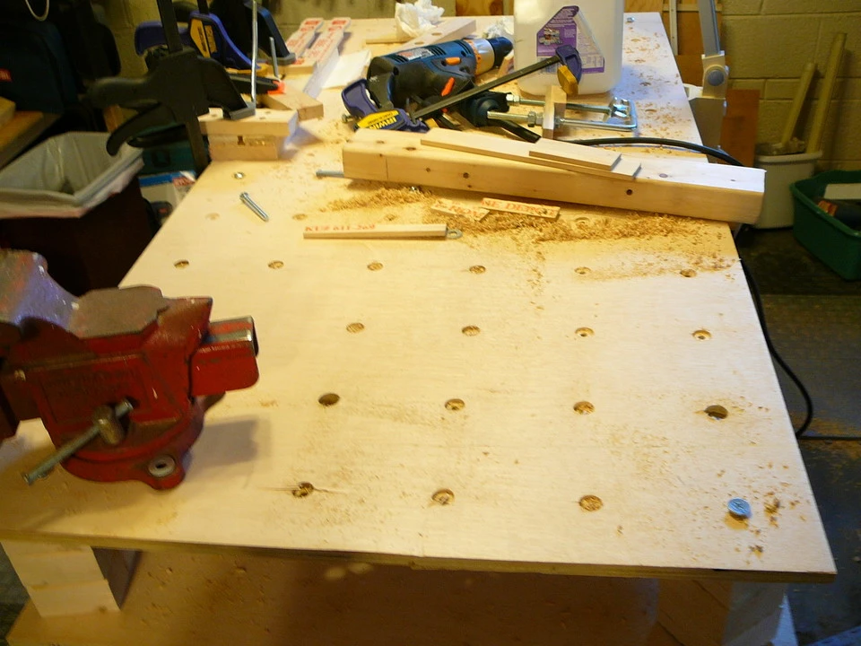

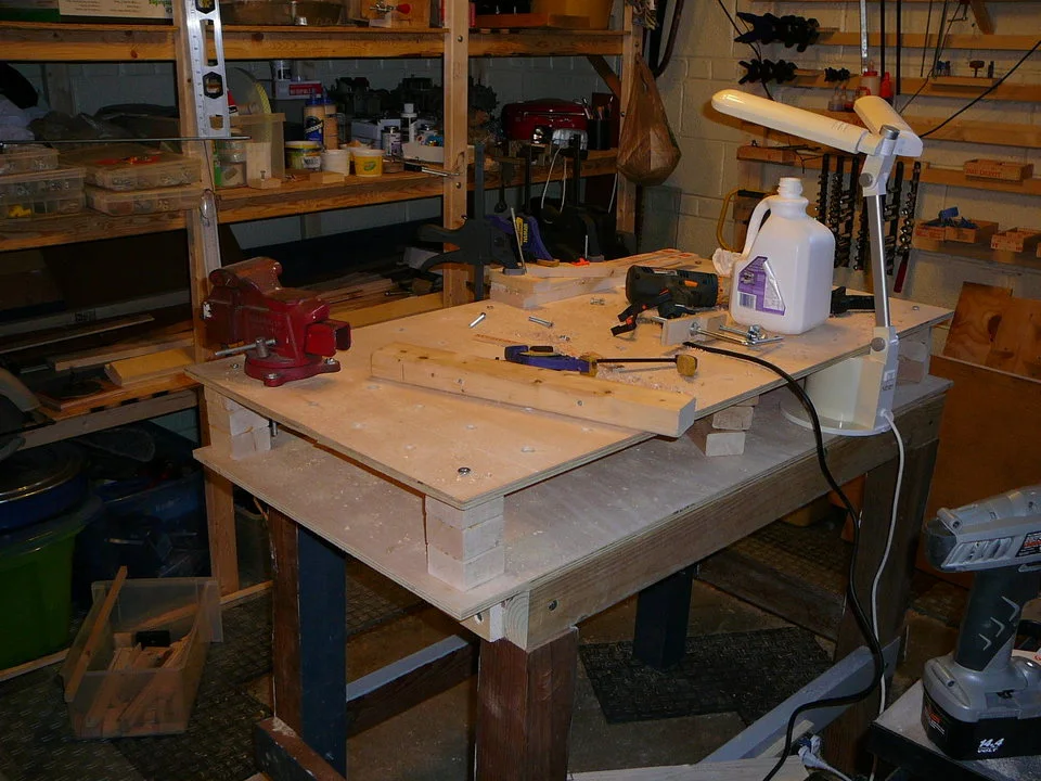

I decided to change my bench top. It is now 2 pieces of 1/2" plywood, has a 4 1/2" open space underneath for tool storage, and 5/8" holes spaced 4" apart for holddown support:
OK, so it's still a work in progress.

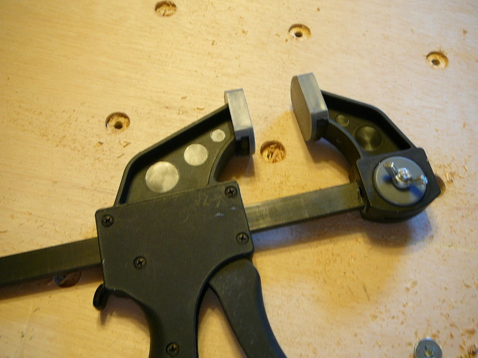

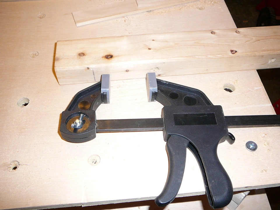

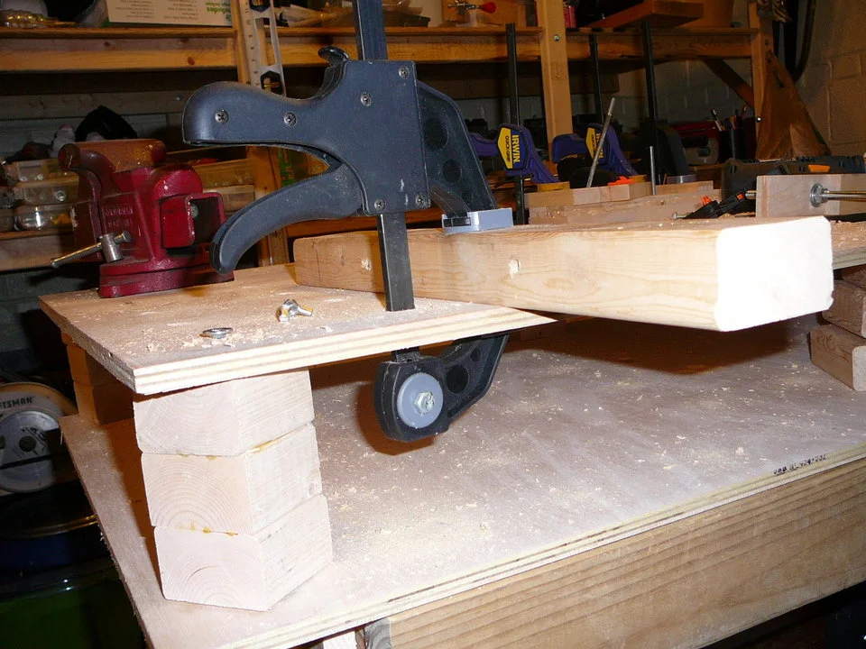

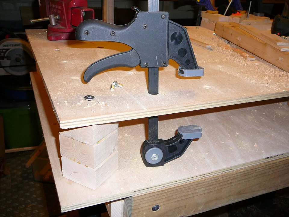

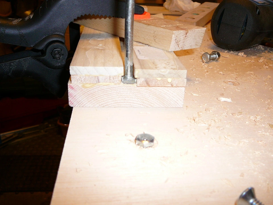

The holes are just big enough for the bar of the cheap quick clamps they sell at Harbor Freight. With this approach, I will be able to secure anything anywhere on the bench:
It turns out that my vise has holes 4" apart, so it bolts up directly:
And it also just so happens that the $2 light I got at the thrift store fits underneath:

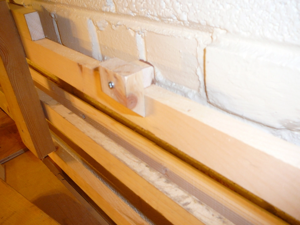

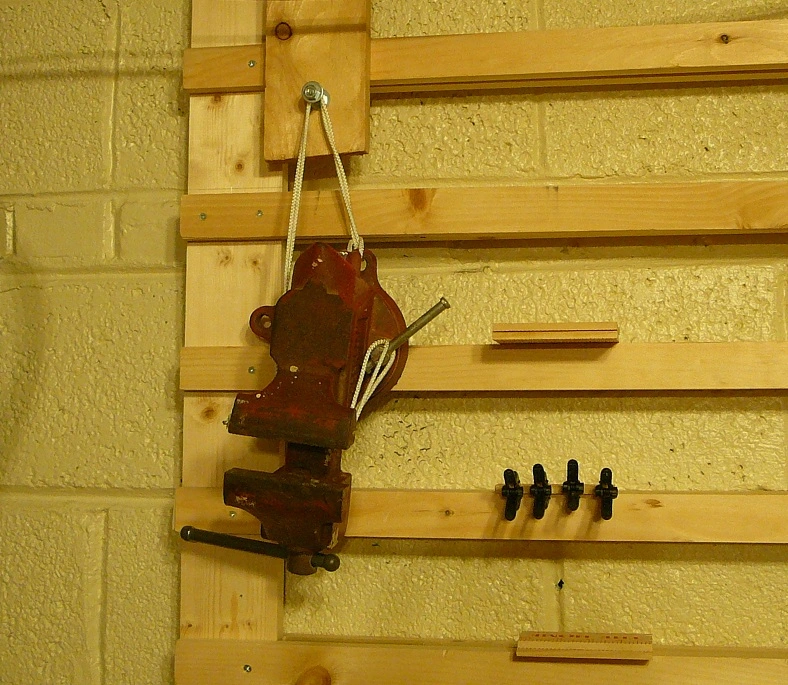

Of course, the cleat and hook thing is still there:

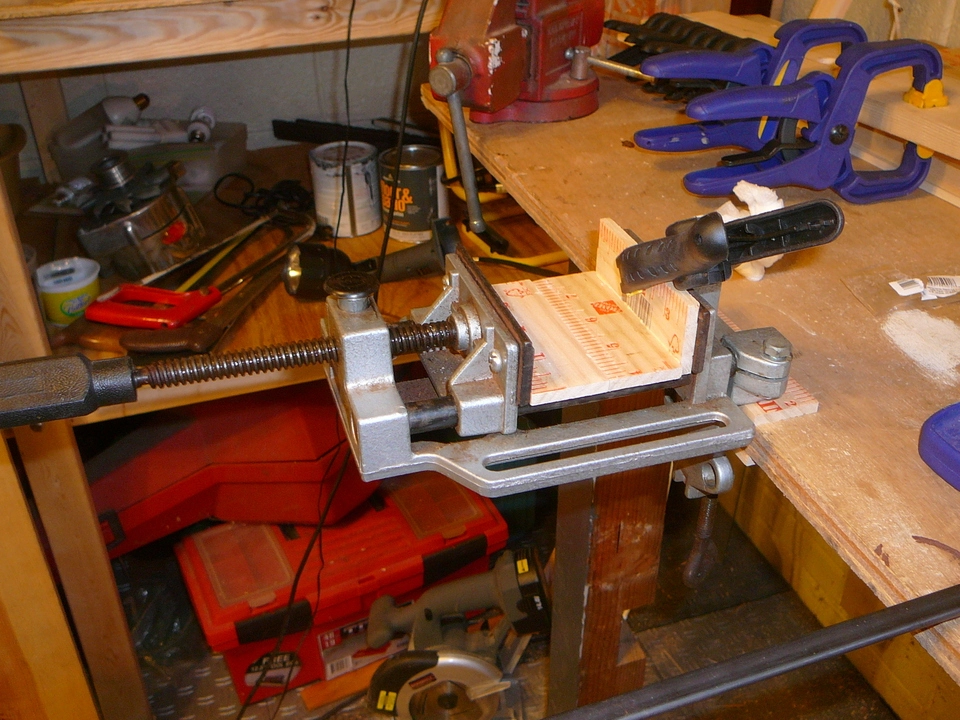

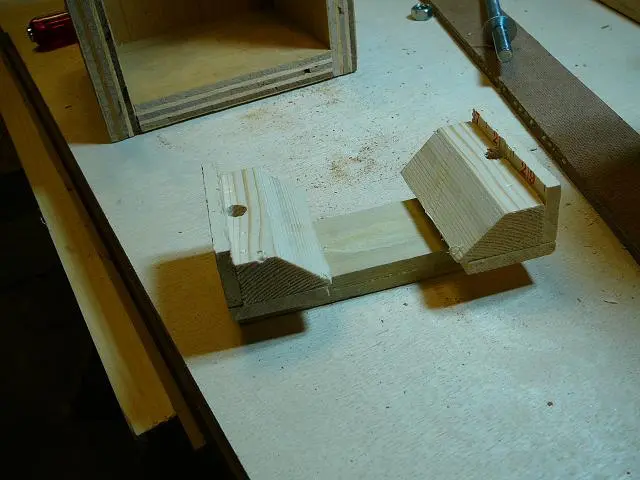

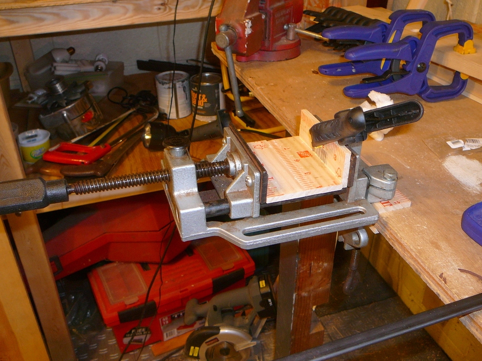

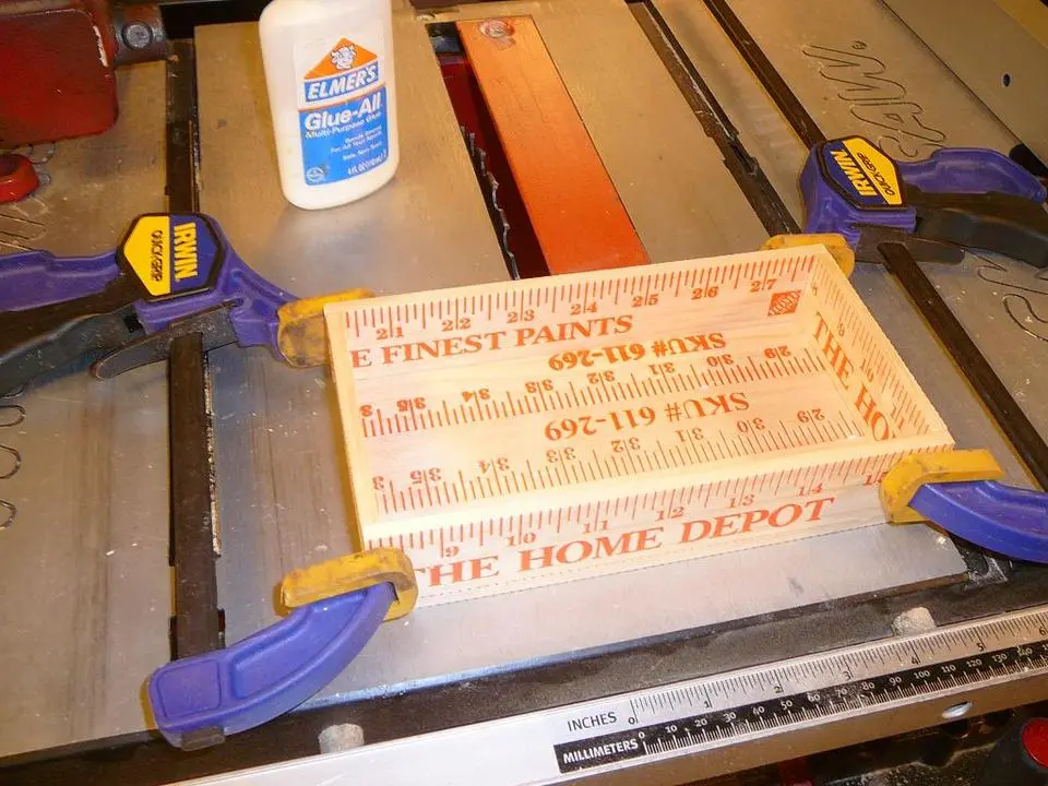

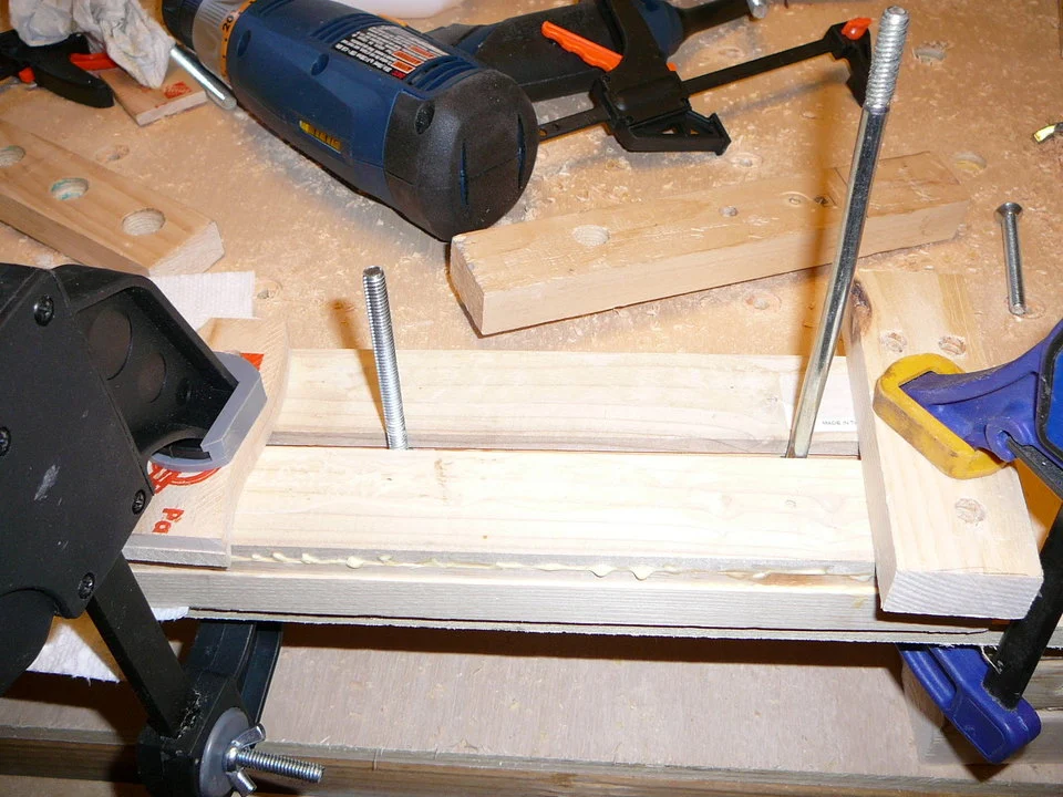

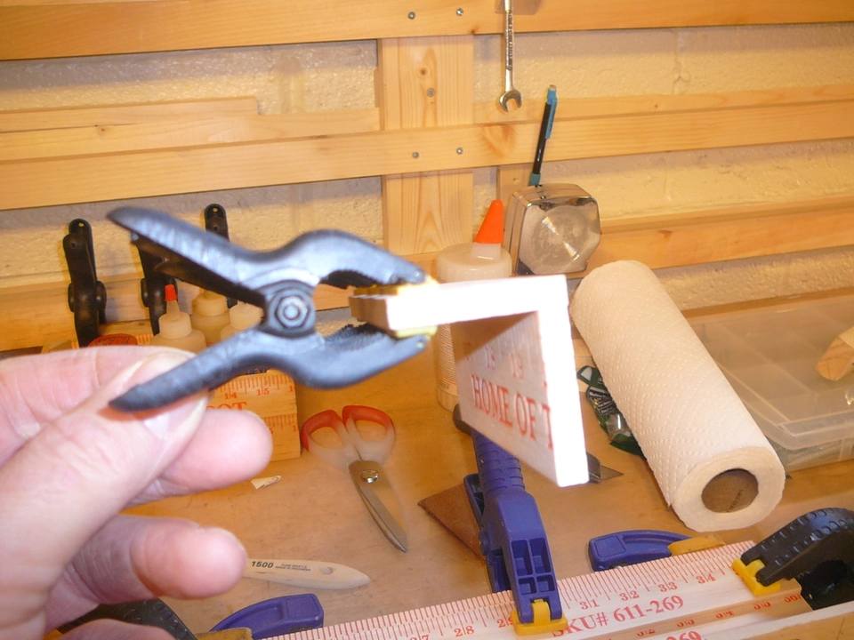

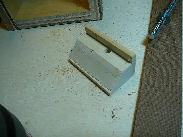

A stupid little ghetto glued up t-track. Maybe I'll attach it to my miter gauge on the table saw :shrug:
