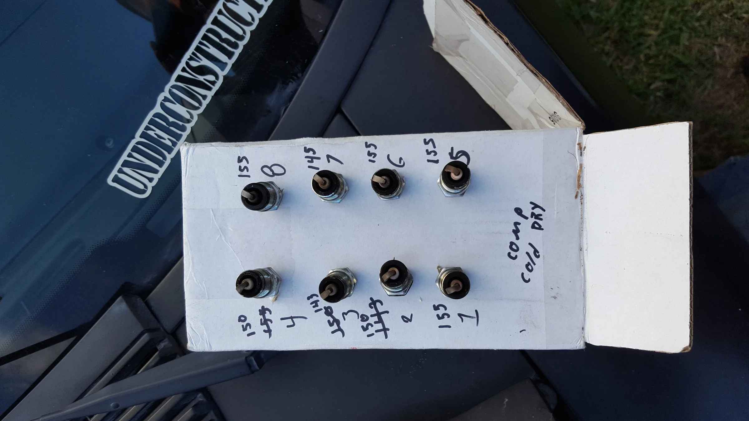

Alright so I got the compression test done and pulled all the plugs and set them out in order in a box for comparison all the plugs look very similar except for number 8 it was wet with oil although I find this suspect because the car does not use any oil, when I had the heads drilled for studs a few of them broke into the intake runner I'm wondering if maybe oil gets down in the cylinder that way while the car is sitting.
Either way the compression test came out beautiful cold and dry all cylinders we're at 150 +/- 5%
So what does everyone think bear with me a few minutes I'm going to attempt to leak down test

Leak down test brought nothing new to light....
Did wet compression test, all cylinders we're within 5% of the dry test......
I'm running very cold plugs, ngk iridium tr5IX this is a gt40 iron headed engine with boost should I run a step hotter? or different plug maybe?
Judging by the plugs I am Uber fat in boost this may be the issue.

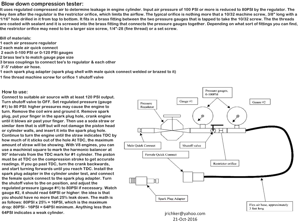

a91what said:
The story is I will have to go rent a leakdown tester. I just verified that I have no valve issues with compressed air. that is all.
Why rent one when you can build one?

a91what said:
Not a single store in 50 miles has a leak down tester for that I can rent. And seeing that I'm not paying $60 for something I'm going to use one time I think I'm just going to put new plugs wires on this thing and let it eat. More than likely the fuel in the oil is being caused by the over Rich tune and the excessive cylinder pressures required to make 400 foot pounds of torque (at the wheels) at 2500 rpm.....
So here's what I think I'm going to do I'm going to switch to a copper plug from these iridium plugs and lean the tune out some. I'm also going to recalibrate the wideband and move it into the other header.
Does anyone have a suggestion as to what plug I should run with around 10 PSI boost. I am not buying $8 each spark plugs again.
It's ben quite some time since I priced the blow down tester parts but I didn't think it would be $60.
The design for the tester comes right out of the FAA AC 43:13-1b page 8-14 for aircraft engines. You may want to reduce the orifice size in my drawing for automotive use.
See https://www.faa.gov/documentLibrary/media/Advisory_Circular/Chapter_08.pdf
