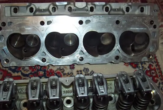

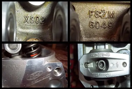

Well i got me some ford racing heads from a guy who knew nothing about them and had them on his car for a short while ,he said they were X303 but it is stamped X302 assembled with 1.7 rockers on these heads? , are they 1.7 , is there away i can check, iv never took apart a head .
f3zm-6049 is on the aluminum head and tryed to serch this # but came up with nothing . Wonder if ford changed they part # on em.
With this set up what would be an ideal cam to go with .
Any help would be fantastic .

here is what I found
M-6049-X302* Bare Head (64cc Chamber)
M-6049-X303* Complete Head (64cc Chamber)
M-6049-X304* Bare Head (58cc Chamber)
M-6049-X305* Complete Head (58cc Chamber)
THE FAST, EASY WAY TO BOLT-ON 65 HORSEPOWER! TRUE BOLT-ON PERFORMANCE
For use on 289/302/351 Windsor-style engines
Improved air flow over original GT-40 aluminum heads
Intake flows approximately 240 cfm at .550" lift (at 28" of H20)
Exhaust flows approximately 170 cfm at .500" lift (at 28" of H20)
Machined for 1.94" Intake and 1.54" exhaust valve diameters
Unlike some aftermarket heads our GT-40 heads use either GT-40 or aftermarket performance: intake manifolds, headers, and valve covers.
Intake port volume 178cc, exhaust port volume 62cc
High temperature exhaust valve seats. Thick deck for improved sealing, increased section thickness in critical areas for porting, and webbed rocker bosses for improved strength. Designed for bolt-on rocker arms, machined for tapered seat spark plug or gasketed. Compatible with Ford Racing intakes, headers, and valve train components. Can be machined for diagonal exhaust header flange mounting.
High quality original equipment style 356-T6 aluminum castings, machining and components
Each aluminum head weighs approximately 22 lbs. – approximately 25 lbs. lighter than each cast iron GT-40 head.
These GT-40 style heads use AGSF-32C spark plugs
Each GT-40X head is leak tested prior to assembly
Head assembly consists of bare head M-6049-X302/X304 and GT-40 valve train kit M-6090-X302 featuring stainless steel valves. The valve springs are compatible with all Ford Racing roller camshafts.
INSTALLATION NOTES:
Will not fit 1986 5.0L with flat-top pistons unless pistons are notched for valve relief
Must use head bolt kit M-6065-D289 to install cylinder heads on 289/302 blocks or head bolt and head gasket kit M-6051-A50 and intake gasket M-9439-A50/A51
Check rocker arm clearance to valve springs with production rocker arms
Check your intake manifold for port match, not all intakes are compatible due to the tall high-flow ports
Must use M-9439-A50 intake gasket

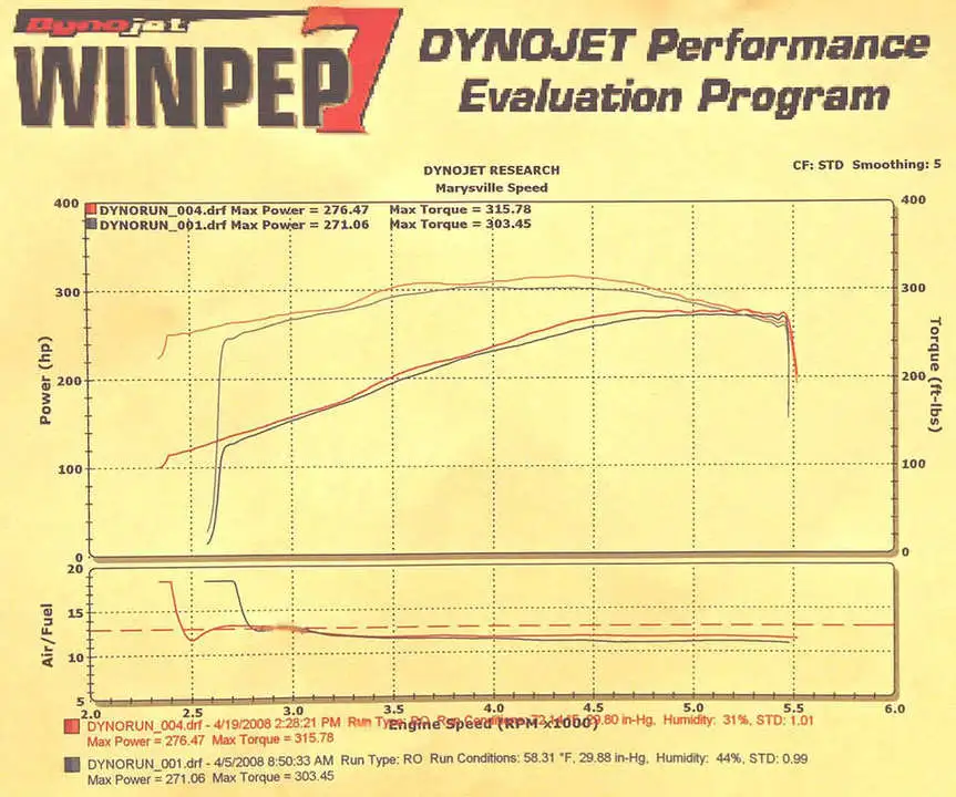

I'm running a very similar set-up to what you're looking at. Click the "my mod list" link in my signature for details. The dyno sheet below shows the difference between an unported Cobra manifold and a Tmoss-ported GT40 tubular intake on my car.
Thanks for that withors , thats quite a difference in the torque range form a port job. Im definetely going with an ecam but am unsure if ill have the dredded clearence . Im sure i will cause i see alot of others going with this combo but with 1.7rr , i guess its always good to check that anyways.
