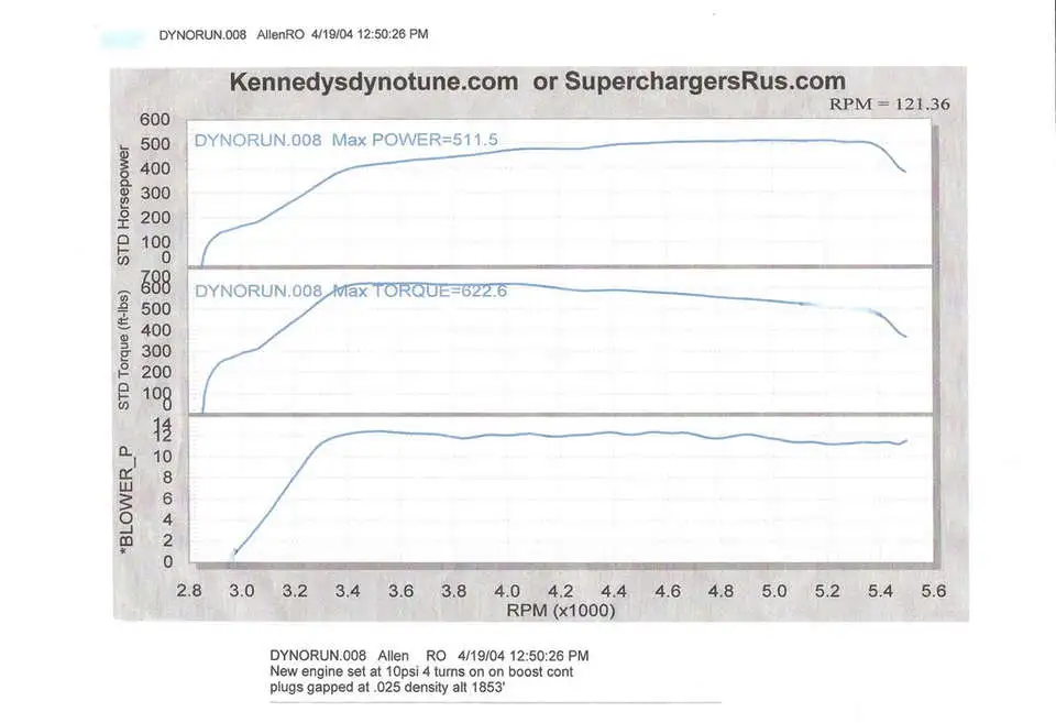

I have that kit and been running it for 4 years. I started off with a stock block with 30K miles, broke it on the dyno first pull, but it was because we had the boost controller set wrong and it spiked 17lbs. After the new motor @ 10lbs. of boost we drove through a king cobra clutch on the dyno, I put in a Spec stage 3 plus that lasted about 5K miles, the stock T5 lasted about 5K miles the rearend was on a one wheel peel after about 5K miles. I went with the larger oil pan and windage tray. One VERY important thing to get is an Aeromotive air/fuel meter(it is very accurate) please do yourself a favor. If you set the thing up like HP tells you timing locked out @20 degrees and you know where you are on the boost controller and tour air fuel ratio you'll be alright. I wouldn't run more than 10lbs. boost. I went with the exhaust HP recommended which is Mac, normally I would never have bought Mac but I am glad I did. The guy that i dynoed with is one of the largest installer of Kenne Bell's in the U.S. and he was blown away with what we made for power. He claims the best he can do with the Bell is 14-16 rwhp/lb. of boost and we made 25rwhp./lb.of boost with that turbo. If you have any questions just P.M. me. Oh yea my #'s were made with the DSS 331 super pro bullet level 20 race prep block stock GT 40 heads and stock Cobra intake, I have since switched to Hogan upper and Trick-Flow lower, haven't been back to the dyno yet but I can feel the difference. Oh yea I'm running the 3.55 gear and that seems good, it spools up fine. Good Luck,Terry.
