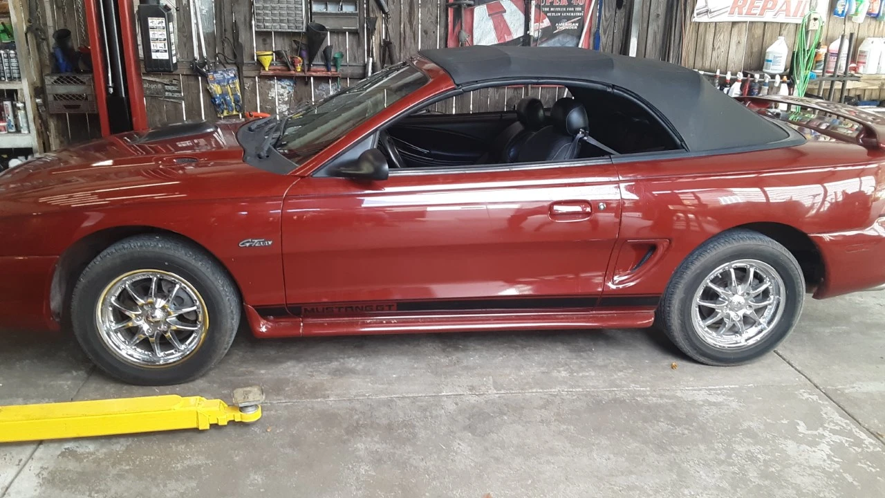

The wheels were corroded and the tires were 12 years old, so they had to go. I found a set of 2018 Mustang wheels and tires.

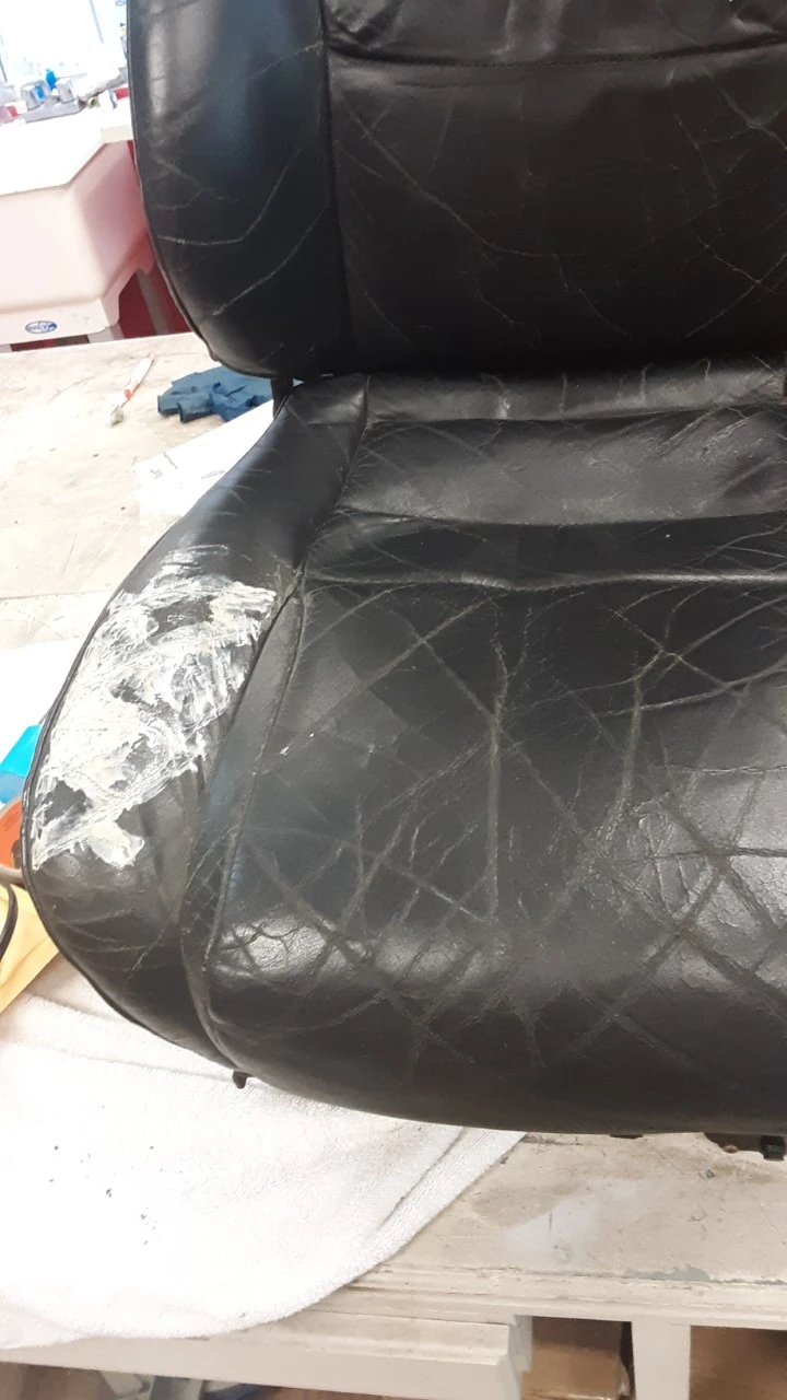

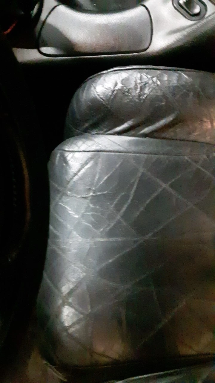

I next went after the front leather seats that were showing cracks and much wear.
I bought restoration supplies from 'The Seat Doctor" to repair them. 1st I used seat crack filler and dye to make the open cracks less noticeable.

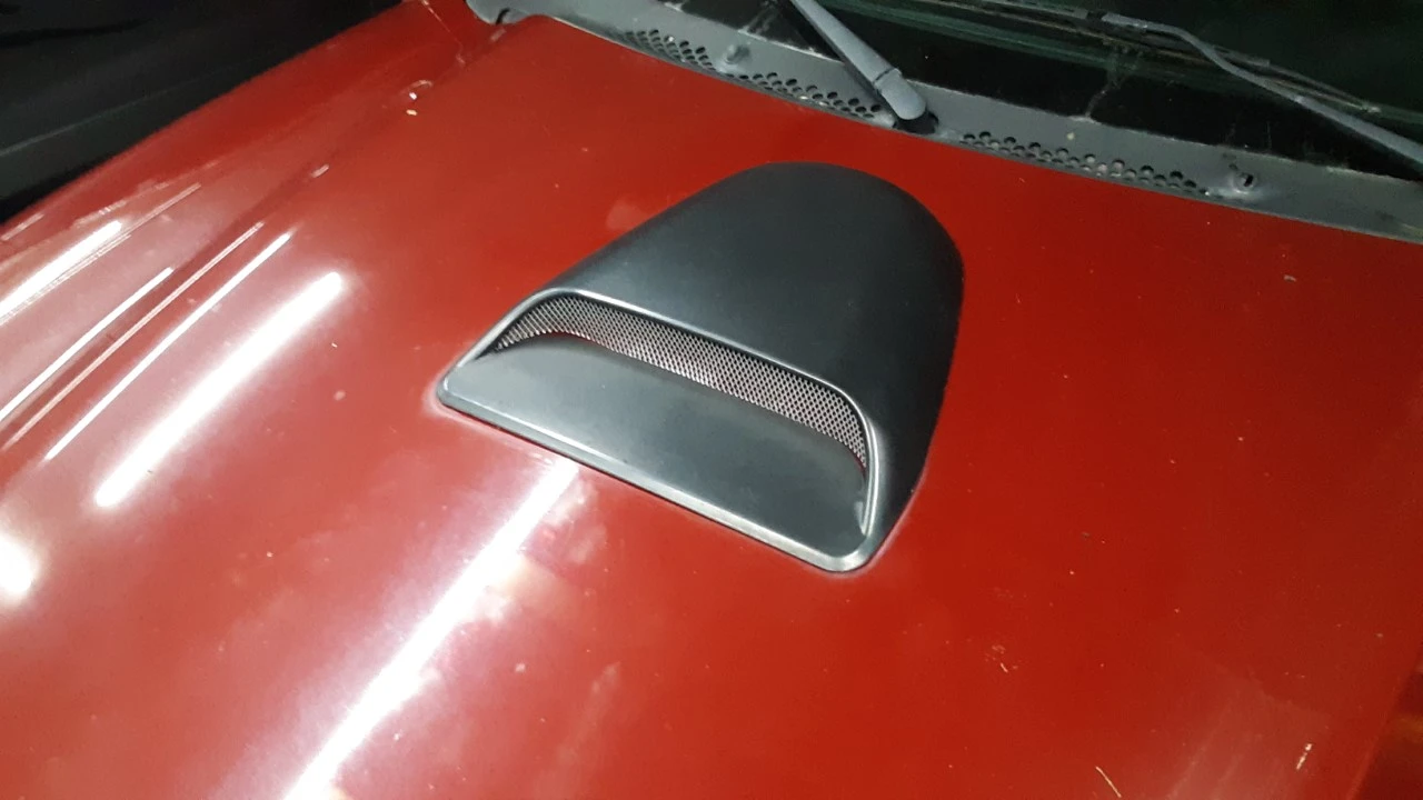

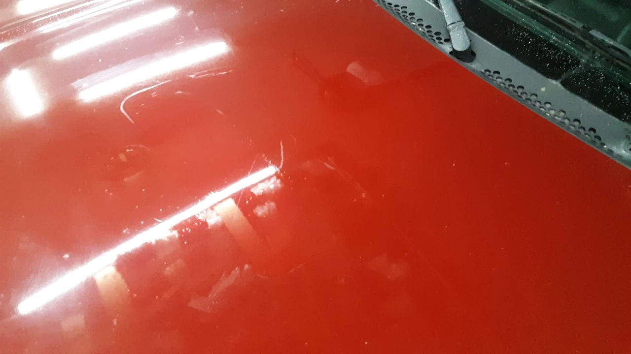

I then removed the plastic hood scoop, and cleaned up the hood.
The hood still needs a little more work.

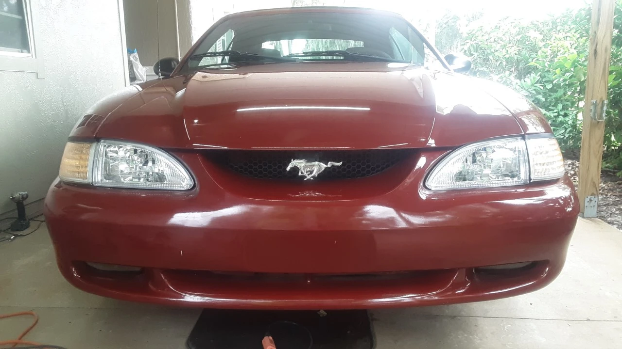

I've put new headlights and turn signals one it.
I had to replace the headlight switch, and the idle air valve. I also replaced the gas filler tube seal to the tank.

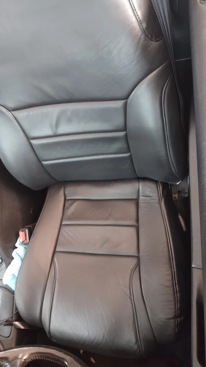

Update on the seats. I put my elbow through the back of the drivers seat while searching for my phone that fell to the floor under my feet. I had to get out and then on my knees to reach it. In doing so I leaned with my elbow against the seat back. RIIIIIP went the leather.
Anyway I found a seller on Ebay that had a leather replacement for both front seats. They fit well and look good.
I was able to reuse the foam buns by carefully cutting the old covers that were glued to them.
