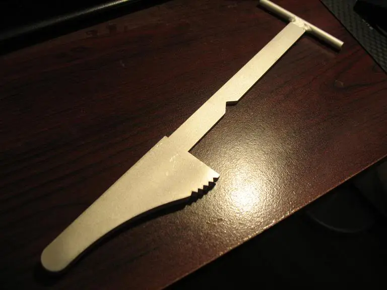

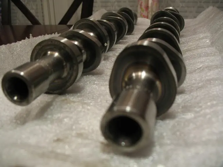

Cam Retention tool:nice:

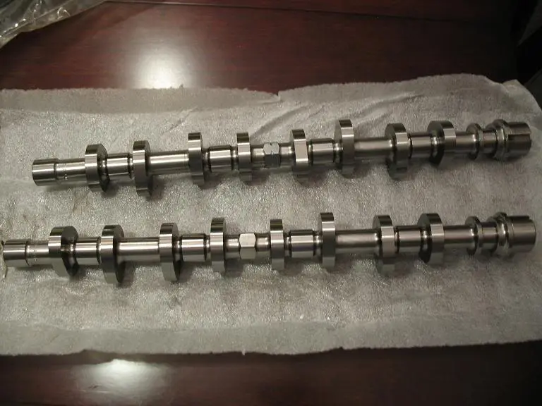

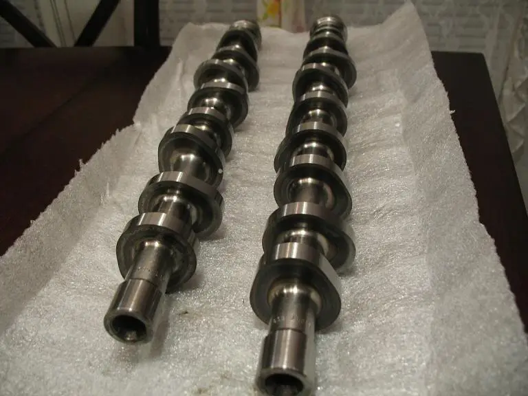

VT NA Stage 1 cams:D I was lucky to get the last 2 in stock:p 535$ and 12 hours of driving later(Montreal to Virginia):p
I'm getting ready to install the cams this weekend, got everything ready parts, tools and tune.
The only question I have now, the cams are marked left and right. Which goes where?(Passenger side and Driver side)

hotmustang331 said:
Ditch that cam tool. Just use vice grips and have someone hold the cam gears up, keeping PLENTY of tention on the chains....trust me.
But congrats on your purchase! You definatly wont regret it! :nice:
Yes, I read you whole DIY on cam install:p
hotmustang331 said:
You will be sorry if you use that tool :D. Dont say I didnt warn you when the gear slips off and you must pull the whole front of the engine down :lol:

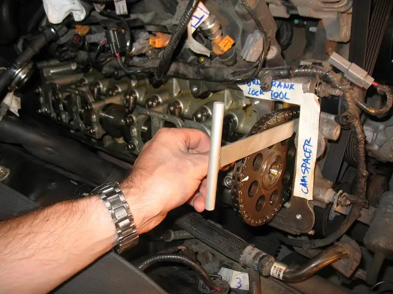

I've read other DIY on cam install using the the cam retention tool too(here and other forums, MMFF, etc...). A common mistake is not to crank the motor to lock the tool into place.
Plus, I will have my friend there to put pressure on the tool and pull on the cam gear to be sure the chain won't slip.
Wish me luck:p
Good luck! LOL
We didnt do that either that I recal :shrug: . Another guy on here tried to use the anderson tool...but soon realized how unstable it was, and use the vice grips :D
Let me know if it works for you though. :nice:

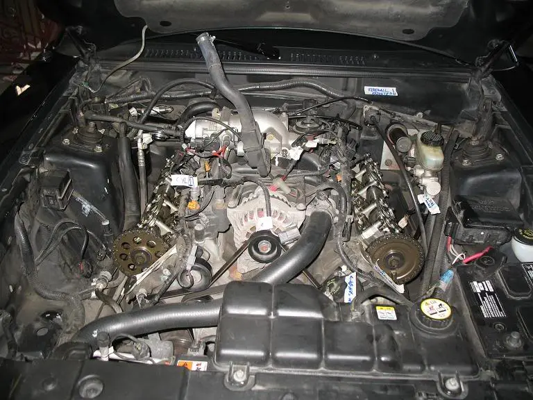

UPDATE 1H30 later : driver side valve cover off:p Yes it's hard, but you don't need to take out your firewall adjuster. What I did was pull the valve cover up as much as possible, then pull towards the front of the engine and shake and wiggle it like crazy!:nice: And it just comes out:p
2H00, passenger cover is out but man was it hard to get to the lower bolts behind the A/C lines.
Done for tonight, tomorrow my friend is coming over to help me swap the cams.

As long as someone helps hold the retentioner tool it will stay in place. Make sure to insert it then turn the crank a little to lock it down. Then you are all good.

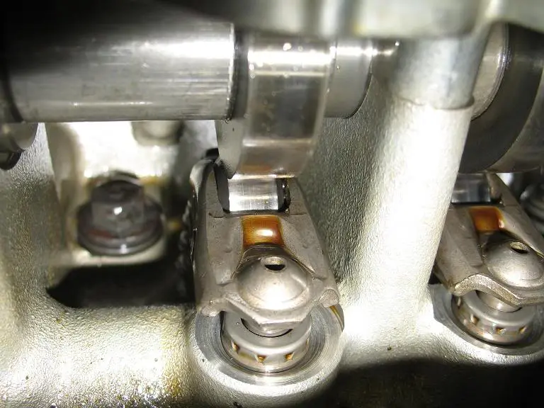

Keep track of the rockers...they will fall off into the head so you want to make sure you have them all in place once you get the cams in position to bolt in.
Also make sure you hold onto the cam washer and don't let it drop into the oil pan.:(

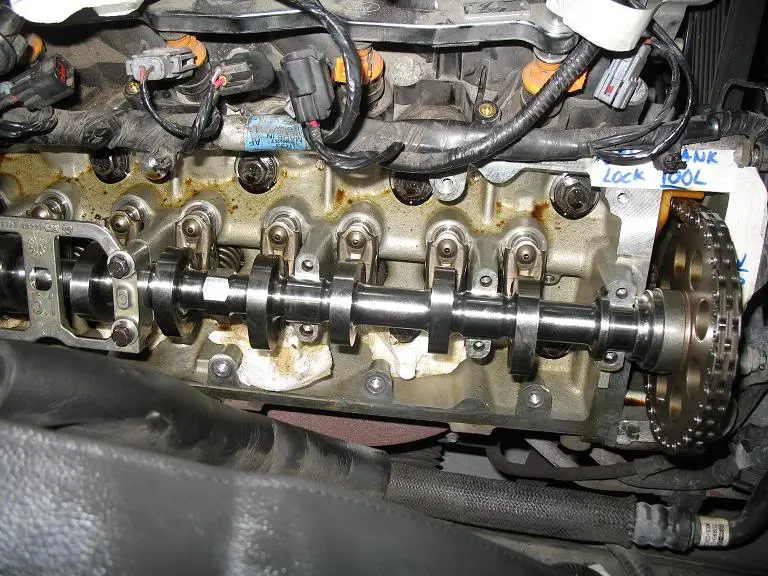

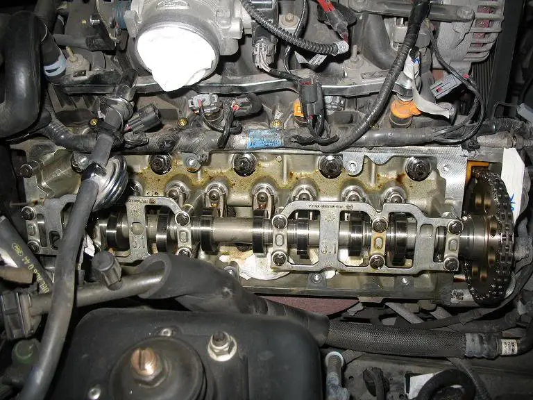

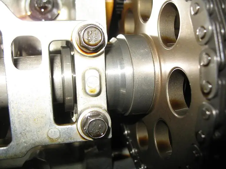

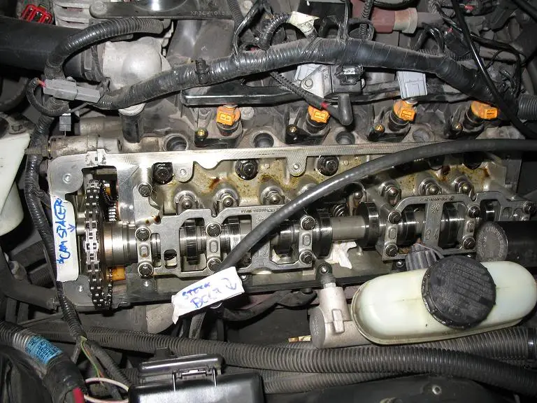

Update with pictures
Passenger side
Driver side
My dirty engine

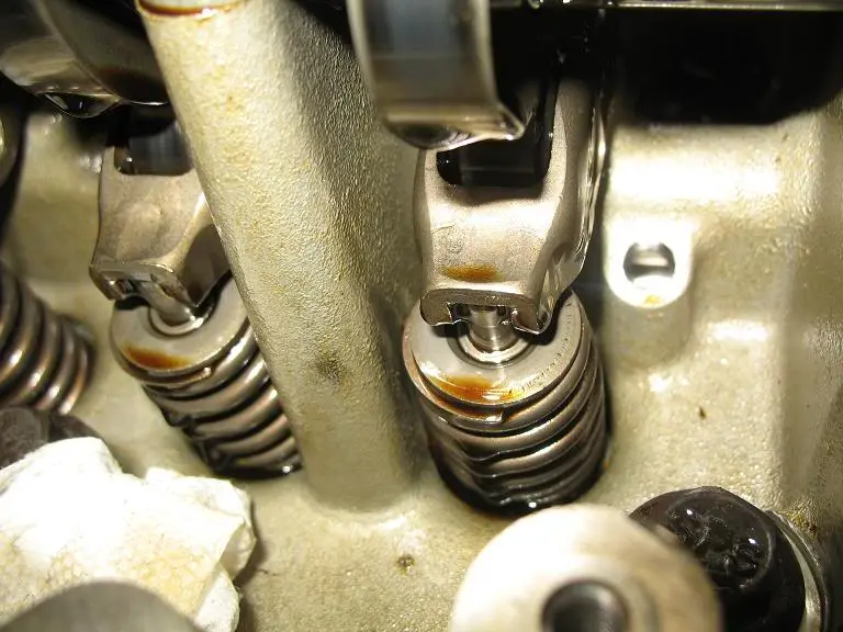

Close up of rocker and lash adjuster
Close up of rocker and valve spring
Cam spacer, very important to hold on to it while removing. Many people have dropped it into the oil pan.
Cam retention tool locked in
Done under 1 hour for passenger side.
Lesson of the day. READ THE DAMN INSTRUCTIONS PROPERLY. It's not LBS-FT but LBS-INCH:bang: for the cam cap bolts:bang: :bang: :bang: I feel stupid now.:nonono:
