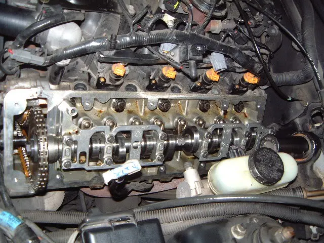

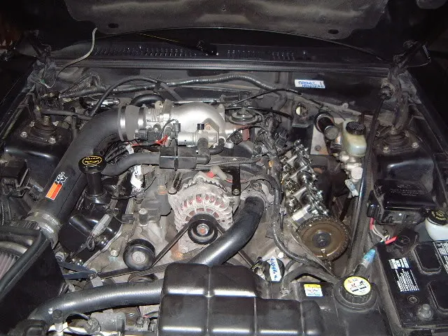

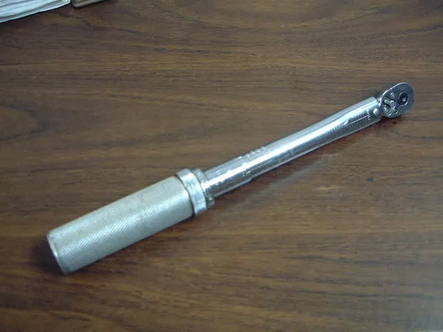

Found the proper tool, INCH-LBS torque wrench
Everything is done except driver side
new cam in and only one bolt missing halting this whole project.

Awsome! Glad the anderson tool actually worked for you lol! Any close calls with it?
Anyways, I hope you didnt tighten those main caps too tight on the pass side....I have heard that they can be overtightened and will basically lock the cams up.
You have taken a wrench to your crank pully and rotated the engine over a few times right?

SUCCESS!
It started! More to come tonight!

The books says 71-106 inch-lbs, I torqued them to 85inch-lbs. And yes, I did check for clearance and all.
