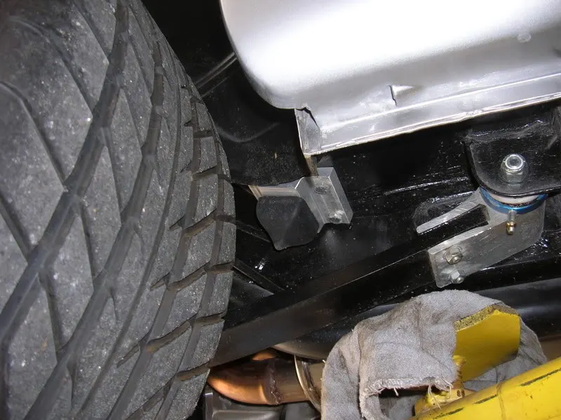

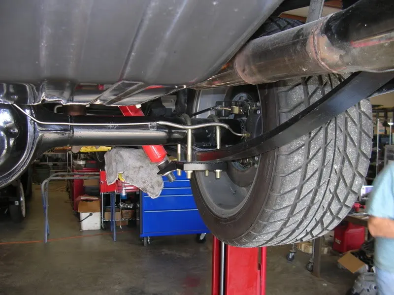

Why not take a look at these springs, Flex a form I am going to be installing a set of these in my car, there is a long thread on Corner Carver and those that have them are very happy with the product.

I recommend the Flex-a-Forms. Great ride, no wheel hop, and they look cool too.

Got to admit though, those flex a forms are looking pretty sweet.
