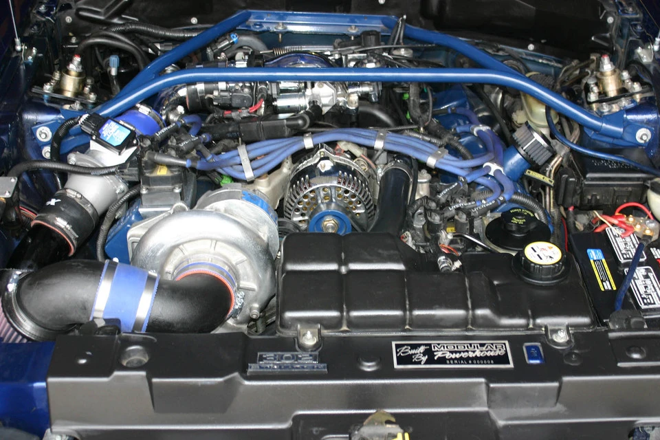

I know the powerpipe is a tight fit...just take 2 90 degree elbows and put a filter on the end...you need something there for a filter:

i like it
