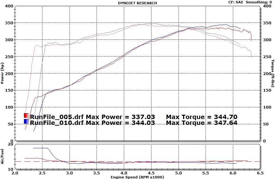

Honestly I dont know who told you that was a good combo but their an idiot. That combo will not make crap for power. My 351 is a very mild built 351 and I'm at the threshold of 1 HP per cubic inch at the rear wheels and mine needs bigger heads.

I have an actual 95R Engine in mine and Im making almost 100 more at the wheels then it was stock and that was with a pretty mild 351 set up on mine. I could have done a more radical cam, I could have bumped the compression exc exc... but I like where it is and w/ the addition of some 205cc heads next year I think I'll be looking a 1HP per cubic inch at the wheel which IMO is very nice N/A
