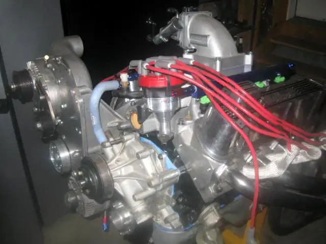

Does anyone have a pic of an engine equipped with a SC without the AC? I want to see what the belt routing looks like. It seems like the belt routing would be an issue because the alt gets relocated below the smog pump.
Here's a pic:

Lemme look and see if i have any good pics of it and ill send you some.
