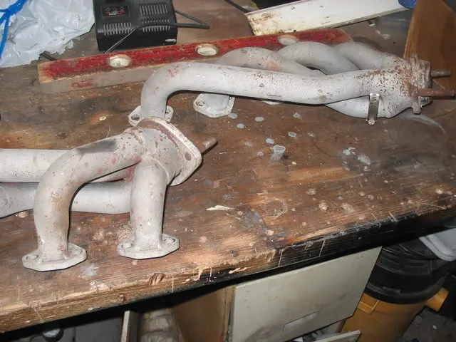

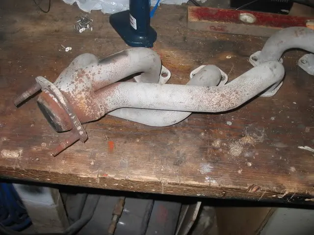

picked up some headers for cheap today ill put em in tuesday, ill get a vid up.
a little rusty because they have been sitting around in his garage since 2000
the guy i bought them from had a kenny bell 04 cobra, 06 gto and a 87 GT mild H/C/I...
cool guy none the less, says he has some other performance parts laying around that he can sell me for dirt cheap as he is moving sometime soon.

Those look like mac's, I have those. If you want to, spray them with some high temp header paint from the Zone it actually works. I hope you have the bolts because the stock ones are too big, you can get some from the Zone too, unfortunatally its a chevy 12 pack :nonono: fords need 16 so you have to get 2.

high temp paint, ya thought of it but its 30* and it wont stick for crap.
yeah there MAC got em for 50 bucks.
really? stock header bolts are to big? thats ****ty...thanks for the fyi i would of got them off and been like wtf.
so you say i need to get different header bolts? happen to have a part number.

I dont remember the part # but its the spectre brand that you should find in the performance isle on the floor, they're gold colored bolts with a little socket hex wrench and are the only ones they sell.
just ask around some shops may stock them. they are 3/8 X 16 thread...I would go with some that are 1 inch long the ones that came with my BBK were 3/4 of an inch and they are a little short but they still work fine. Just make sure you check them after the first few heat and cool cycles and maby every few days after that for a few times then they should be good. I keep a 3/8 wrench in my car lol.
