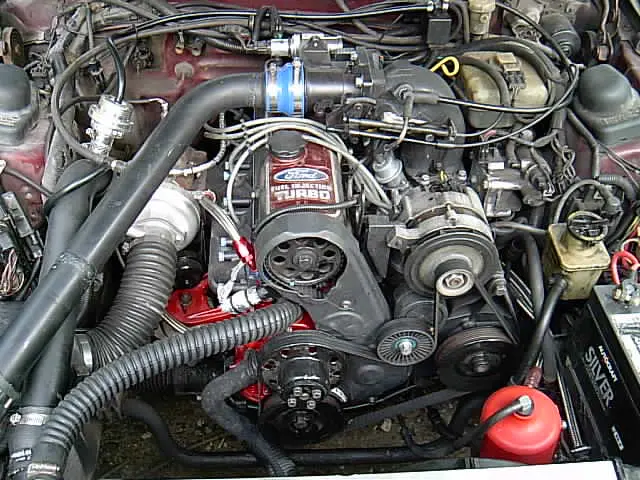

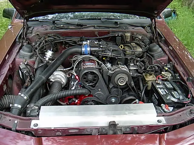

Ok ok...I just ran out and took a couple pics. Also found a small puddle of coolant on the ground. I cannot get the damn thermostat housing on this thing to seal :fuss: Guess I'll have to get the coolant level much lower than the head and try it again, that must be my problem.
same problem I had with the temporary engine in my 88. damn thing leaked no matter what I did. oh well, I yanked that head off anyway.
how pitted is the housing where the heater hose attaches??
Well, what the problem has been is that I modified my thermostat housing, and it was sealed up good at first but I had to pull it off to fix something else, and every time I took it off there was just a little bit of coolant on the gasket surface (on the head) near the bottom when I reinstalled it, and I'm fairly sure this is what was allowing it to leak. So last night I drained the coolant down and made sure it was well below the thermostat hole, and wiped the surfaces down with mineral spirits. I hope this gets it.

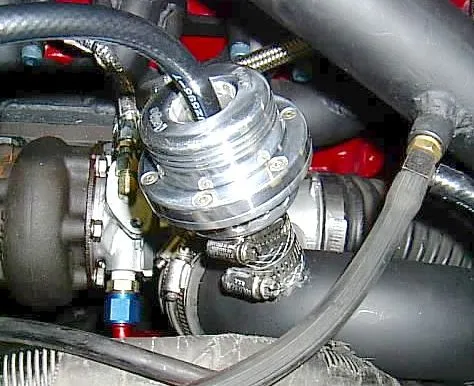

Ash: Here ya go. I just welded a little piece of 1" pipe to my IC pipe, and I have the BOV clamped to that.
attachment.php
