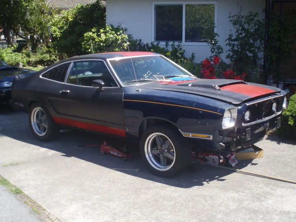

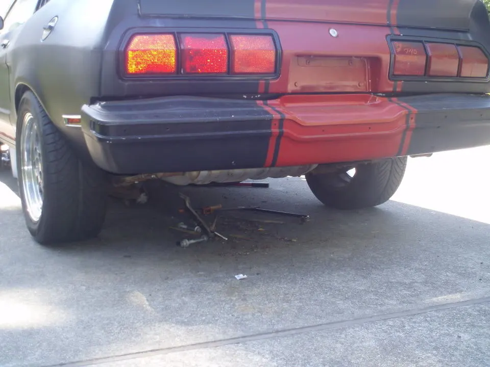

for my 5 lug conversion I used some 4-5 lug adapters with a 2" increase in spacing so i can run newer wheels. I found these 16" Saleen 5 lug 5 spokes on craigslist for $200, with those tires. talk about a steal!
so the front wheel adapters when on with no trouble, but the rears were a bit too long. the outer part of the adapter wouldnt bolt on flush. luckily theres that buffer zone where there isn't any thread so some quality time with Mr. Angle Grinder fixed that right up
and I know none of you read any of that because you want pictures, so here they are

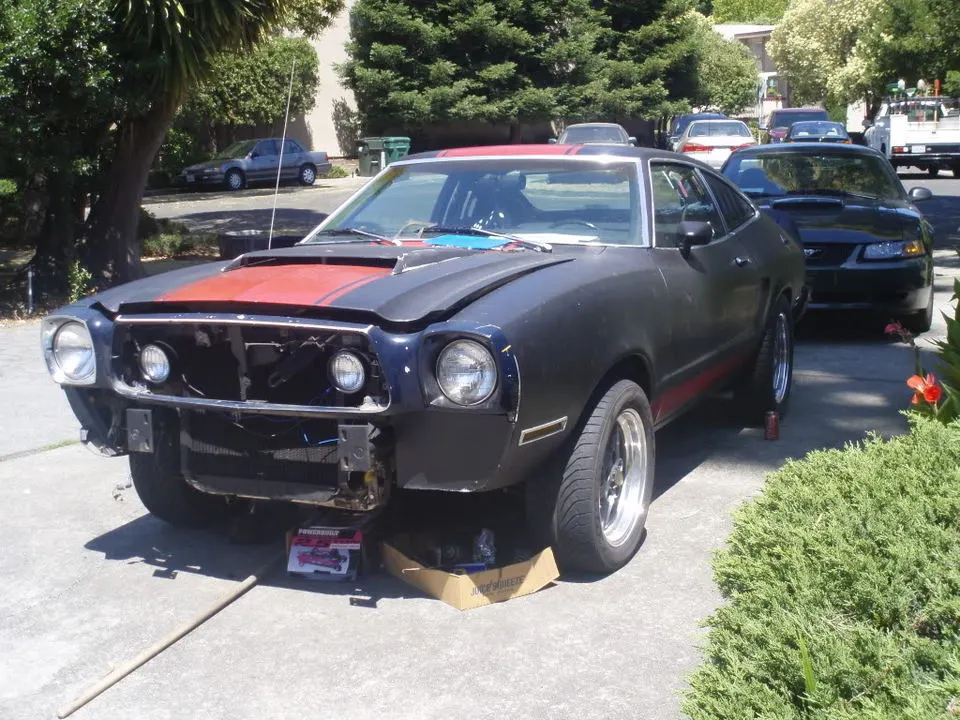

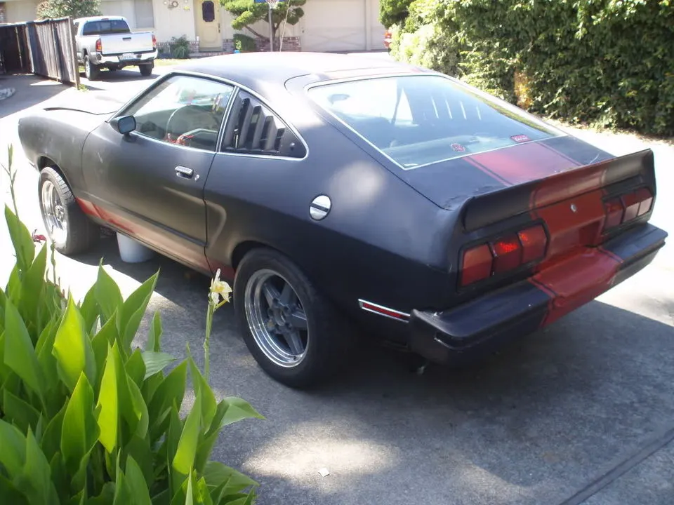

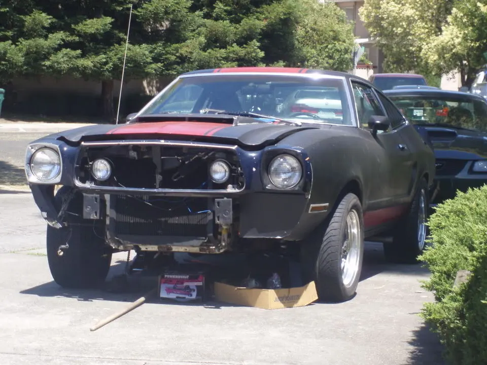

Nose looks a little high doesn't it? The stiffer springs sure are showing. i also tried pushing down on them and they hardly budge. the old ones would go down and pop back up, but these... they kinda twitch just enough to remind you there is suspension and its not all fixed but thats it. no bouncing here
I know some folks running the 452lb springs cut a coil, i may eventually do that too..

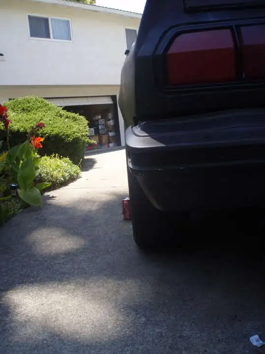

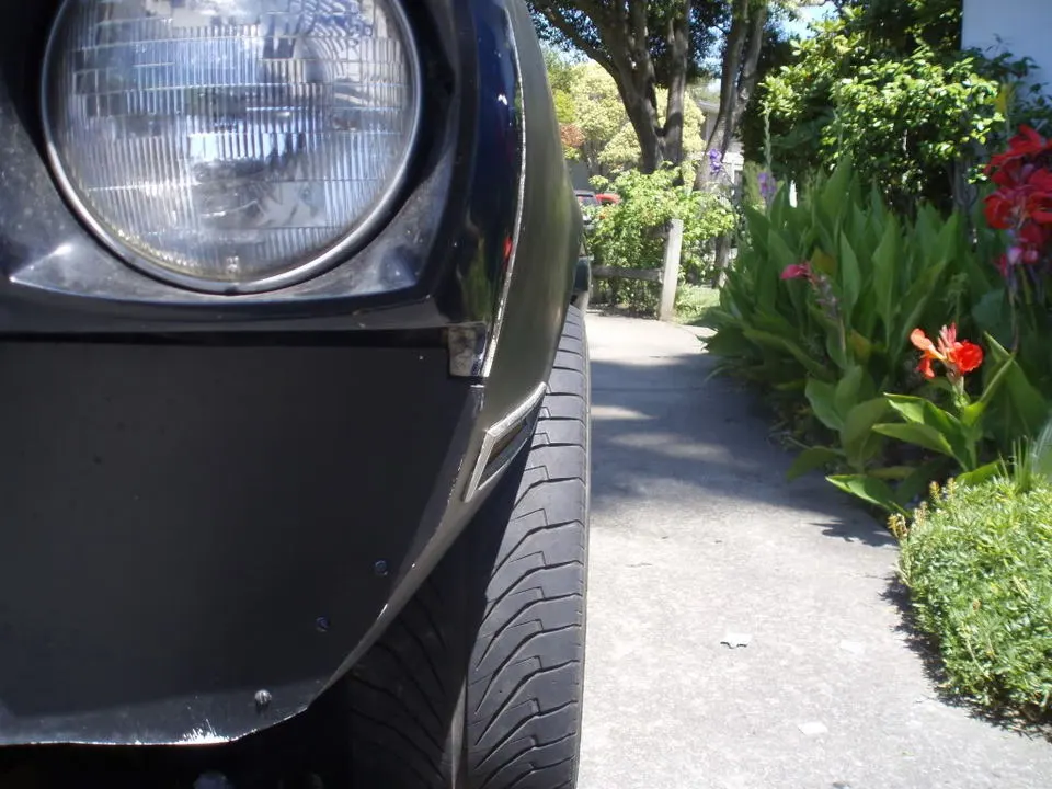

they stick out a bit in the front
and are in a bit still in the back
since the front went up with the new springs, theres tons of space up there. looks like theres either no engine or the car is under hard acceleration at all times lol

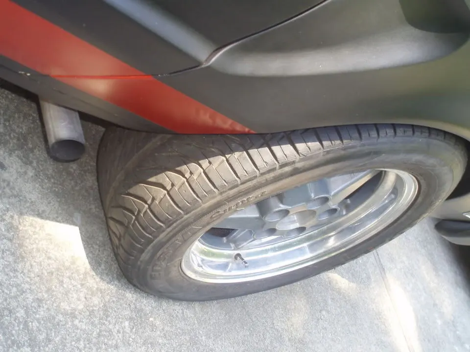

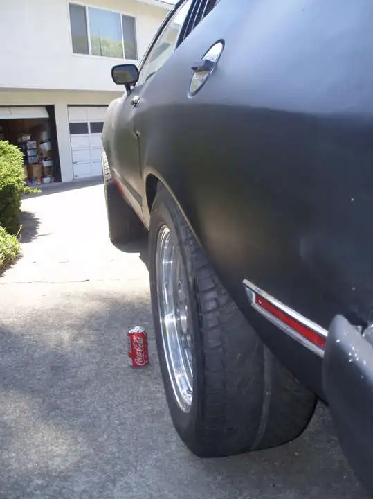

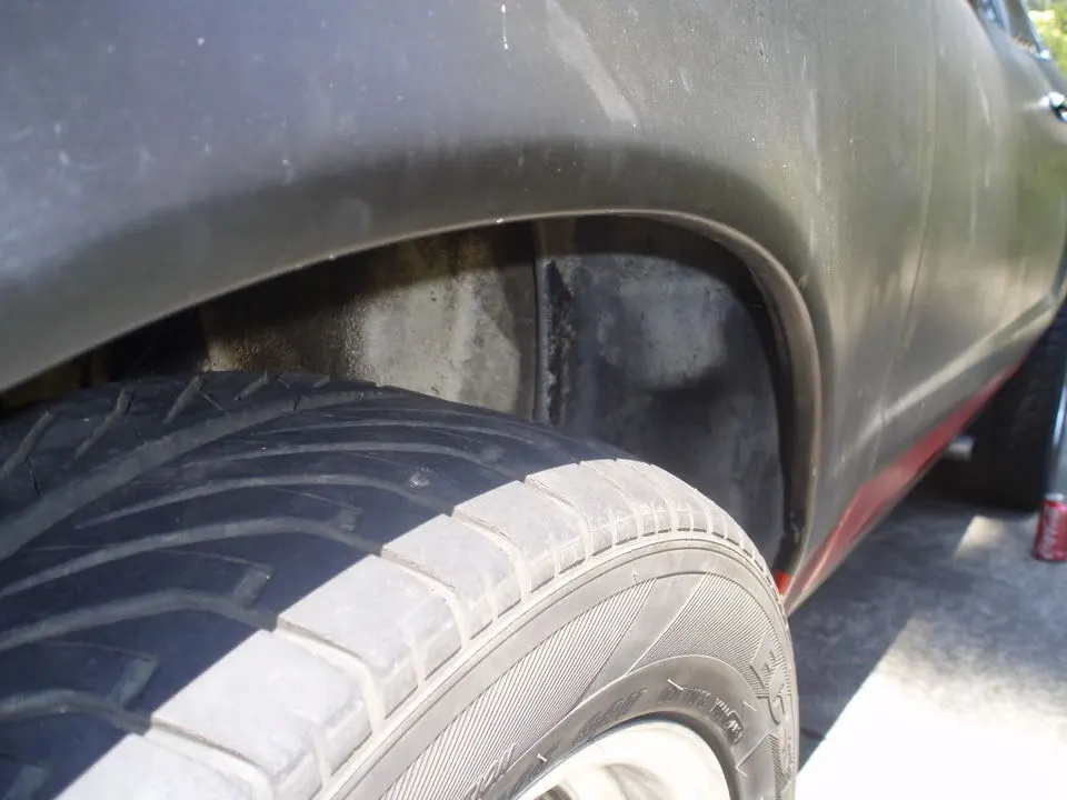

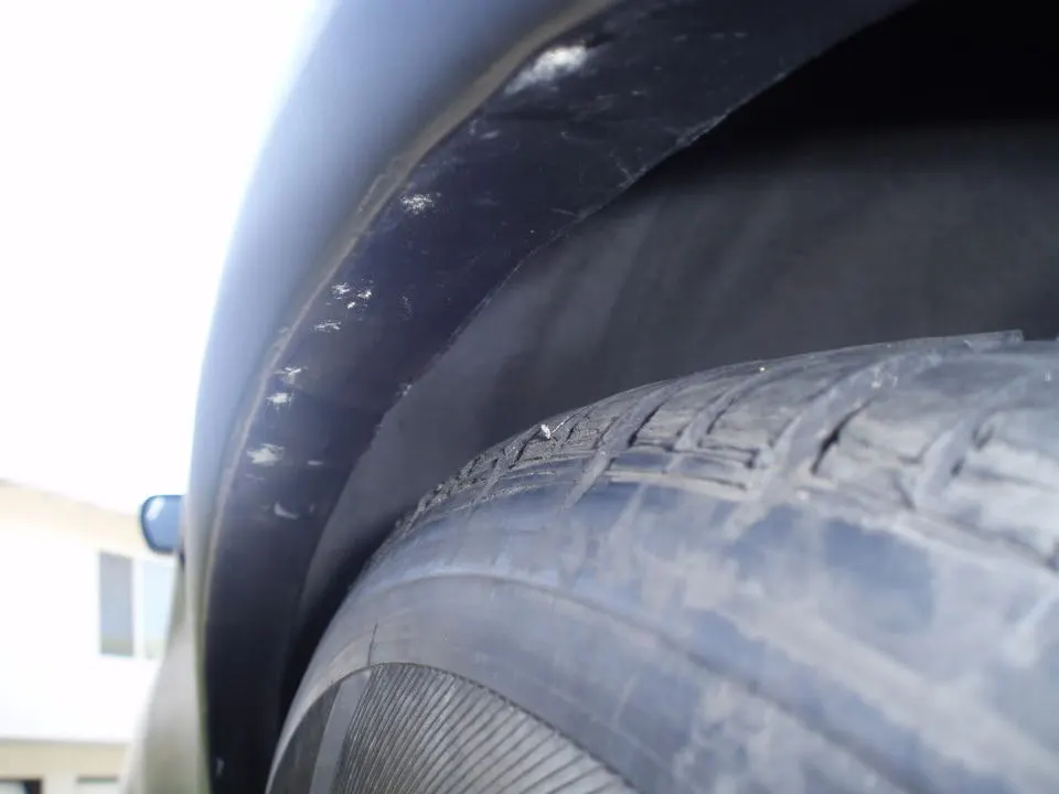

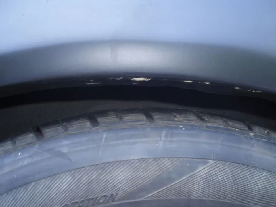

in the rear, clearane is very, very tight. I definitly am going to need those stiffer fiberglass leafs and have my fenders rolled if i dont want to hear rubbing every time the car is in motion. but on the plus side, the spacers are doing their job. when i had 245s on the rear on 10 holes with no spacers, there were millimeters between the sidewall on the inside and the car. the tires would scrape on the body on the inside and i know eventually they'd blow (i gave those tires away and had been running 205s in the back) now there's a couple inches between the sidewall and the car, so i dont expect any rubbing there

Nice wheels, but are those scuff marks on the outside of the rear tires?
If they are, your rear fenderwells might need to be "rolled" out of the way.
An old trick to roll them is to use a baseball bat to bend them, using the tire for leverage.

the spacers are billet, otherwise id be too scared to use the things lol. and those arent scuffs from my driving, since this car isnt in running shape at the moment (still mid EFI swap.. sigh lol)

If you have a couple of inches on the inside, you probably don't need quite so much spacer...but since you are doing a 5-lug swap soon, there's not much need to change them.

the couple inches comes from the spacer i'm willing to bet. it would have been very tight otherwise. The cars at my folks place right now so this is all from memory but...
the wheels are 16", 7" wide in the front and 8" in the back. the rear tires are 235s and the fronts 225s i beleive. dont remember the profiles off the top of my head. ill double check next time i go home, and ill measure for you too. and i wouldnt say the 5 lug conversion will be soon lol. outta cash, in college with no time to go home and tinker much :(
