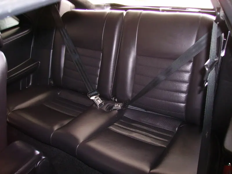

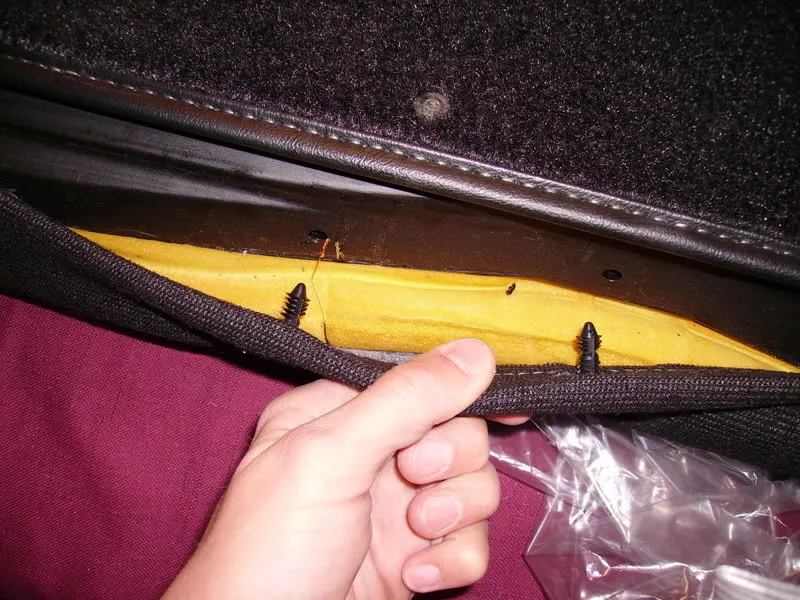

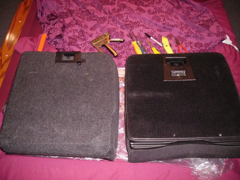

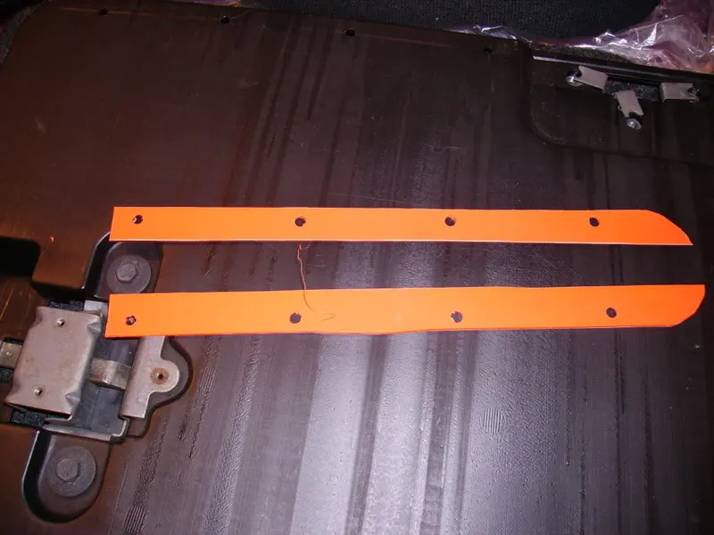

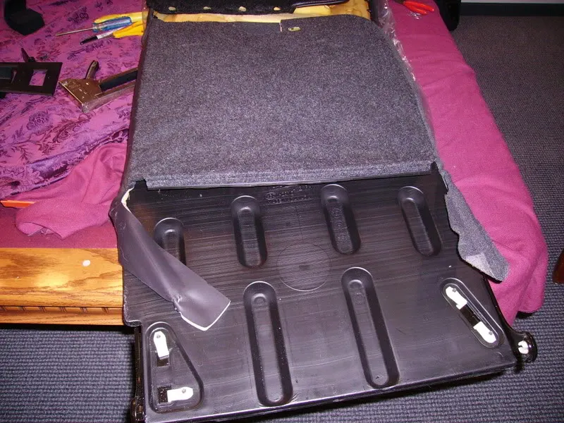

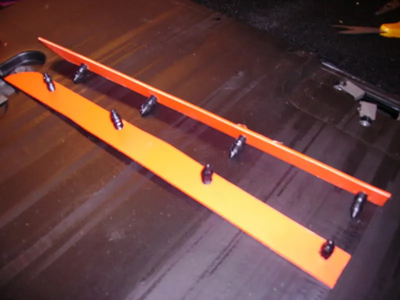

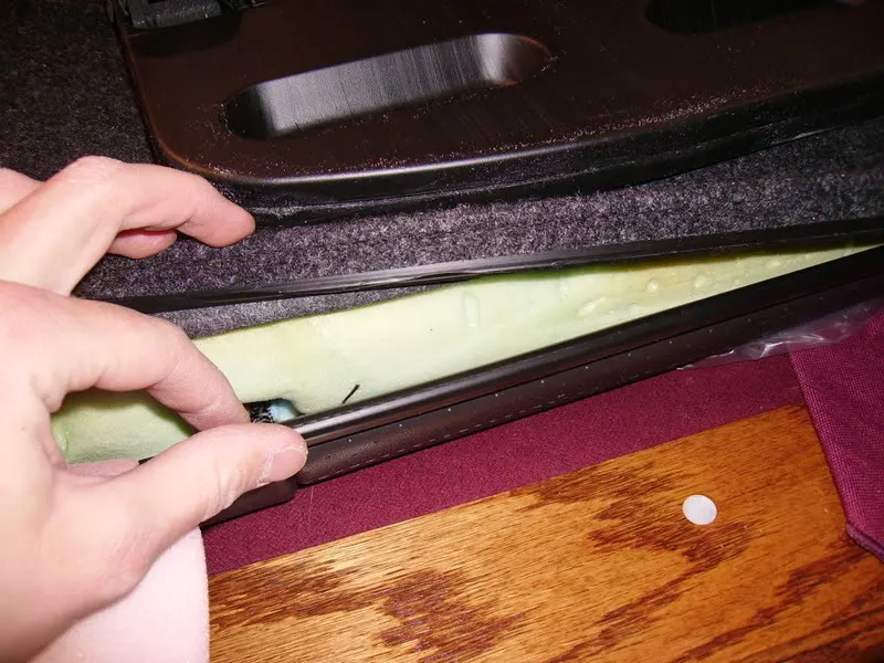

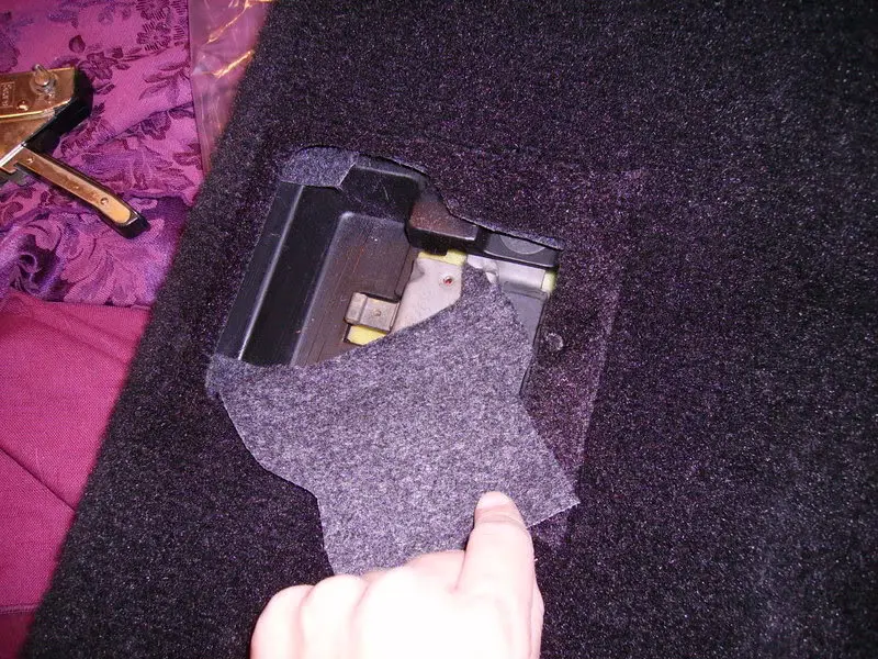

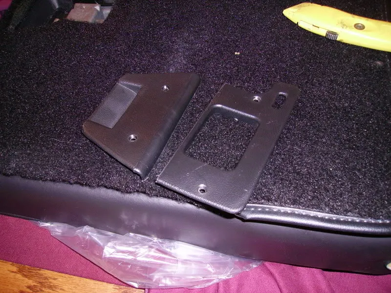

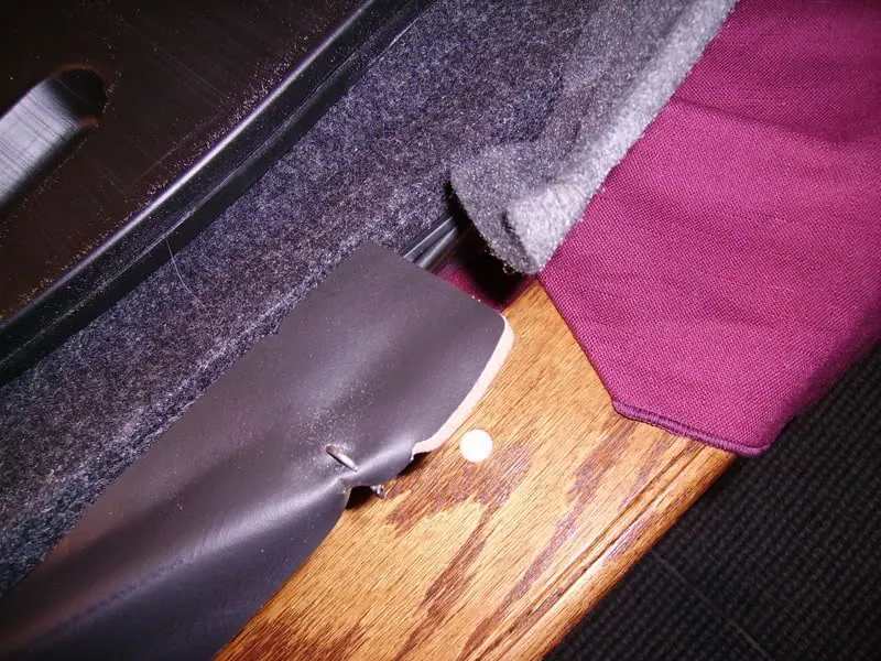

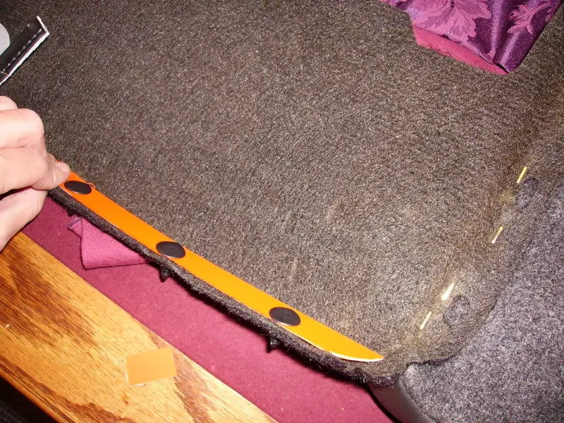

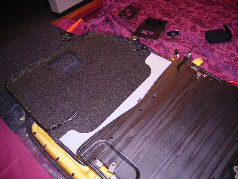

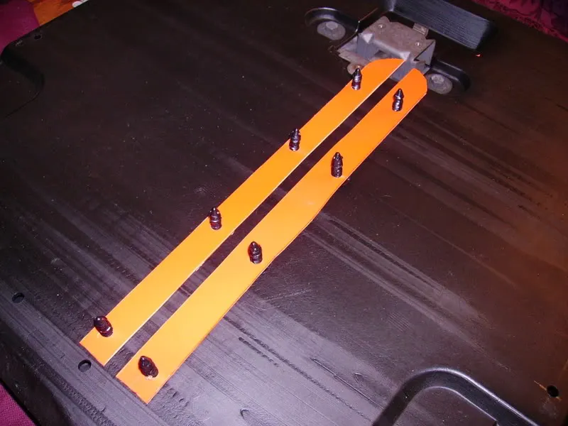

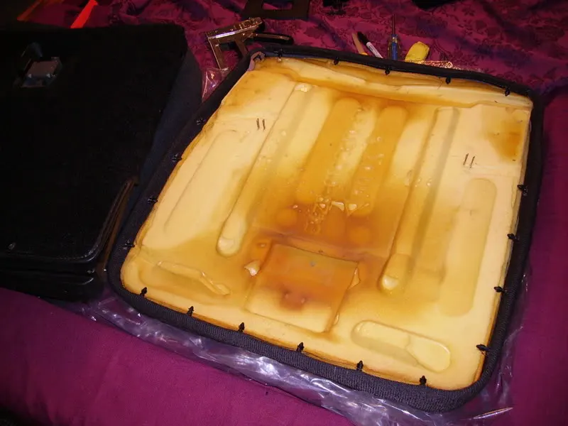

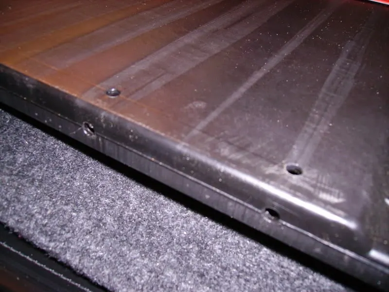

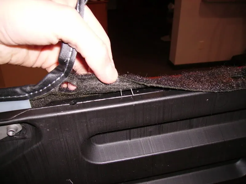

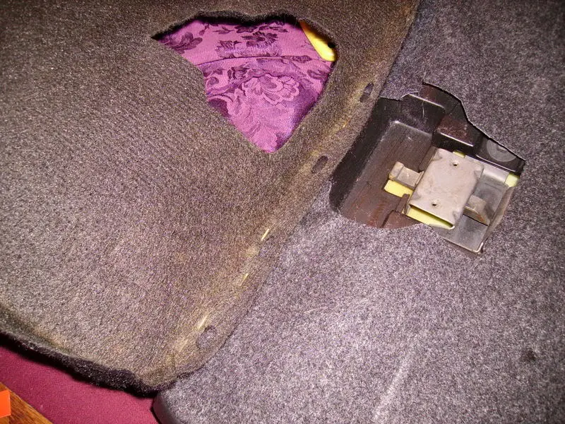

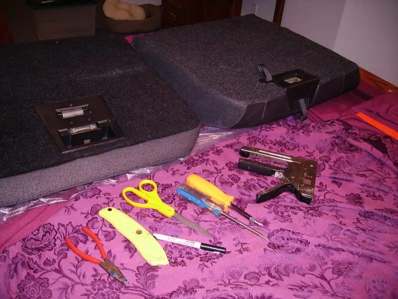

I used the "guts" from the stock 1990 seats and put them in the 03 seats and then made a way to secure the seat-back carpet on similar to the 1990's.
Only downside is the stupid sn95 latches you can see. If you want to do it, and do it this way then i can make up some step by step directions with some pics i took....
It is completely reversible too in regards to the stock fox seats so you may try it out if you like
