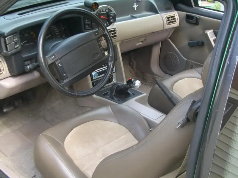

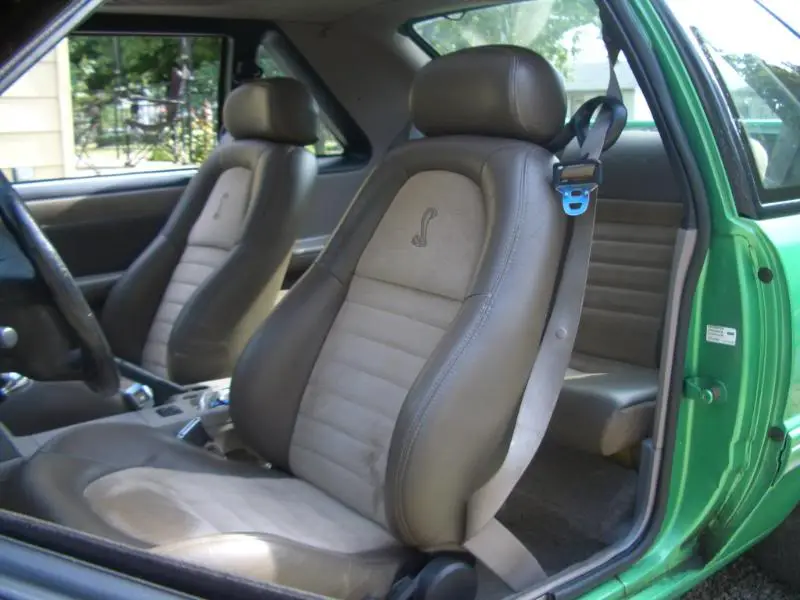

If you do it, let me know what you think. I bolted mine down, sat down and decided it wouldn't work. So, I took the tracks off of my stock seats and put them on then new seats. That made them feel even taller! The end result was a feeling of sitting on the car rather than in the car.

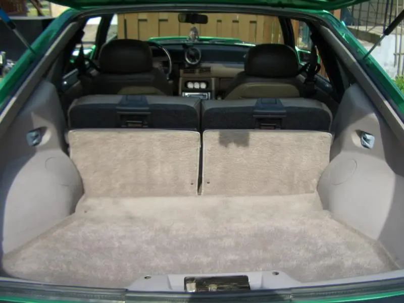

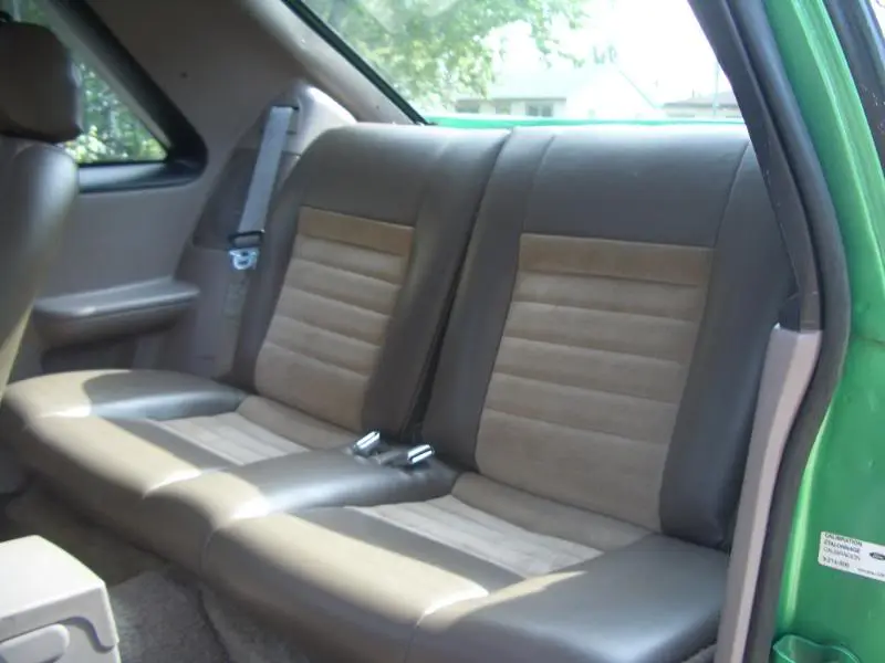

anyone whos done this have a problem getting the bottom of the rear seat to fit right? do i need to take out the bars that hold the fox seats in place? and how did you hold the sn95 seats in
i just removed the bars and stuck it in....there is an issue w gaps under the front of the cushon as the sn95 has a straight piece there and ours tapers or something like that...i just pulled the carpet up so you cant see under but never got around to actually filling it in lol.
I cut out the metal bars on my 2002 seats and cut some of the foam so it would sit a bit lower to the floor, more like the original seats. But like Adam said, there is a gap. I plan to someday fashion a wooden filler from a 2x6 so I can staple the carpet down and firmly position the seat. I even got the snap in brackets that mount in the metal rail on the newer cars to snap the seats in place.
This thread was incredibly helpful when I did mine this spring. Thank you for that. I just cut some of the foam on the seat ( just marked where it was hitting with a sharpie) and it fits pretty good. I left the metal bars in place and they seem it hold it in place pretty good. I too will be filling in the gap with a 2x6 and some black carpeting stapled to it.

I plan on installing my '04 GT "leather' rear seat in the next few weeks. I finally found some doner Fox seatbacks to use so i didn't have to cut up my MINT black fox tweed seat

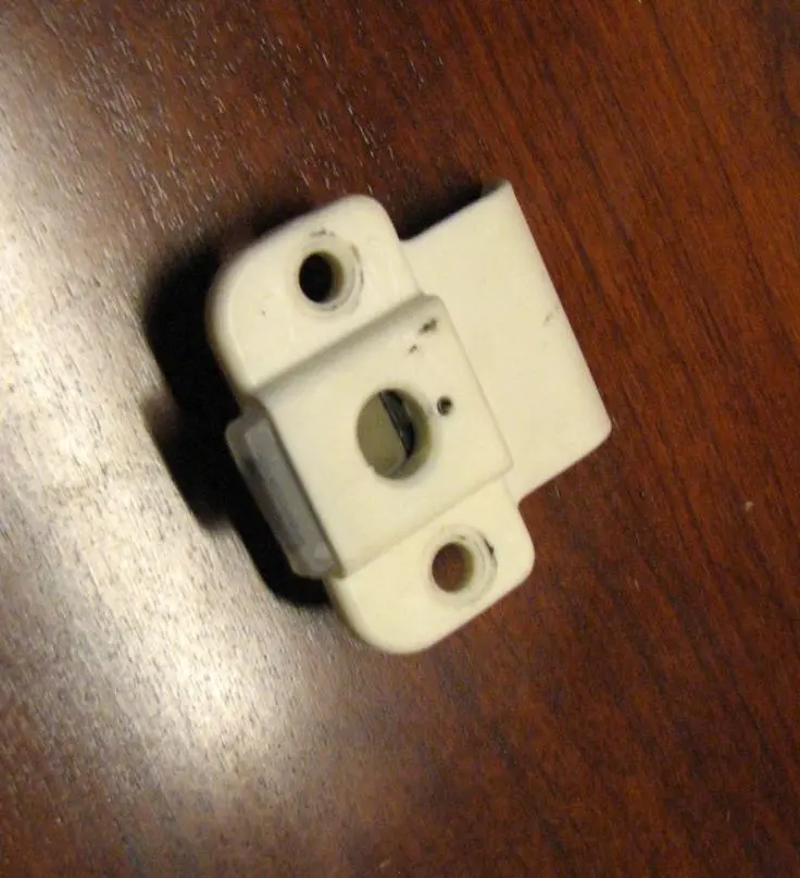

No, I haven't installed it yet, but I do have the clips. The seat bottom has two metal pins on it that snap into the corresponding retainer clips that are mounted to the metal brace that goes across the car in front of the seats.

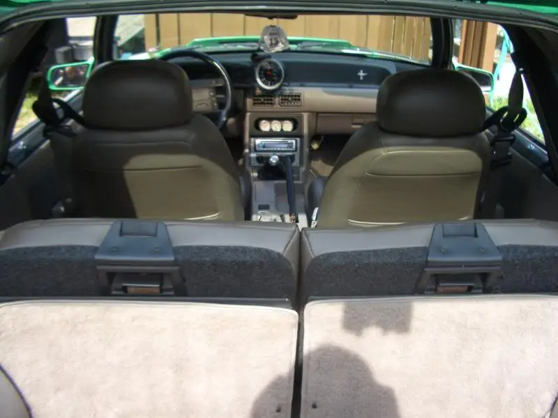

i got my backs all in today, still have to cover the gaps and figure a better way of holding them in there, the stock sn style clips might be a good idea...ill post some pics tomorrow
thats pretty much all mines doing also, i think when i close up the gaps in the front ill rig something up to hold the cussion in better...yours is looking pretty good too
