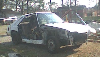

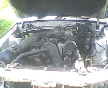

I purchased a wrecked '93 Mustang that has a top notch used 2300 and a rebuilt A4LD in it. The 3:73 differential is in good shape too. (3.73 diffy x .7 OD gear=2.611 final drive ratio. Third gear (D) 3:73 when going up hills and 2.611 4th (OD) on a good flat piece of HWY or Interstate.
Eventually I am going to install this complete driveline into my old '65 6 cyl convertible , GOvert: Grabber Orange convertible

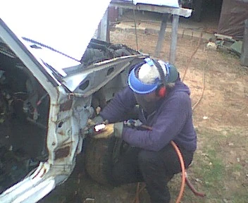

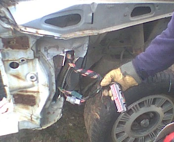

The Mustang was hit so hard in the side that the computer would not come out the normal way. I had to use a sidecutter/cut off tool to get to the computer
Finally able to slide the ECM out the front
Main ECM connector for those who havn't seen one
I unplugged the computer and pulled the wiring harness out through the firewall then hooked it back up (It still works)

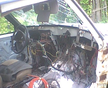

I am starting to undo the wrap on the harness to start the rearrangement of it

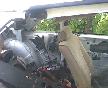

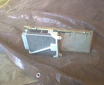

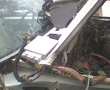

I have since pulled all of the wiring out from under the hood into the interior of the Mustang. I removed the DIS module from the intake and the relay box from under the hood. The will both be mounted the the Electronics board that will be in the glovebox area

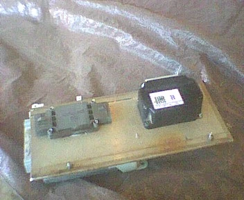

otherside of board
Here is a picture of the electronics board mounted to the lower attachment point for the glove box. The view is from the back (this is a dash cut out of a parts car)

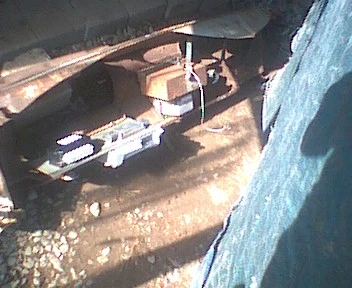

I moved the DIS module to the interior of the car. I wondered why FOMOCO installed such a delicate piece of electronics in such a harsh environment. One of their "Better ideas" ? However, before I am dead set on the location for the module I am going to do an RF interference test to make sure that it doesn't cause any "fuzz" on the stereo system.
I really want to use the AC system manufactured by the Texas based company called Vintage Air. I hope that the electronics board and the air box don't interfere with each other. This could hold up the completion of the wiring.

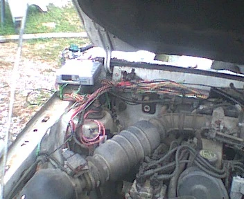

I happily got the electrical system re-routed in a rough sort of way. There are about 50 wires now that will have to be made longer or shorter. I was showing it to Mark the last time he was out and I kind of missed his question the first time around. I'm not so much trying to eliminate any sensors or systems other than deleting the EGR part of it electrically and mechanically. Actually the challenge was removing the "computer" harness from the main harness. Unlike the early computer controlled cars/engines that had a seperate ECM harness from the main harness, the "93 4 cyl Mustang had just one, big, messy harness. I sucessfully seperated the computer harness out of the main harness and over a period of 2 to 3 months and a whole lot of coffee, did this without letting out any "magic smoke". I've got the car back at the shop now and have left the battery hooked up for almost 3 months now without any electrical problems or dead battery syndrome.
As you can see from the picture it is quite a "nest" of wire and this doesn't include the 10 or so pounds of wire and instrument cluster that I deleted. The starter solenoid is mounted on the inside of the cowl and when it is installed in the '65 mustang will be located in the righthand torque box near the starter accessible from the inside of the car by folding back the front passenger carpet and removing an access panel to get to the solenoid.
The battery is behind the drivers seat now and in the '65 will be under the left rear seat installed much like and old VW Beetle battery was from the factory.
Edited 6-3-22 If this battery location does not work out it will be located in the trunk. The 2300 air filter box is occupying the original battery location.
The engine compartment area is starting to look cleaned up a bit without all the wires running to the DIS module, relay box etc. When I install the headlight and other harnesses in the '65 I am going to route them through the frame rails to kind of "hide" them too.

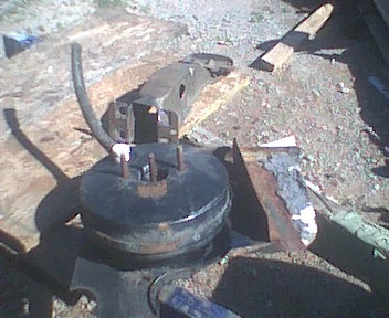

GOvert Brake System part !
Not all of the ideas posted here for the GOvert Project are my own. I will give credit when credit is due

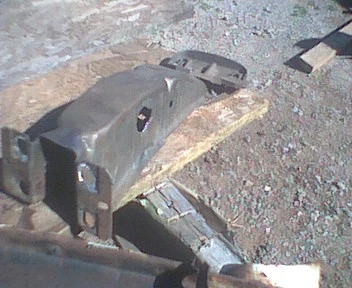

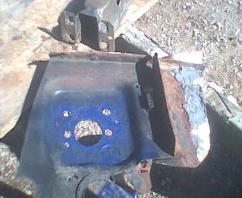

A few months ago on a Saturday I had a couple of hours that I could start working on the brake system. I saw on Mustang Steve's Website where he installed an '83~'93 Foxbody Mustang brake booster on a 65-6 Mustang.
Well I had handy a junk booster, a busted up brake pedal brace, and a piece of firewall from a chopped up '66 Mustang.
I used a sidecutter and ground on the backside of the nutserts on the brake pedal brace. The used a small hammer to knock them out. I also had to trim on one side of the brace a little for the booster nut to clear. I made a template off of the backside of the booster to transfer to the firewall. Two holes up top have to be enlarged a little. Center hole some and add two holes at tbe bottom. One hole goes right through where the clutch rod would go on a manual trans car. This WILL NOT work with a stock Z-bar set-up ( My "stang will have an auto trans).
Below is a pic of it all bolted together (Poor quality pic, I will replace it soon)

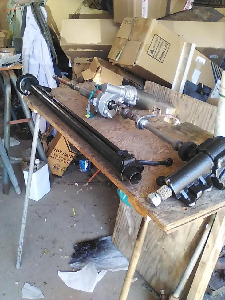

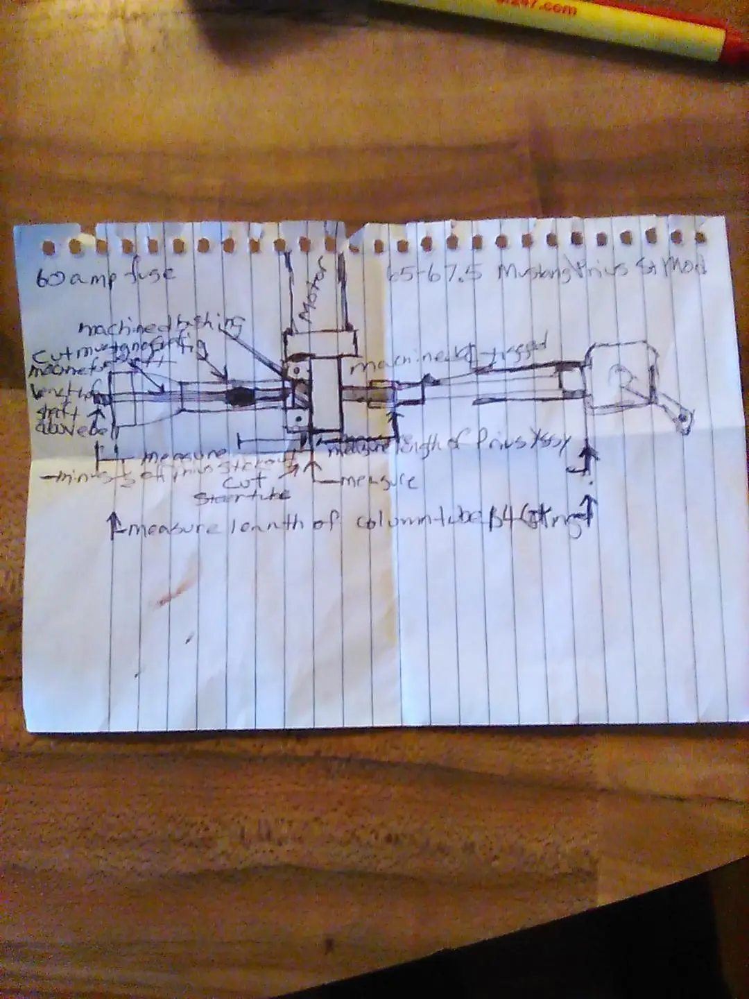

I added one picture of the modifications to the Prius steering. This will fit under a 1965-66 Mustang dash and maybe other years too.
This is just the first draft. I'm sure the finished product will be a little different.

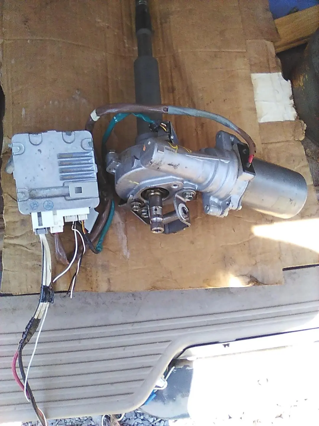

Picture of 2004-09 Toyota Prius EPS. When retrieving this from a junk/parts car, clip only the heavy gauge power supply connector and the power on box connector from the main body harness. Don't forget to get the little ps control module (box) when you are getting the rest of these parts. It will not work without it.

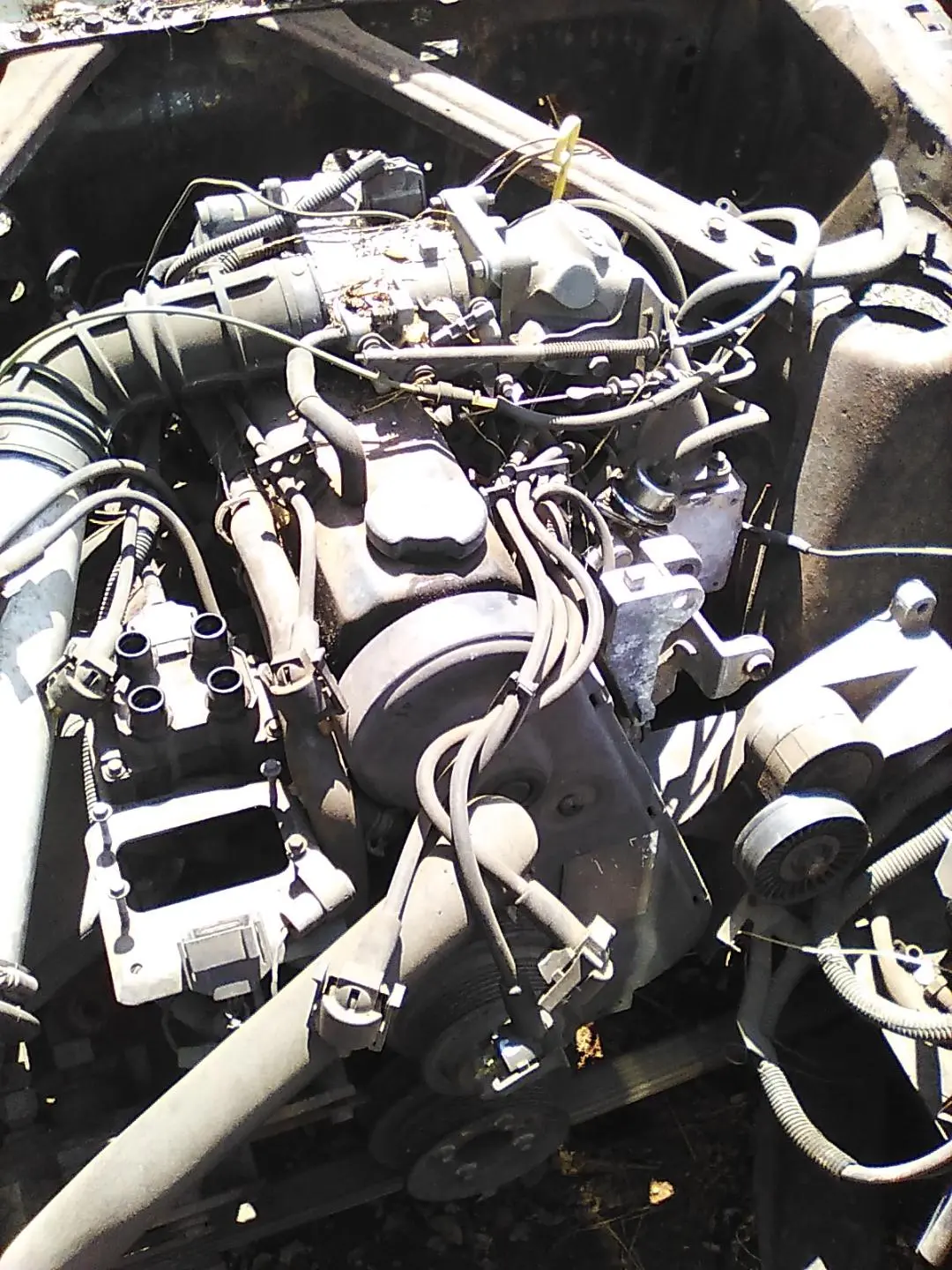

Picture 0f 2300 mounted in the '65 sub body

Quick update. Not much progress on the main part of the project however with help from a machinist that tig welds too, I was able to assemble the Prius electric steering combined with a new 16:1 (Shelby ratio) steering box. I installed an identical system on a '67 for a customer. He is 70 something and loves it. The 16:1 ratio came stock on power steering cars. I have driven the customer Mustang several times and it is tight. It feels like driving a rack & pinion steering late model vehicle. It took me a little time to get used to it after driving early Mustangs with wore out 22:1 boxes. Driving with a sawing motion (quiet lol).

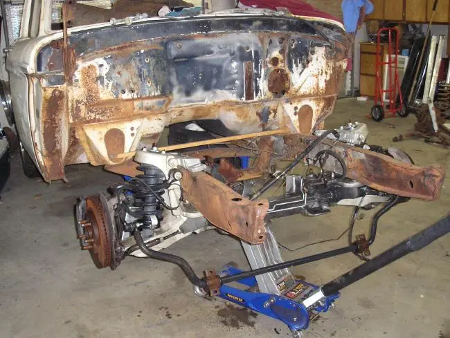

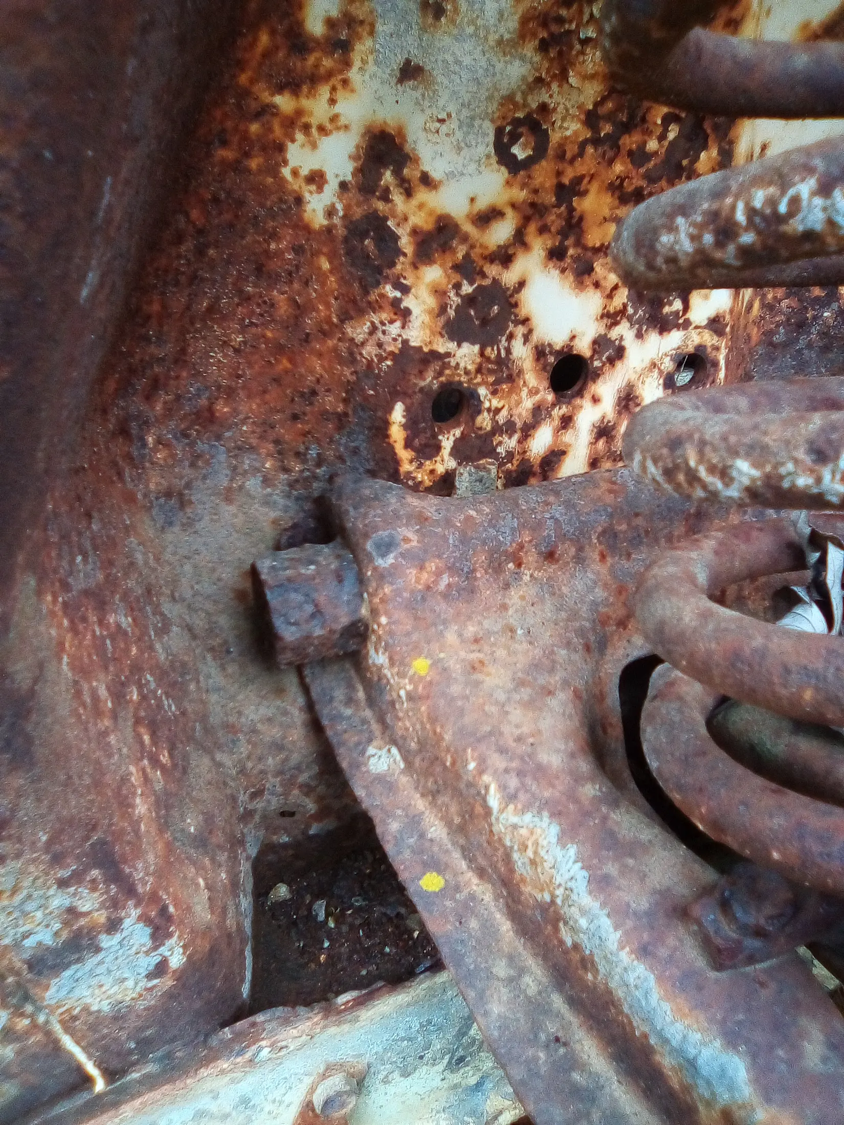

I see here after going through my post that I have'nt shared much about the frontend changes other than the MII/Granada rotor SR front brakes but I'm at the point of making a crossmember for the MII rack&pinion steering. There are lower controls arms that are going to have to be braced rearward instead of the stock way because of r&p interference.
I have successfully installed Mustang II front spindles to the front end. Anyone that has taken multiple generations of Mustangs apart or built a street rod using MII spindles, knows that the spindles are over an inch shorter than an early Mustang or camaro. I fixed the way that the upper control arms relate to the MII spindles by essentially doing a 2" Shelby drop for the mounting of the UCAs. Probably are going to use an adjustable coil-over-shock to get the ride height corrected.

I'm going to work on getting the engine going again, it had well under 100k. I have a modified Fox body trans crossmember (narrowed a bit) to hold up the transmission. I had previously started roughing in an exhaust system to get a muffler on it and I'm sure that a custom driveshaft will have to be put together. I also have a rearend out of a 1985 4cyl/5 speed Ranger. It has the gear ratio to work with the overdrive A4LD transmission. The width fits the 65-66 body too.
Some of you may say that the 4cyl engine does not have enough power for the old 6-cylinder Mustang body. The power is comparable to the old 6 cylinder engines. I used to drive a brand new 1986 Ranger 4cyl/5 speed delivering pizza. It really did perform well and light on the front end. I'm trying go maximum performance in a mileage sense, not racing the clock!

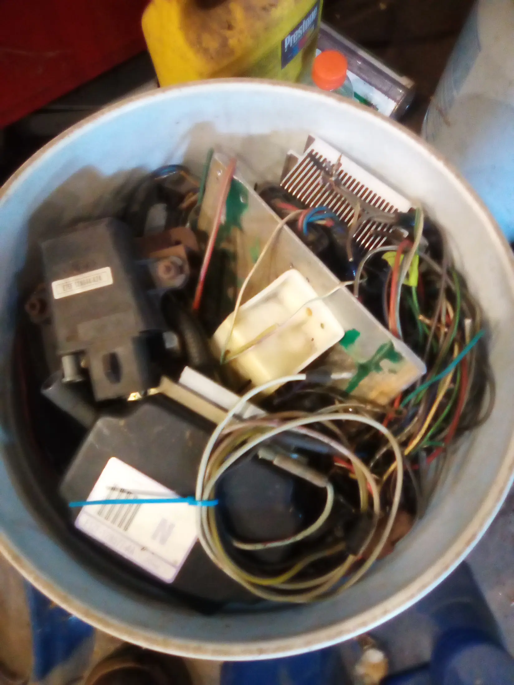

My wife has gotten most of the way through her battle with lung cancer and on the home stretch of it all having immunotherapy treatments every three weeks. Me and her have 11 grandchildren now, including 3 by marriage.
Today, I got out my electronics and wiring bucket, pic above. I thought for sure that the ecm was in there with the engine harness, relay pack and DIS module.
My D1L1, in think it is, ecm is not in there. It has been many years since I put it in a logical, safe place.
