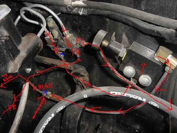

Yeah, that looks about like the wilwood one I have. The price is about what I got it for. Check summitt and jegs. Heres my setup(i have a bigger blowup if you need it):
