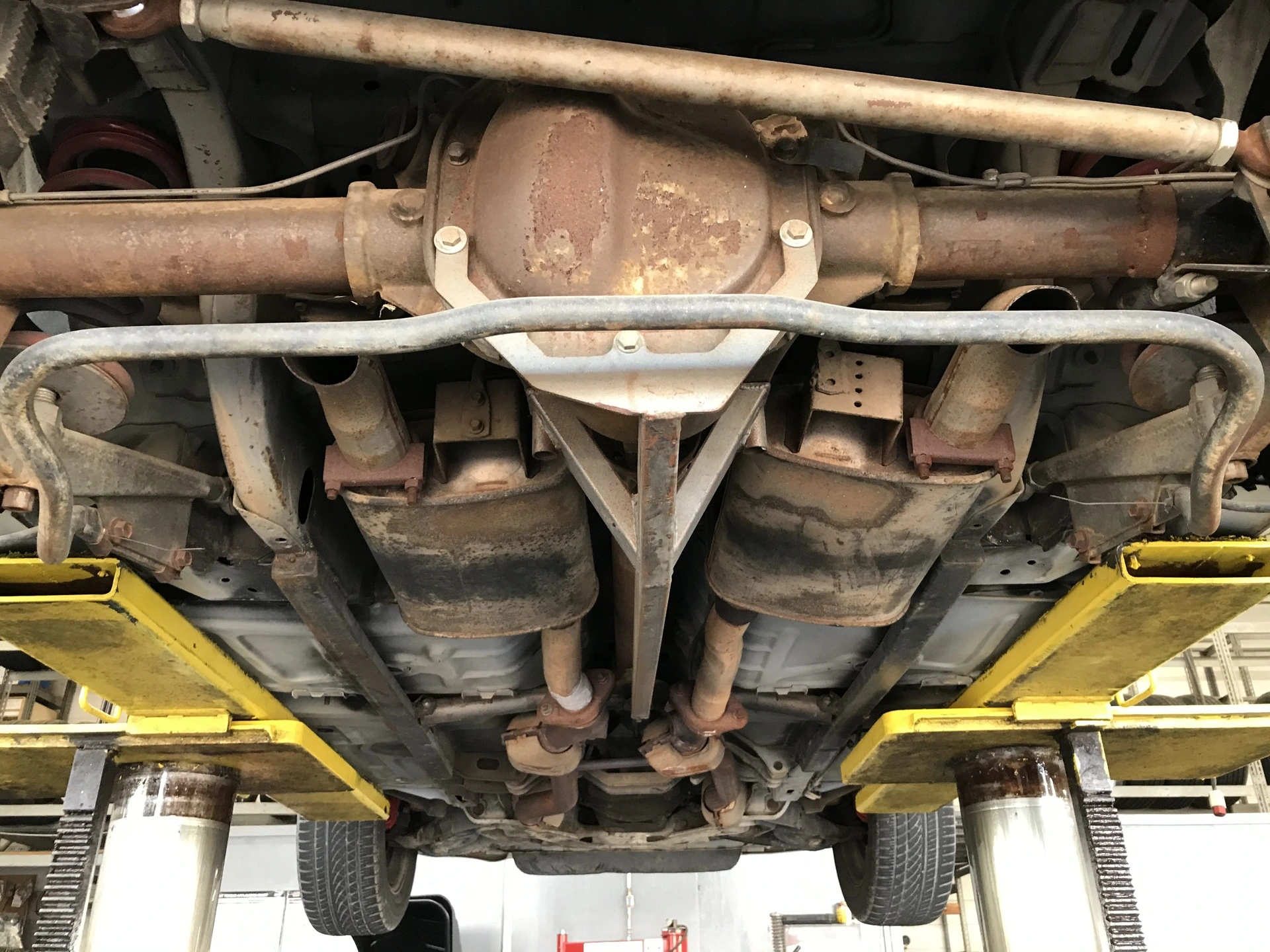

Here is my car on a lift. (the PHB is level to the ground when the car is sitting on the ground)

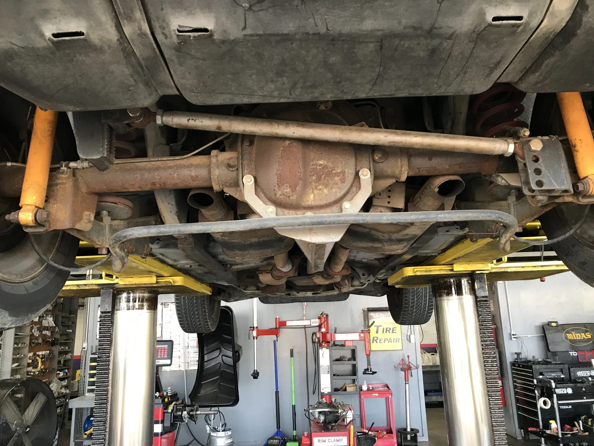

Here is the Griggs TA with the different front mount

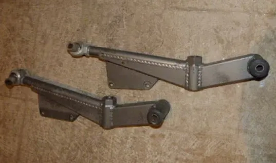

And here are the adjustable LCA's, this is a photo I found on the internet, my LCA's have the adjustable spring perch.
