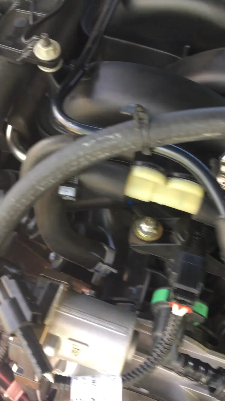

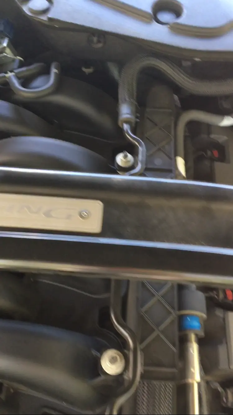

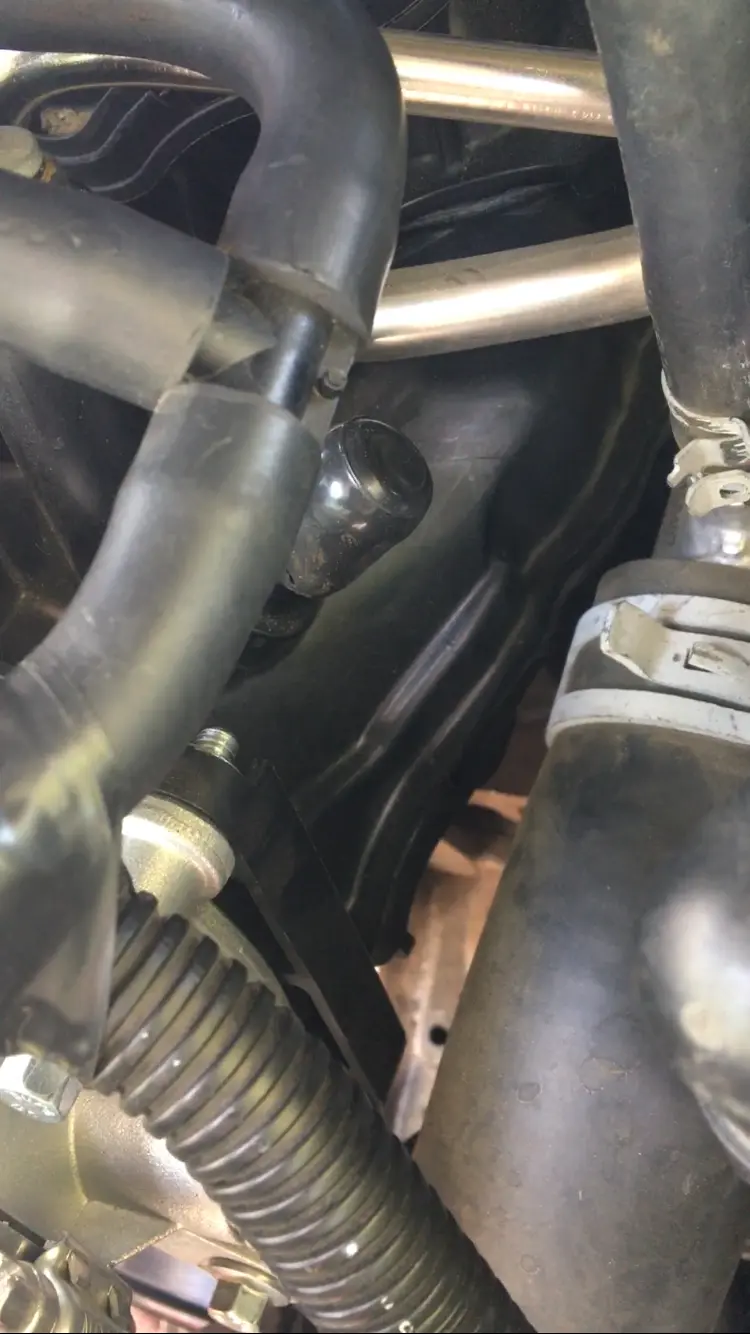

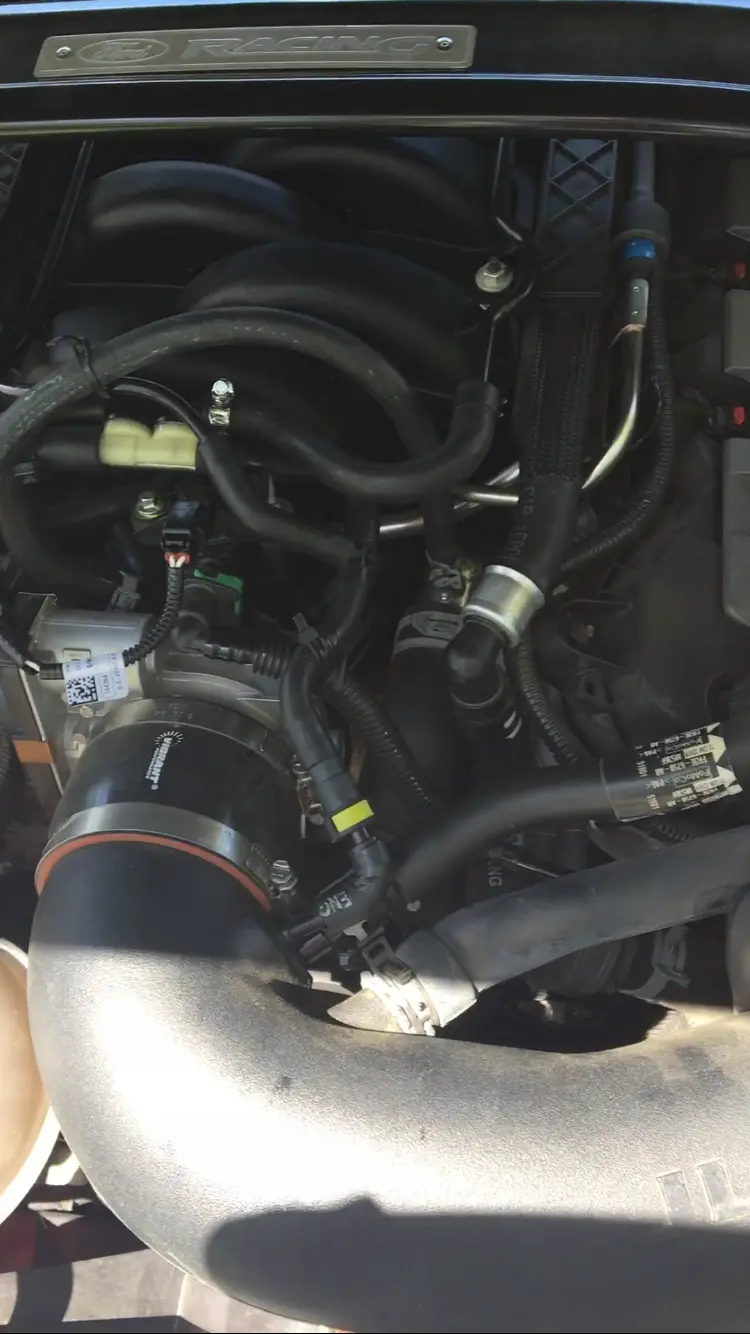

I changed the vacuum lines up after I had this issue. So I don't think it's the way I have them set up.
Here's some photos of how i have it hooked up now. Sorry they are screenshots from a video so some of them might be blurry.
