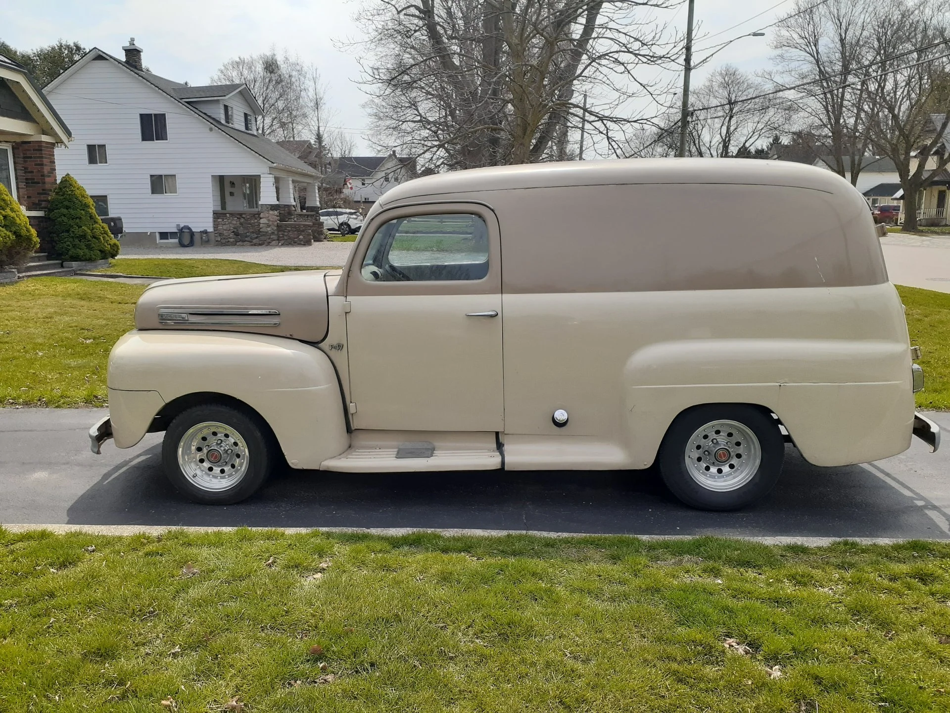

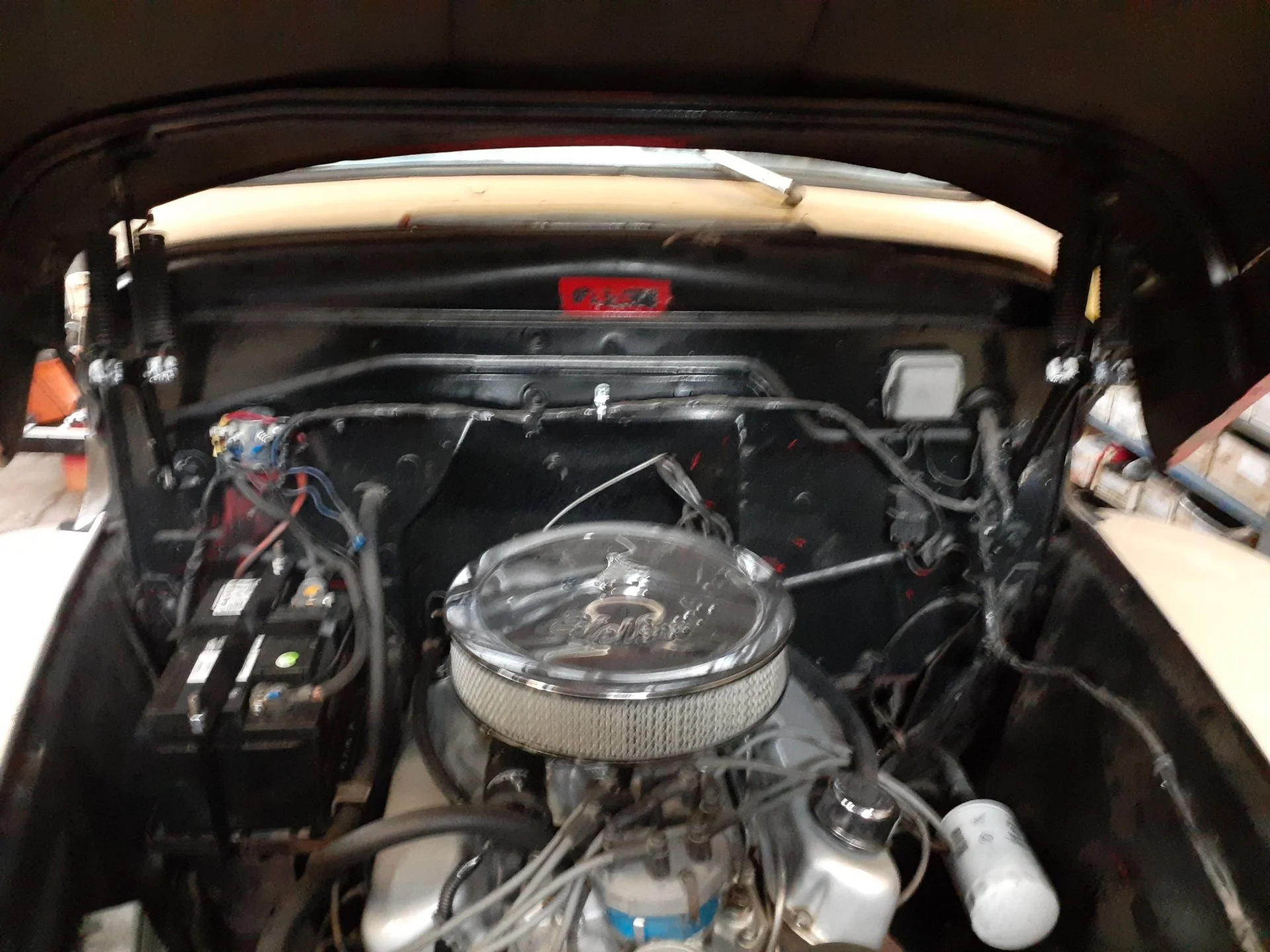

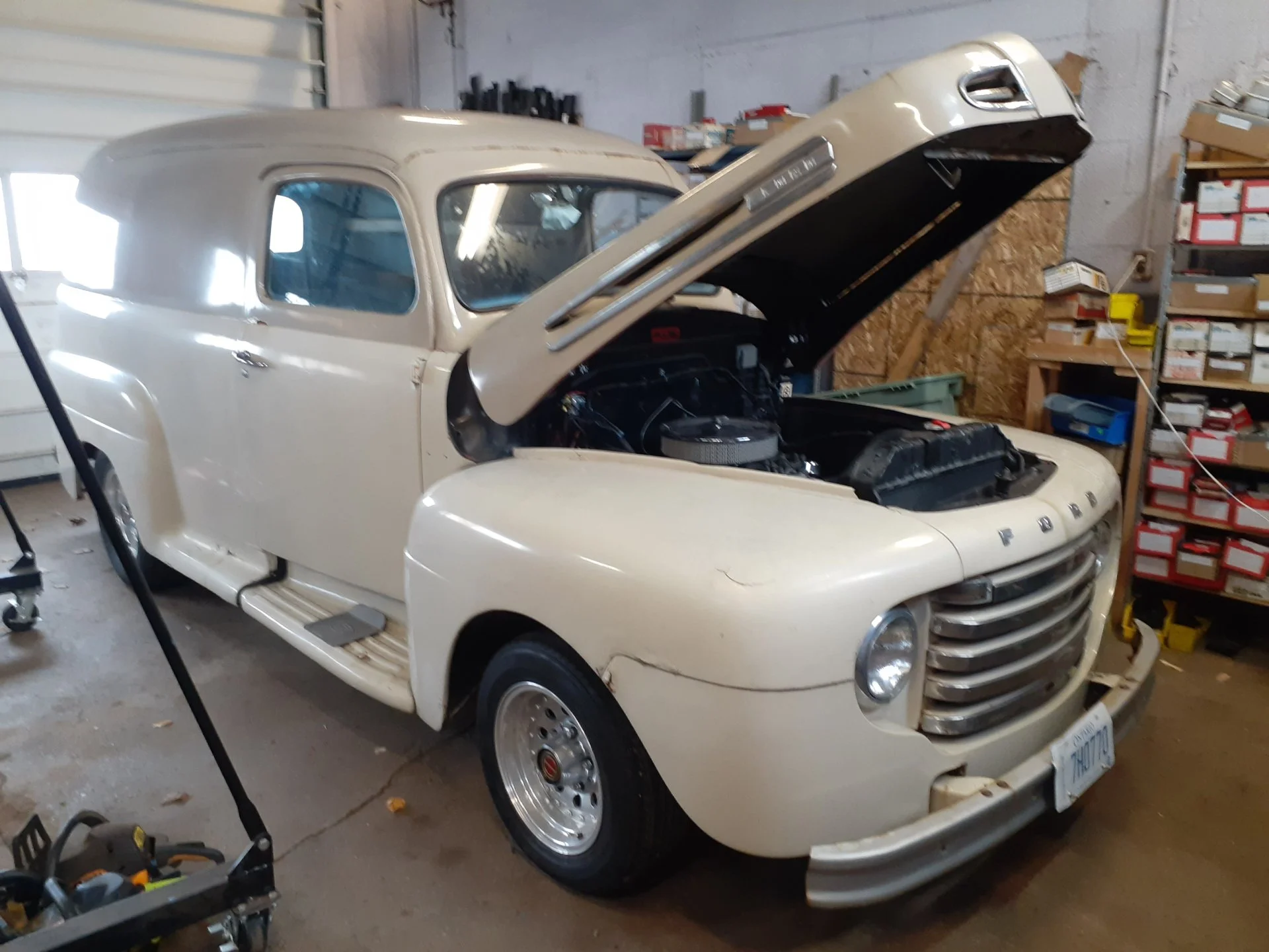

Picture of the 48 panel would be fun!

B
butch botch
Jan 23, 2022
Aylmer Ont Canada
Nov 13, 2022
  • Nov 13, 2022
Reactions: Noobz347, nickyb, Mach1 Driver and 4 others
