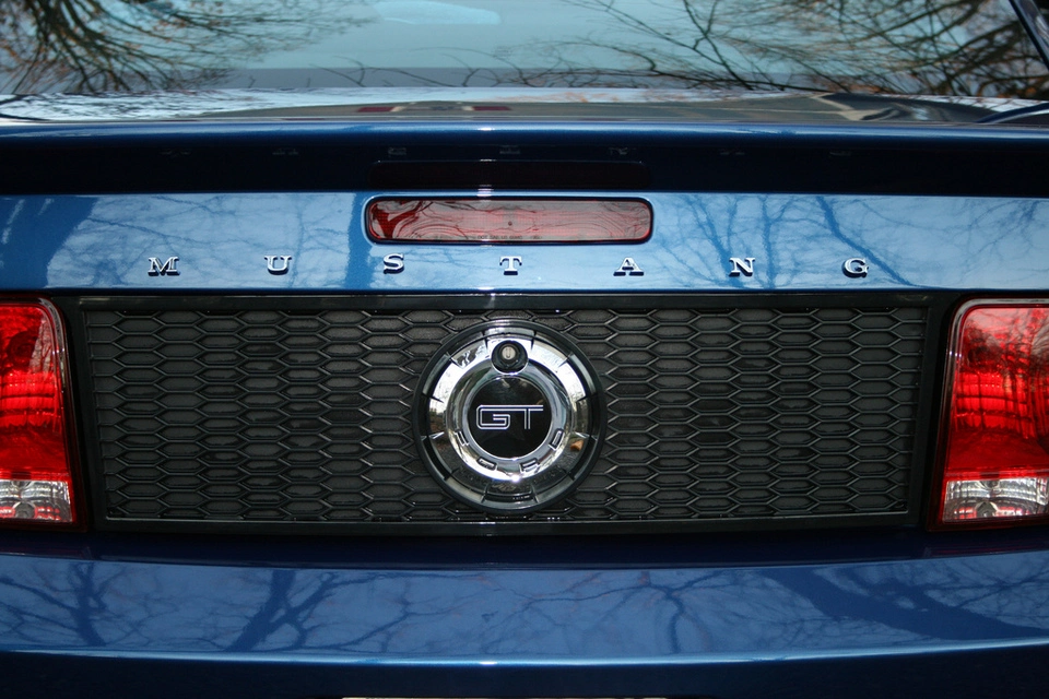

I know your dilemma as I had this happen with my honeycomb panel! It is curved so I bent it to fit on and I applied a bit too much pressure and she was stuck on(big props to the proper 3M tape for the job)ever so crooked, but I could tell instantly! I kept it this way until I placed the "MUSTANG" letters on the trunk lid, then it didn't line up at all! The next day I used way too much elbow grease along with heavy duty fishing string to remove it! It took me several hours, but it looks 100% now. After that episode, I too, only peeled enough tape out from under to tack it, then pull the rest out after satisfied with the location on both the front and rear spoilers.
If you can live with it and the holes aren't off that much, I'd say go with matching the two holes, use some silicone caulk on the underside and call it a day. I still have yet to fix/rotate my hood pin scuff plates since it looks ok(to me...for now)from a distance.
Here was my before and after fix of the honeycomb panel.
Before the lettering...
After the lettering...
All fixed...
