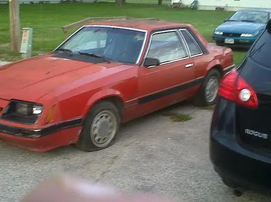

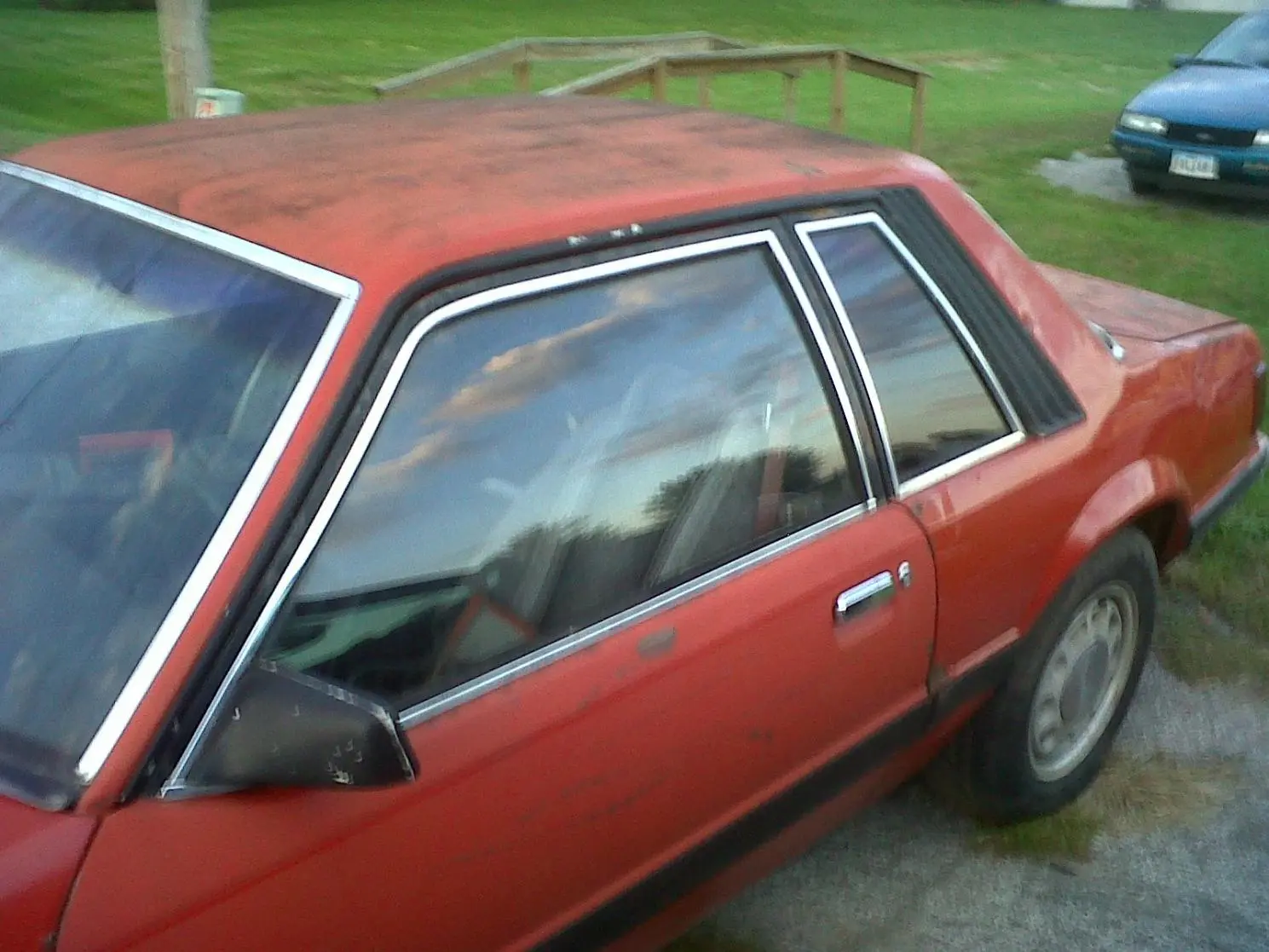

Here's one i took with a crappy cell phone. Any ideas how to get that stupid chrome piece around the windows off?
