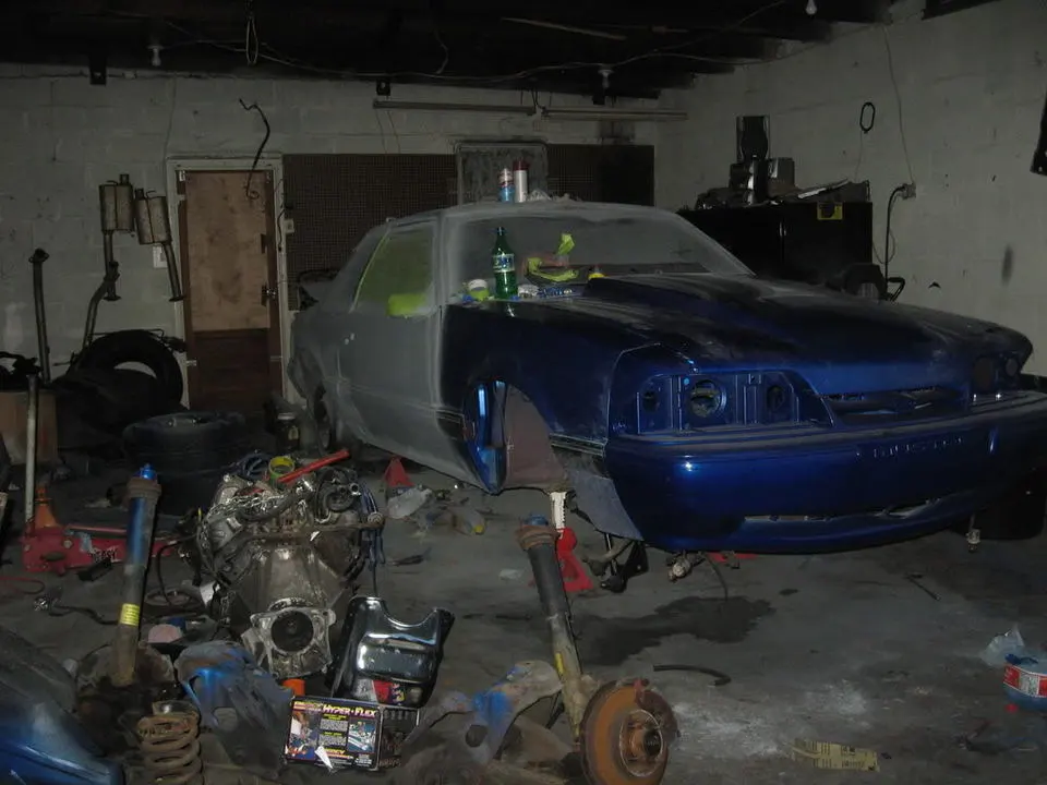

guess who's got 2 notchbacks to make 1 car loads of pics

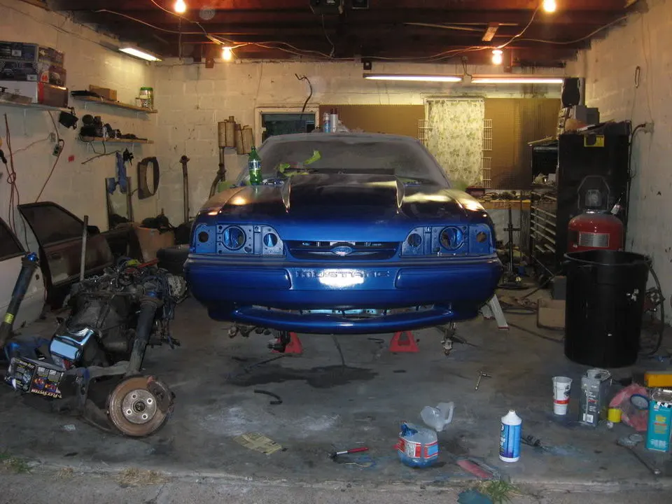

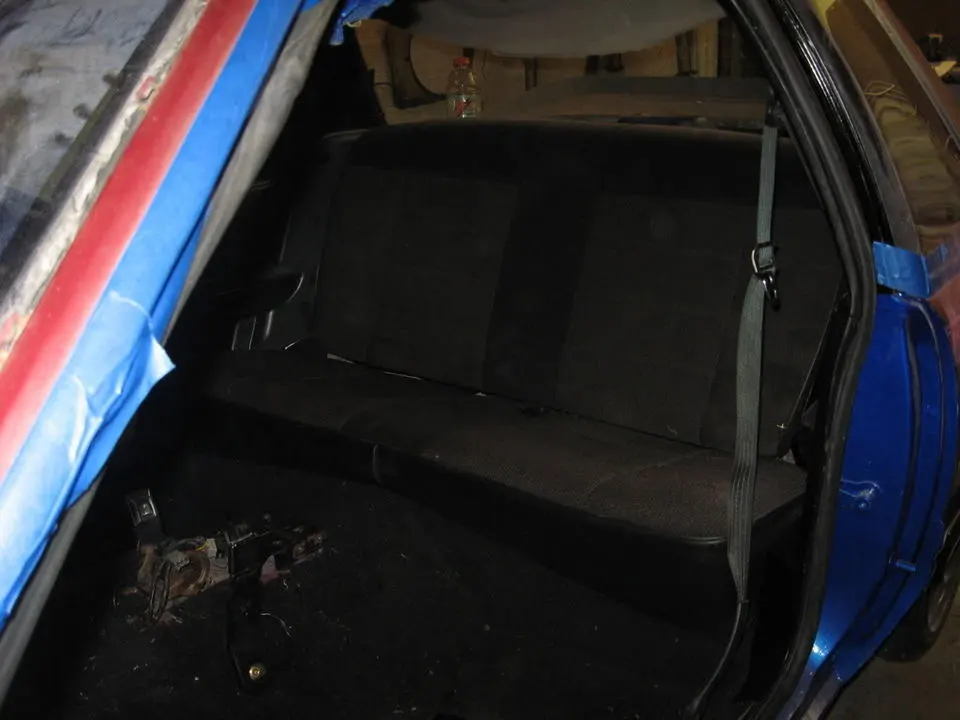

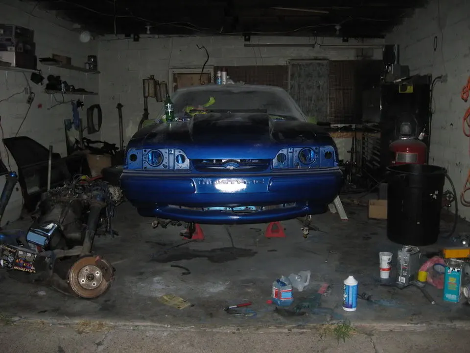

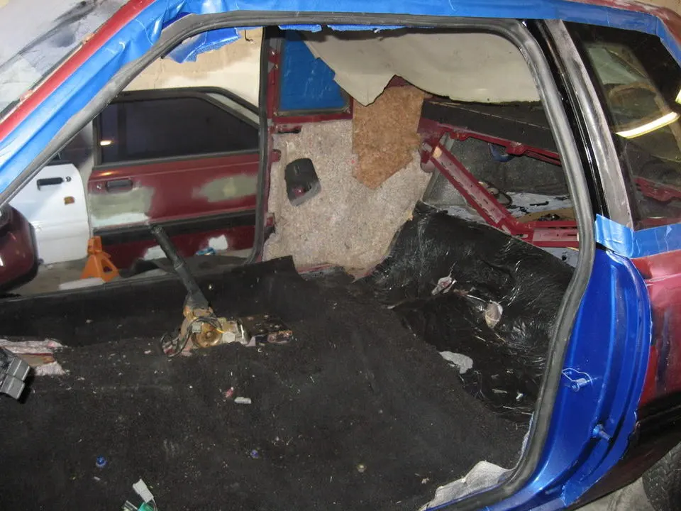

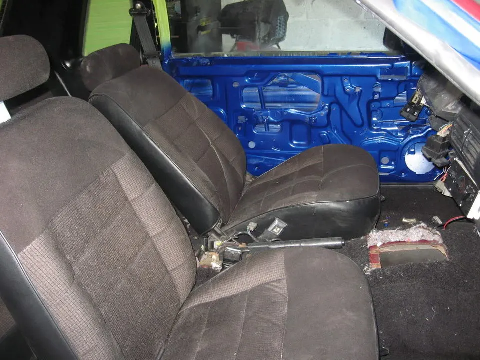

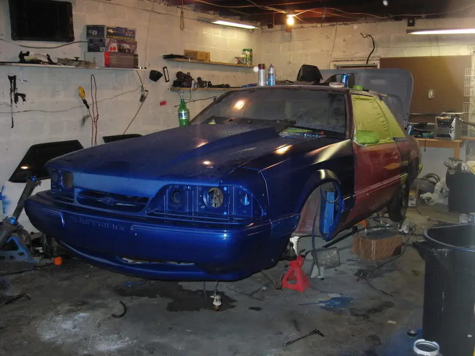

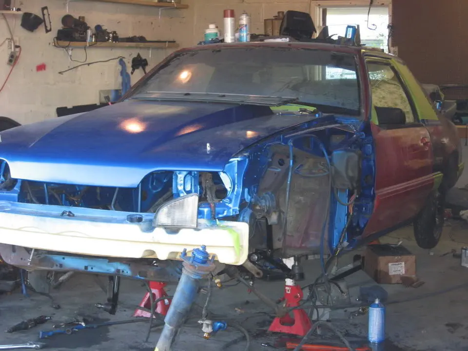

here is some new updated pics no tint some interior installed k member installed

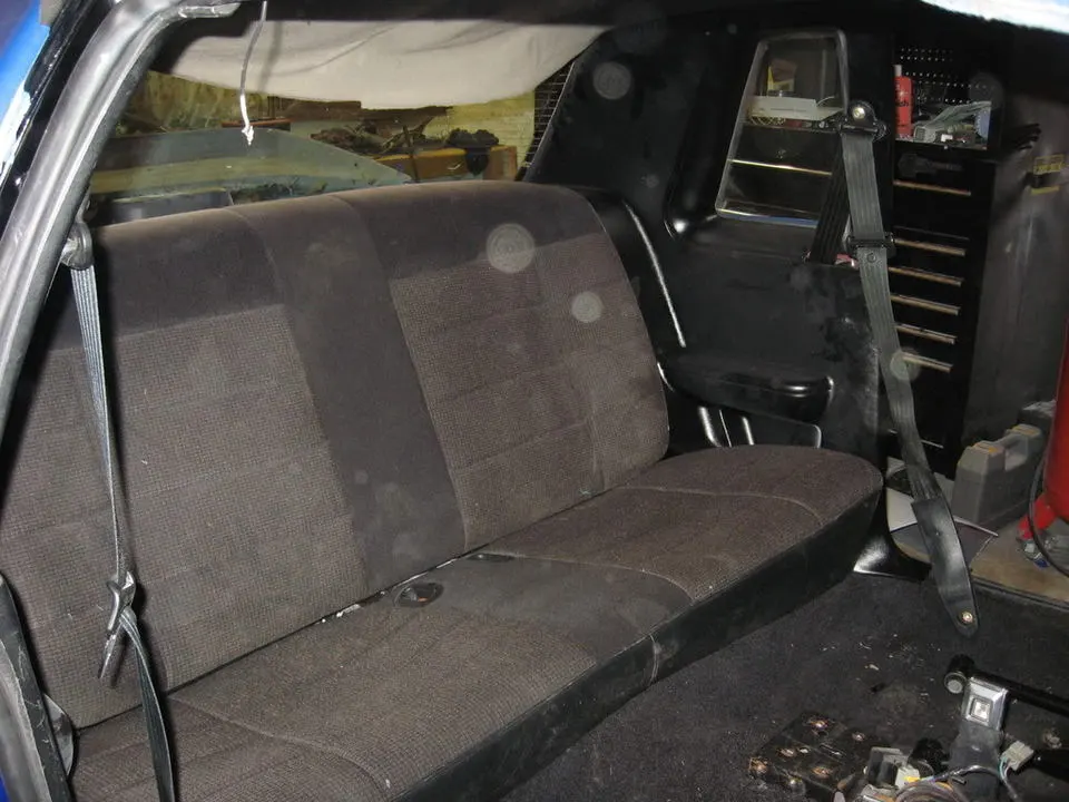

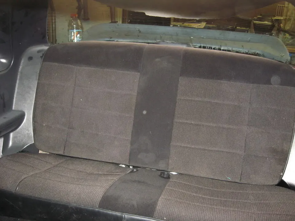

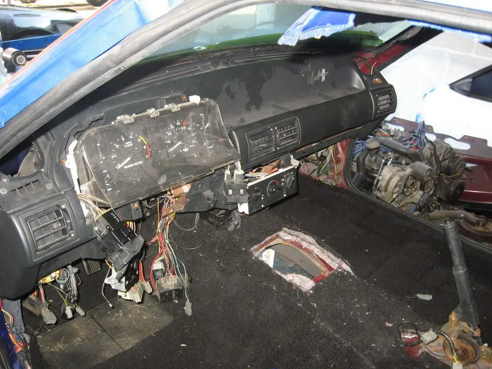

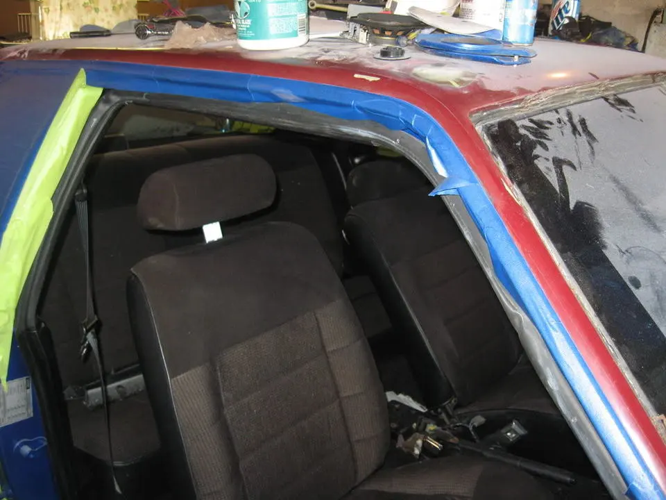

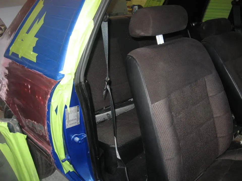

i bought a 4cylinder at an auction about 2 yrs ago for 600 just for the interior the interior is soo clean it looks like the person that owned it had no friends
lol! That is definitely a score.
I like the black interior in my 1991. My other cars had gray, or blue color interior. The Black interior compliments the blue paint very nice on your Stang.

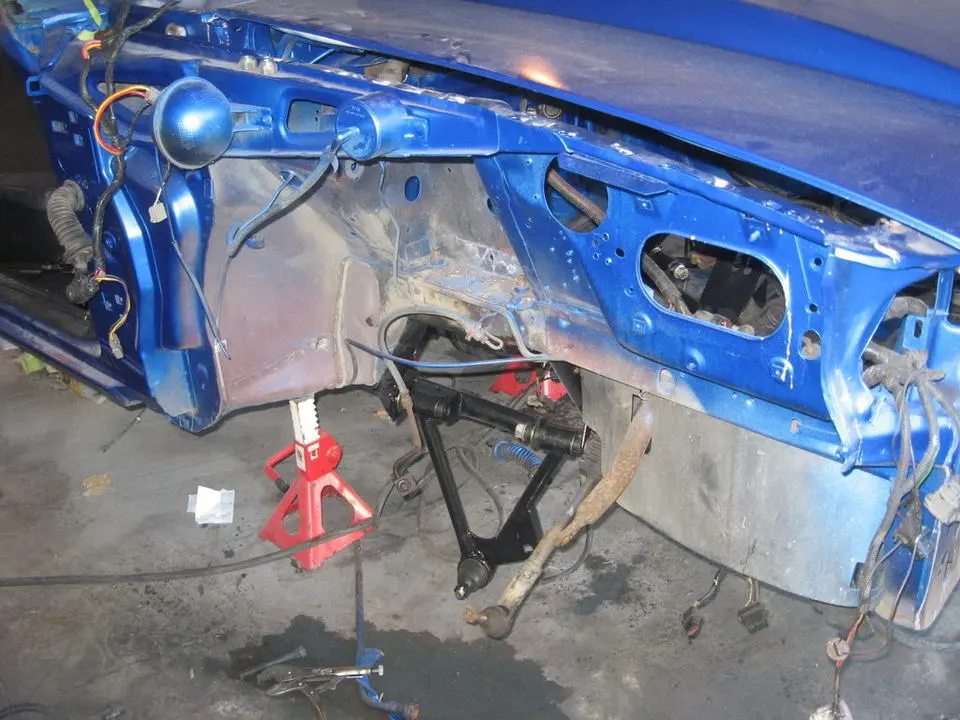

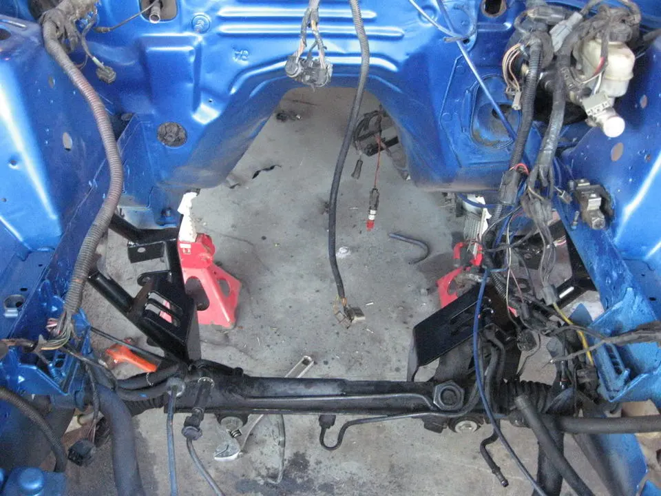

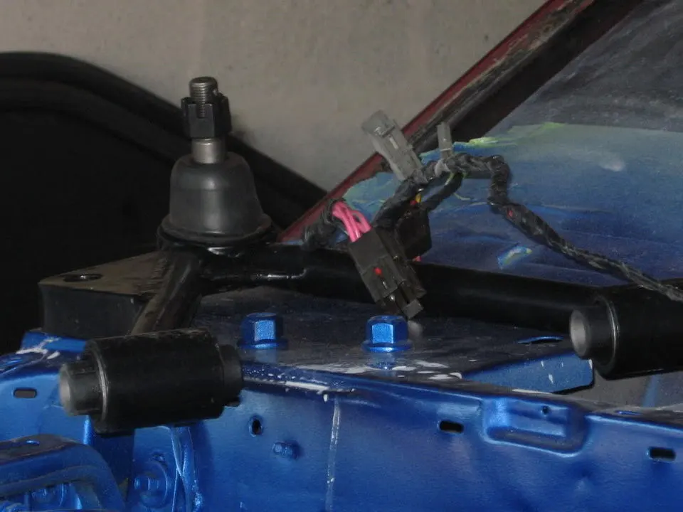

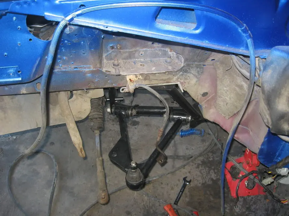

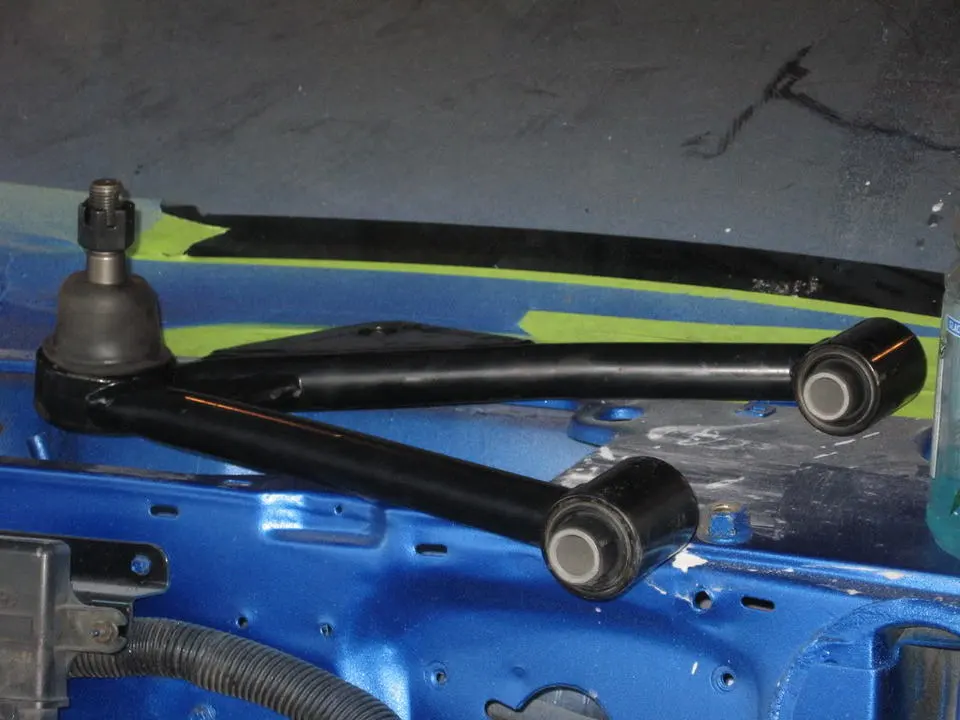

ok i installed my kmemberwhen i went to install the rear A arm bolts there is no enough clearence for the complete bolt head to fit inbetween the rear tab that the arm bolt goes throgh and the tab that bolts the k member to the car. should i clearence the k member or shave part of the bolt head?
you have to cut or grind down a part of the headbolt to make it fit with the k member ,heres a pic of the bolt cut or watever you want to do with it.

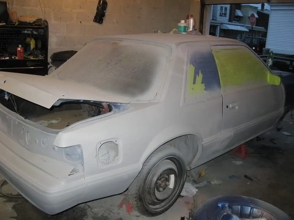

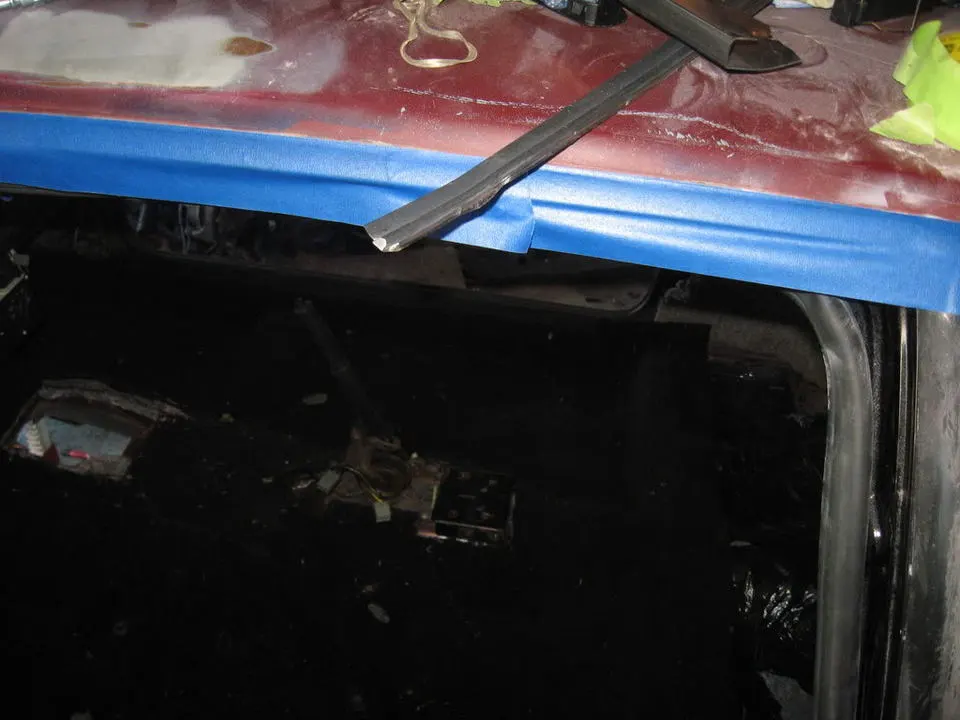

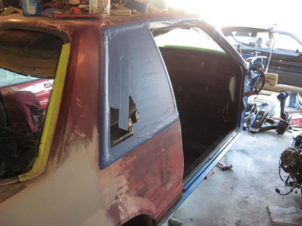

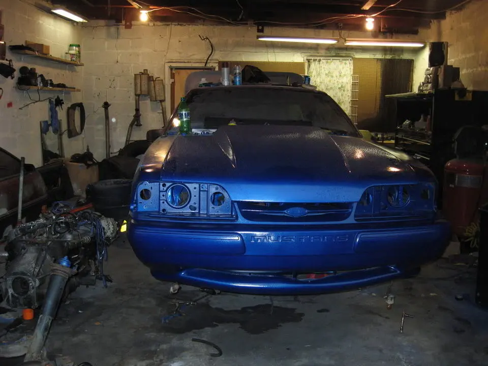

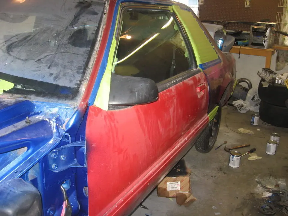

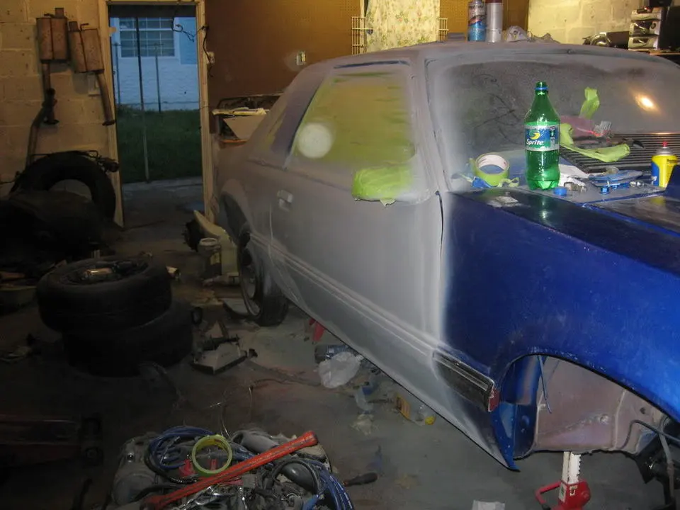

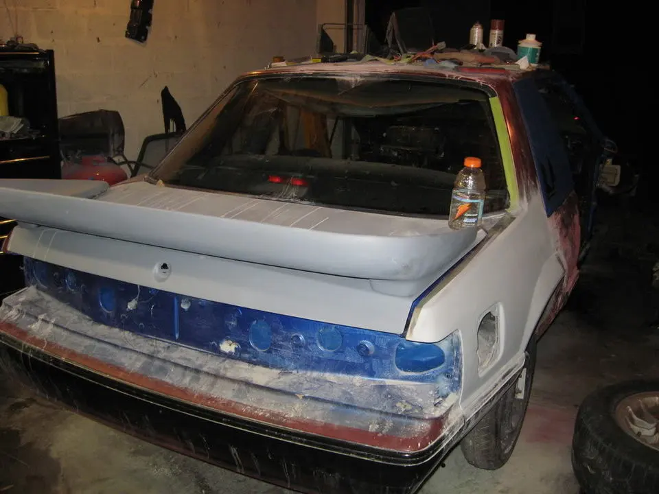

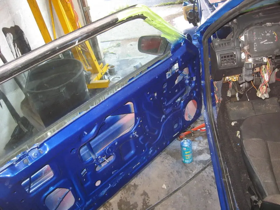

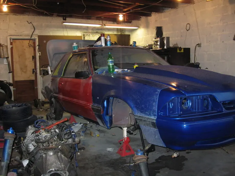

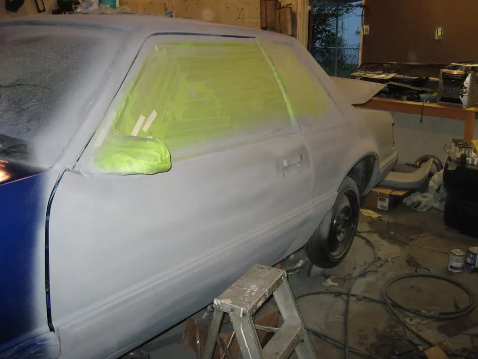

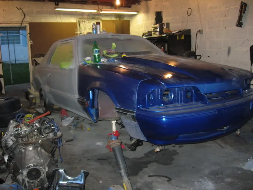

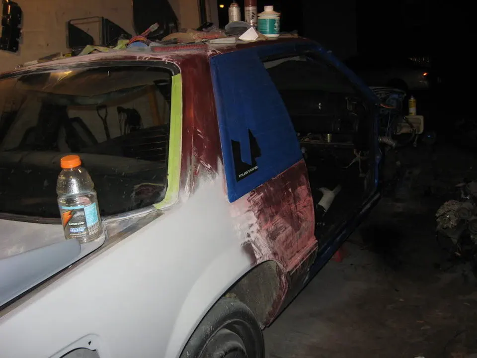

You should remove them window moldings and quarter windows. Thats the only way to paint a car IMO. And its really not that hard to take them out either. How come the paint looks really orange peely? And why didn't you power wash that rack? It kinda looks bad bein all dirty an stuff. Looks like a fun project, Im doing pretty much the same thing with my two cars.
