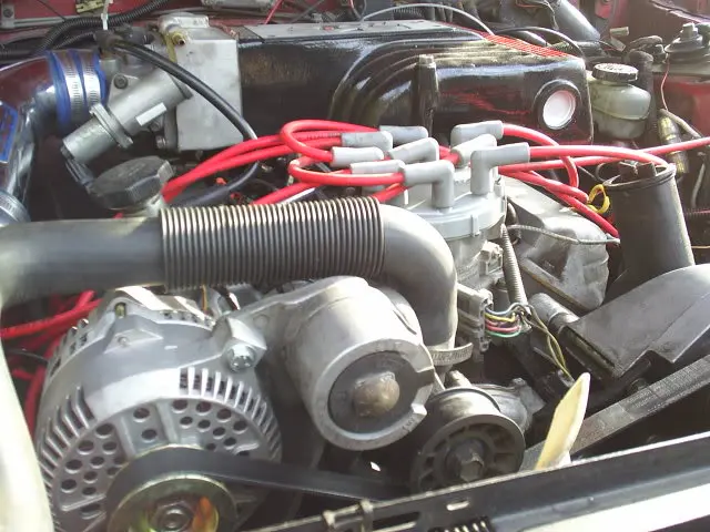

i used the 4awg wire and 200amp ANL fuse i already had inplace hooked up to my sub amp (jbl 1200.1) since i have no subs, i yanked the wire out of the car and put connectors on each end, on to the hot side of the starter solenoid and the other to the back of the alt....
