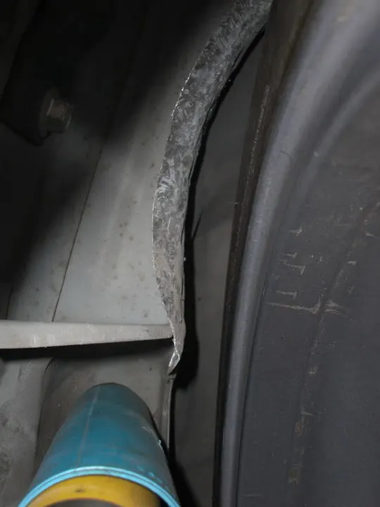

any one have pictures of how much you had to beat in the wheel wells? im going to try to move my hood with everything in it to a set of saw horses to get the front end up and put my coil overs on and then the rear on jack stands to flip everything to pull the brakes in. wanna put a picture or to back there so i know where im gunna have to beat on
this is the only thing ive found....

i beat the living hell out of my fenders to fit the 275s under it, didnt really need to do as much but i figured id go ahead and "prep" it for 315s...just mount them, see where they rub and swing away...rolling the fender lip will probably have to be done too...and flipping quad shocks, and having the right wheels.
Well if a recall correctly they put a 315 on a 10.5 PonyR rims for that project ttop coupe in the magazine 5.0 Mustangs and Super Fords. I also believe they showed pictures of how they modified the inner fenders. It was a while back but chech their website im sure its on there! I believe they fit pretty well! If it were me i'd copy what they did but maybe find a different wheel but with the same specs as im not a fan on PonyR's! fyi
