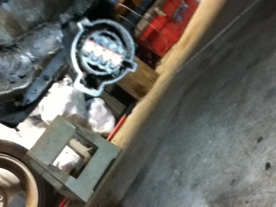

hi ive been working on my sn95 for about 2 weeks this winter so far and noticed a connector thats unconnected to the rest of the harness. and ive done a little research on it and its the H.E.G.O. harness and i cant seem to find the main harness connector that connects it to the computer. now to the point. does anyone know where the connector is located it is nowhere in sight. here is a pic of the H.E.G.O. connector that ive mentioned.

Those plugs go directly to the O2 sensors. Do you have O2 sensors, or just forget to hook them up? You have one per side, screwed into the midpipe before the catalytic converters.
the dumb bass that owned the car before me had it stuck behind the power steering pump bracket. so if figured out the problem thanks for the help tyler16.
