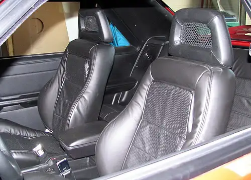

Roland69's halo headrests look sweet. So all you do is reach up from under the seat and pop the old ones out. then they just slide right in? some people are saying you have to remove the black plastic piece on top of your seat? How and doesnt that hold some seat fabric together?
