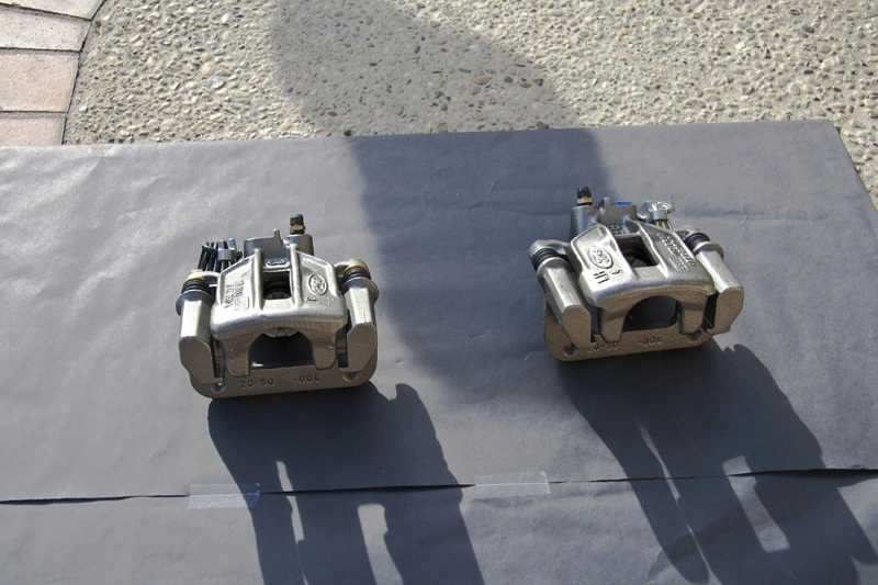

So, My brake had this weird feeling coming from the rear. I had a feeling something was up, so i took the wheel off to find out one of my rear brake calipers was locked up at the Slider pins. They were rusted clean. All attempts (even with a torch) to remove the pins failed, So i bought a re-man'd caliper. Since I am OCD about my car, I did the other side at the same time. The parts store ended screwing up and only charging me for 1 caliper for I got the second for free.

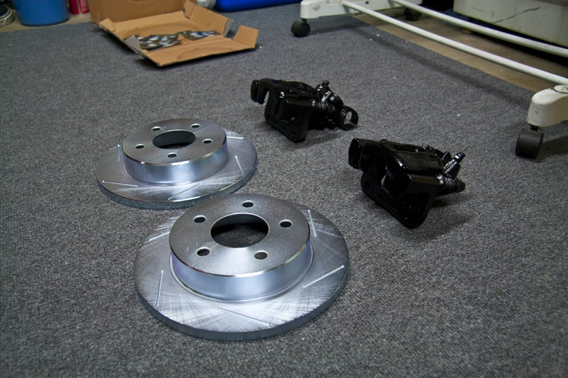

Brand New (old) Calipers!!!

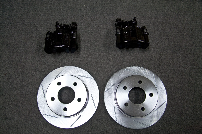

Since RotorPro is VERY close to my house, i drove over to richard and got some new Slotted rotors for the rear!!!
Here is the finished product after a few coats of black paint + Clearcoat

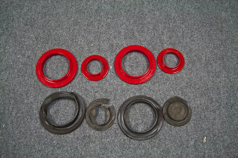

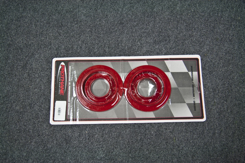

Also replace my Totally worn rear ISOs with new Poly Ones!!

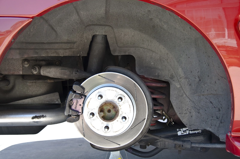

Finish product!!! Next: Paint Wheels Wells!!
I also painted my rotor hats and splash guards when I put on my drilled and slotted rotors. I also repainted and cleared my calipers in silver, it looks the best I thought with sonic blue.
