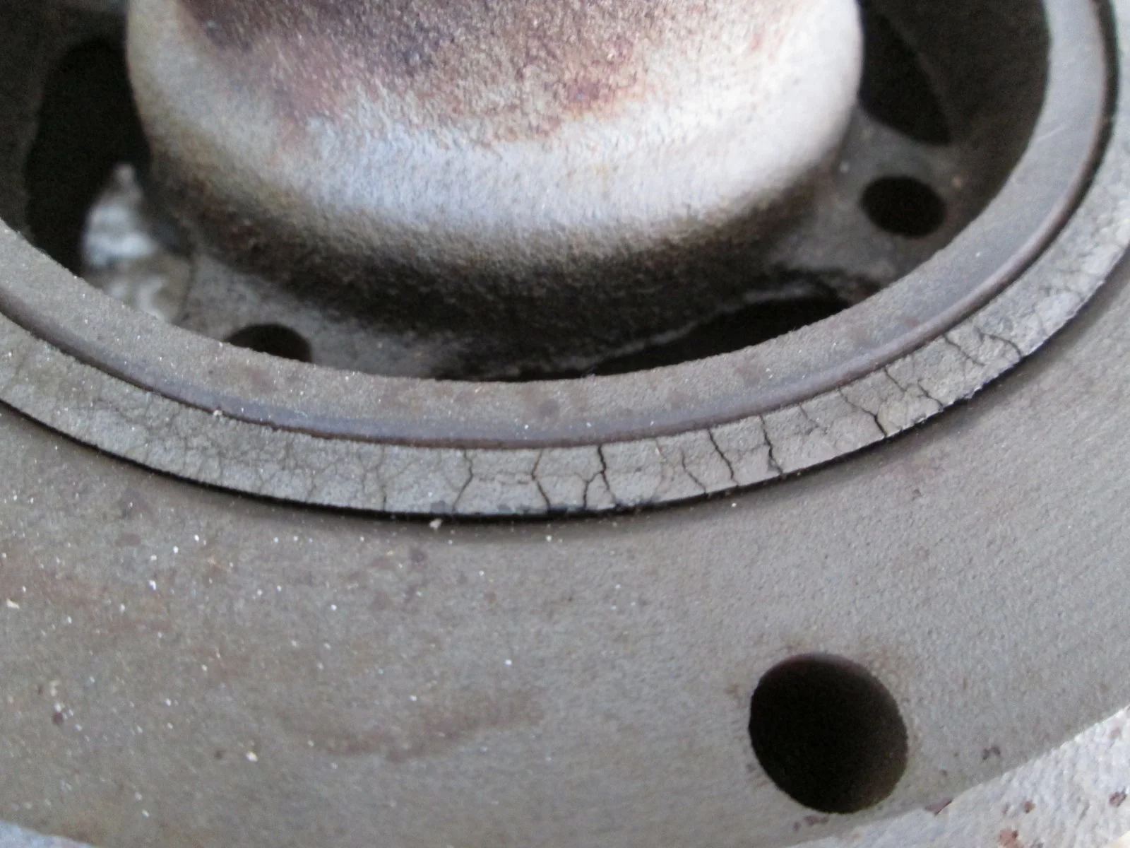

I just got done replacing the balancer. It went pretty smooth, no issues to speak of. The old balancer looked to be in good shape, no cracks in the rubber, no bulges either but it did wobble. I compared it to the new balancer and it looks like the counterweight spun on the rubber about 10°.
The vibration is now gone, and it runs smoother than it has since I bought the car.
I know an SFI balancer isn't necessary but I do think it's a better part than a stock replacement.
