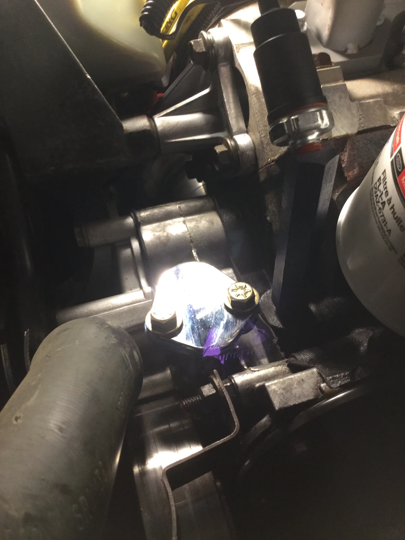

There is little oil on the floor when the car sits for a while. I would like to replace the gasket.
Can I do this without draining the oil first?

93? The timing cover, if it's stock, there should not be a provision for a mechanical fuel pump. Has the timing cover been changed?
Got a pick?
It's a 2005 era Ford Racing GT 40 crate motor.
the timing cover hasn't been changed.

Yeah, 'crate' engines likely have the 'universal ' type cover, clean up the face of fp mounting and the cover, spread a thin coat of Black RTV on both surfaces, wait a few minutes, assemble and snug up the bolts, wipe off the excess and let it sit over night or longer. Good to go, oh, one more thing, if the bolt holes go through the cover I would put some thread sealer on them.
