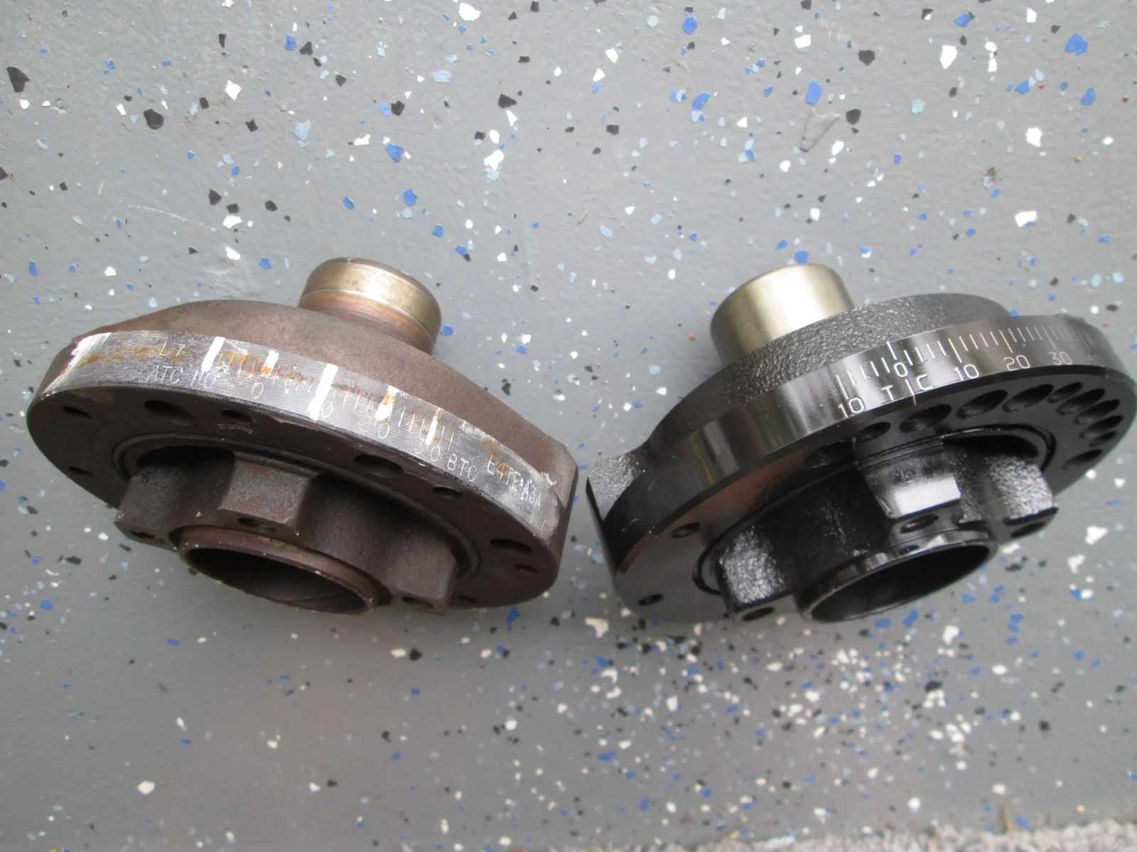

That frpp replacement is JUNK last one I saw didn’t even have timing marks and rubber was already seperating
Powerbond PB1084ss . Made by gates . Sfi approved . No hubs or adapters needed for the crank pulley . Timing marks are laser etched
This is why I like the innovators west balancer; the numbers are engraved on it.

No, it's something else. Woody at FordStrokers told me all about it. There are two types of harmonic vibrations, and the elastomer dampens the more prevelent one in an SBF better. That's why I went back with an elastomer one. The Pioneer one is a basic elastomer balancer with an SFI approved lock ring. I think it's worth the money. So much cheap stuff out there now, I don't think I would trust an Anchor brand or something like that.

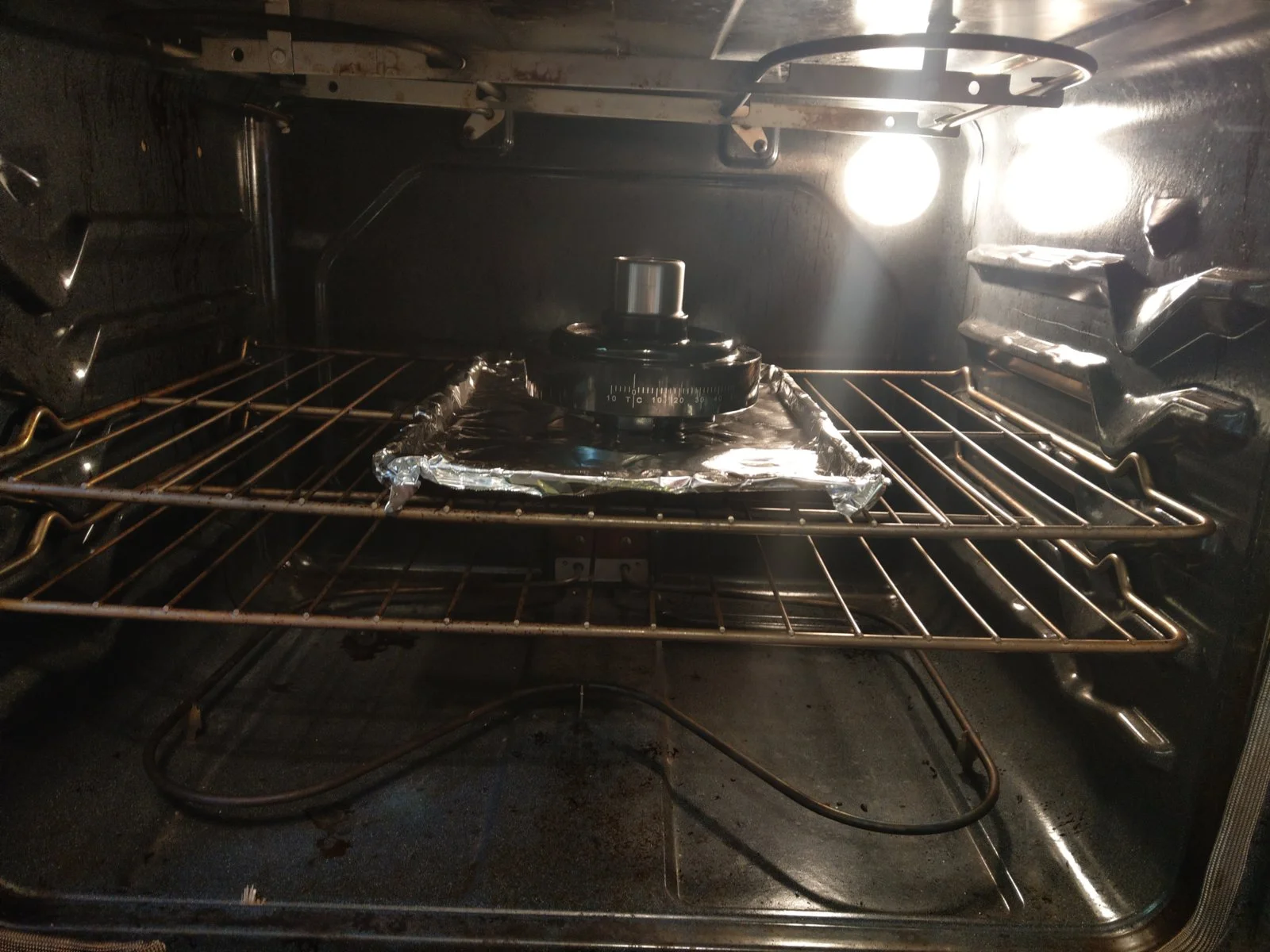

Now, for installation, don't do what we all did back in the day, and hammer that bitch in with an impact gun. I did that for many years, and it finally went bad on me. I was carefully re threading an $800 crank shaft. You really want to put that thing on with a harmonic balancer installation tool. It's a free rental at Advance Auto Parts ($119 deposit). I know that number because I put one on this morning. The tool is not perfect. You will need some sort of extension pipe to go behind the thrust bearing on it, and the center of the damper so that you can reach the turn bolt with a 1 and 1/4" wrench. I found that two races from the input/output shaft bearing from a T5, and a pilot bearing missing the rollers works perfectly. You are probably not going to have to those exact items laying around, but you will need something. Things go a lot smoother if the balancer is big, and the crank is small. You want everything to slide together like sloppy seconds. I like to heat up my balancer in the kitchen oven at 290 degrees for 40 minutes before I attempt to install it.
