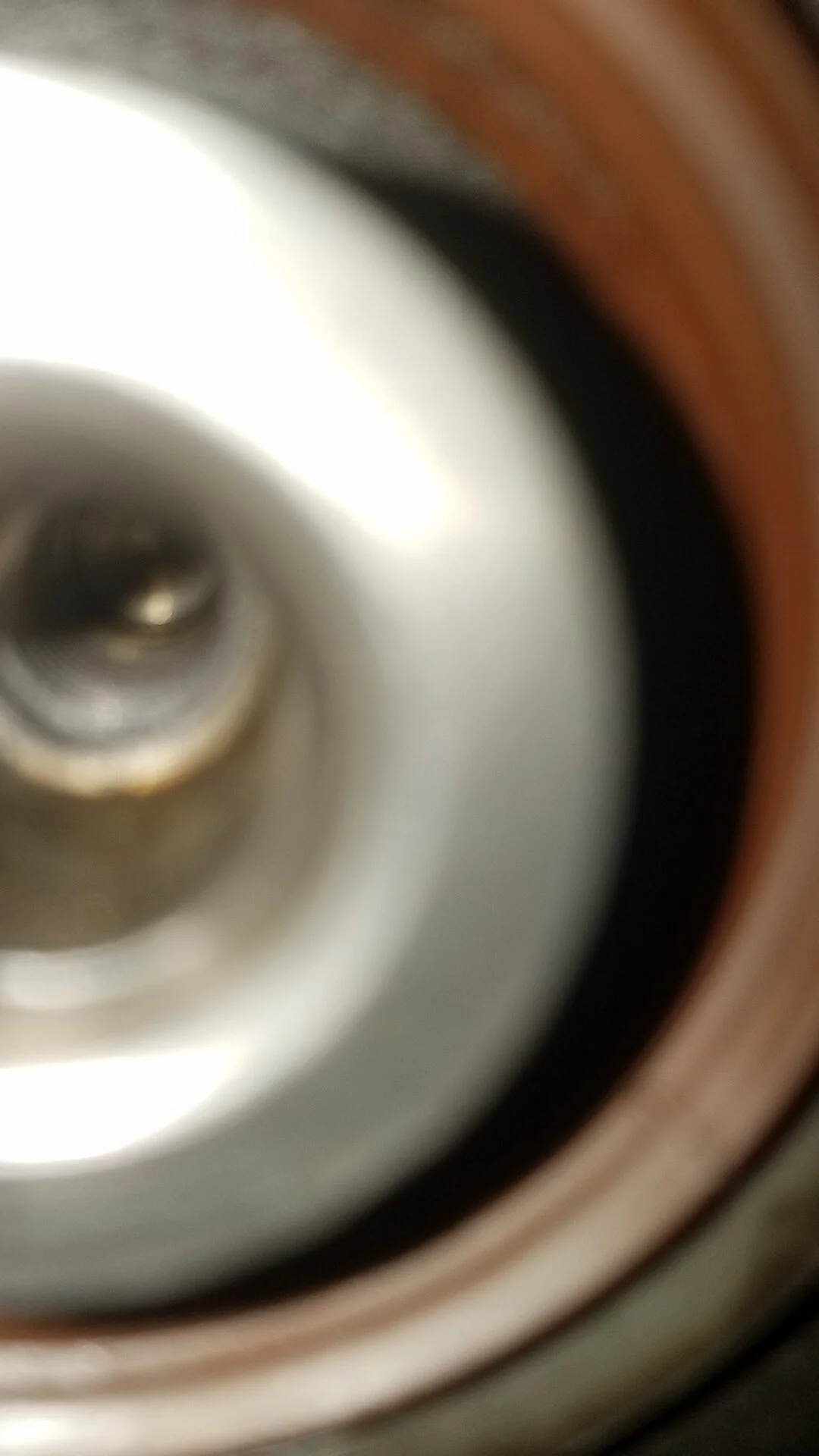

Hi all, in a bit of a pickle . In the process of trying to install a March harmonic balancer on my 2000 mustang gt, I somehow managed to damage a few of the threads in the crankshaft. The balancer was EXTREMELY hard to get on even using a puller tool and heating in the oven, and I guess I didn't have the puller tool threaded all the way in at one point and it snapped out. I had the balancer about 3/4 way on (it's off now). Im not sure I feel comfortable re-tapping threads, should I just have it towed to a shop??? What are my options? It looks like it was just the first couple of threads that were stripped out

If you don't feel comfortable doing it, don't. Screwing up, even a little bit, will leave you needing a new crankshaft.
As it is, the crank could be okay with a simple thread tap run in-and-out, but if not, it'll need to be drilled and heli-coiled, and on a crankshaft, it's delicate work, I've done it once, on a Chevy 400.

Ok, thanks for the reply. There's no way I could still get the bolt started and torque it down?I guess I'll have it towed to a shop ugh. Any reason why the balancer would be so difficult to get on? I made sure the crankshaft and it were lubed up well and put it in the oven for 20 mins at 250. Are March dampeners just known for that?

If the bolt will still start and thread in without any extra effort, and you still have the vast majority of the threads in the crank, you might get away with using blue threadlocker on it and torquing it to spec. You'll have to be the judge of that. Just remember that if a balancer flies off the end of the crankshaft, it damages other things when it does so.

If you hurt the first few threads most parts stores will have an M12x1.5 tap, make sure you tip it in grease so that any debris sticks to it.
