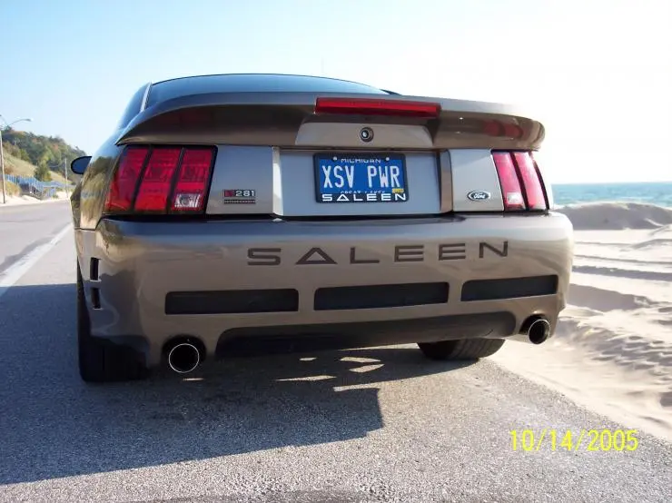

i put the mac catback on my 03 saleen (not centered) i should of spent the time myself to line them up better as i have now cause the shop didnt do such a good job and they came loose and melted into the body somewhat on both sides.. cant see it unless u are right there lookin at it.. i have a tru x (vrs) o/r x with it and its loud and pissed off :)

ragu1585- do you have any pictures of the tailpipes after install? i want to see how the tips look in the saleen bumper. thanks!!
