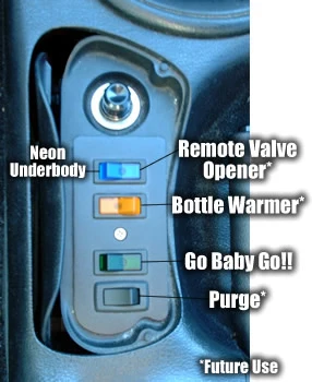

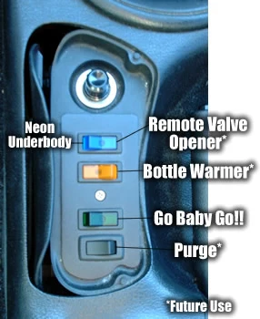

Trust me on this... you DO like the fact it works at WOT. I still turn my zex kit on manually as you speak of.... but it won't come on unless the car is at WOT. This is a safety measure that you NEED.
I have my switch installed in the ashtray.
This way I can close the ashtray cover to hide all the switches.
I can't launch my car on the bottle on drag radials or street tires. But I can feather the launch, hit WOT, once the tires hook, press my thumb on the power switch and kachow! :D Nitrous hits and it's time for your body to pucker your arse up a bit.
On a stock engine (with bolt ons) I went from a 14 flat to a high 12 on the 125 shot dry kit.
