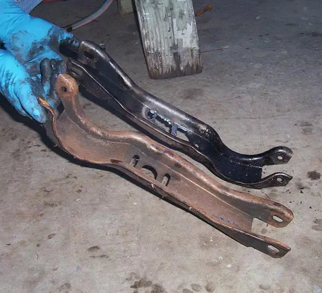

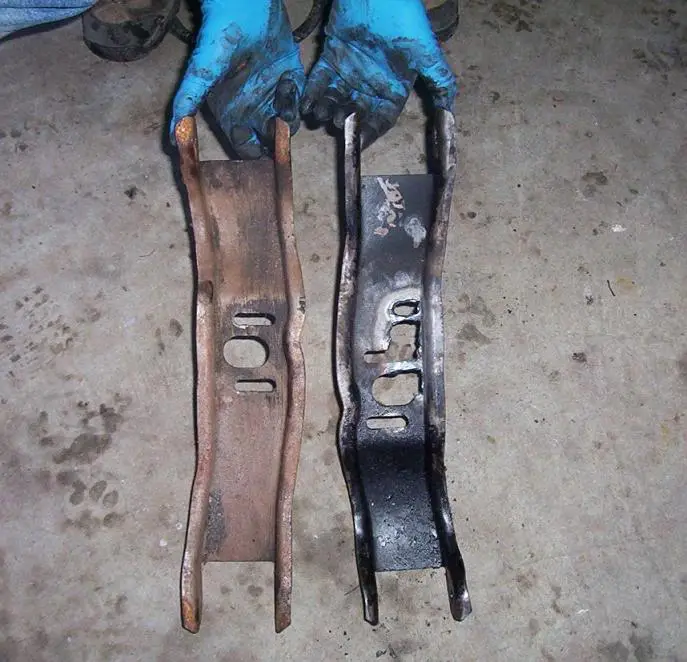

I used a single-hump crossmember by turning it around and cutting a new hole in the crossmember with a torch on the driver's side. Ugly but it's solid, and it fits the Hedmanns just fine this way. I'll post pics when I get home tonight.
What I did was to take the tranny crossmember out of the car after marking where the exhaust needed to go through at. Then I build another hump and welded it to the crossmember where I needed the clearance. Then I cut out the old section that caused the problem, presto! double hump crossmember with hardly no measuring needed.
Guess I'm okay as long as MadMark doesn't see this. . . :rolleyes:

You have two single humps. So do what I did. Make a jig. Cut the" hump" off the unuseable crossmember ( the one you torched holes in ) and weld it to the good one. PRESTO-- a double hump. A small amount of offset is required between the two , but with some grinding and welding you can make it look good.
Damn. I'm doing that next time. :nice:
