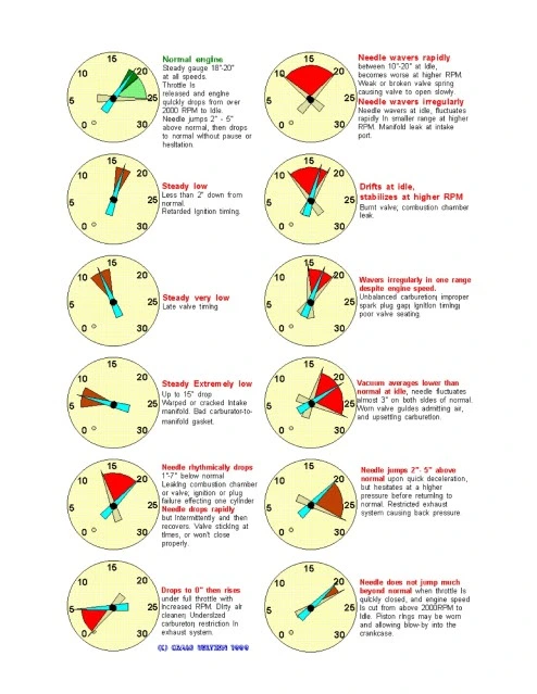

No vacuum. Just enough to make the gauge barely move. No reason why there is no vacuum. Pressure tested intake through coolant system and no leaks, held 20lbs for 4hrs. Pressure tested intake through carb, no leaks can be found, though some air can be heard inside the carb somewhere :shrug: Timing is where it should be.

Was the car running just before you changed the intake and carb? here a picture of different vacuum situations.Check the one on the bottom left, It does list undersized carb or clogged exhaust as one possibility for little to no vacuum.
