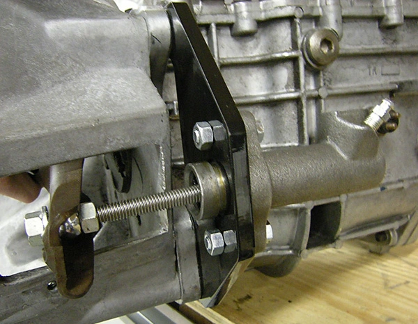

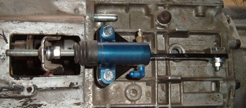

this is a typical slave cylinder install. I don't know of ANY headers that put their primary tubes in this area. Note the AN fitting on the bottom...you simply route the flex line(probably braided stainless) so it doesn't hit any primaries and you will be golden.
different slaves are likely to have different hydraulic port fittings...but they should all be fairly similar. Remember...even if the slave wasn't here, a cable would be...so if the headers fit a cable clutch they will CERTAINLY fit a hydraulic clutch.
Reactions: Olivethefet
Another thing to note here....even if you go with the modern drivetrain kit...you can always swap the slave cylinder to one that works better...for example, you might want a pull-type slave rather than a push-type....but in general, its why I always suggest building your own hydraulic conversion kit, you can design it around whatever you want...Daze has a nice write-up on a DIY kit
