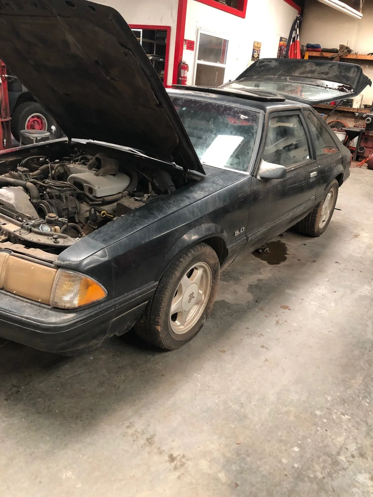

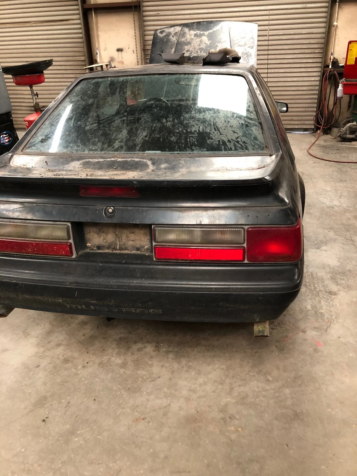

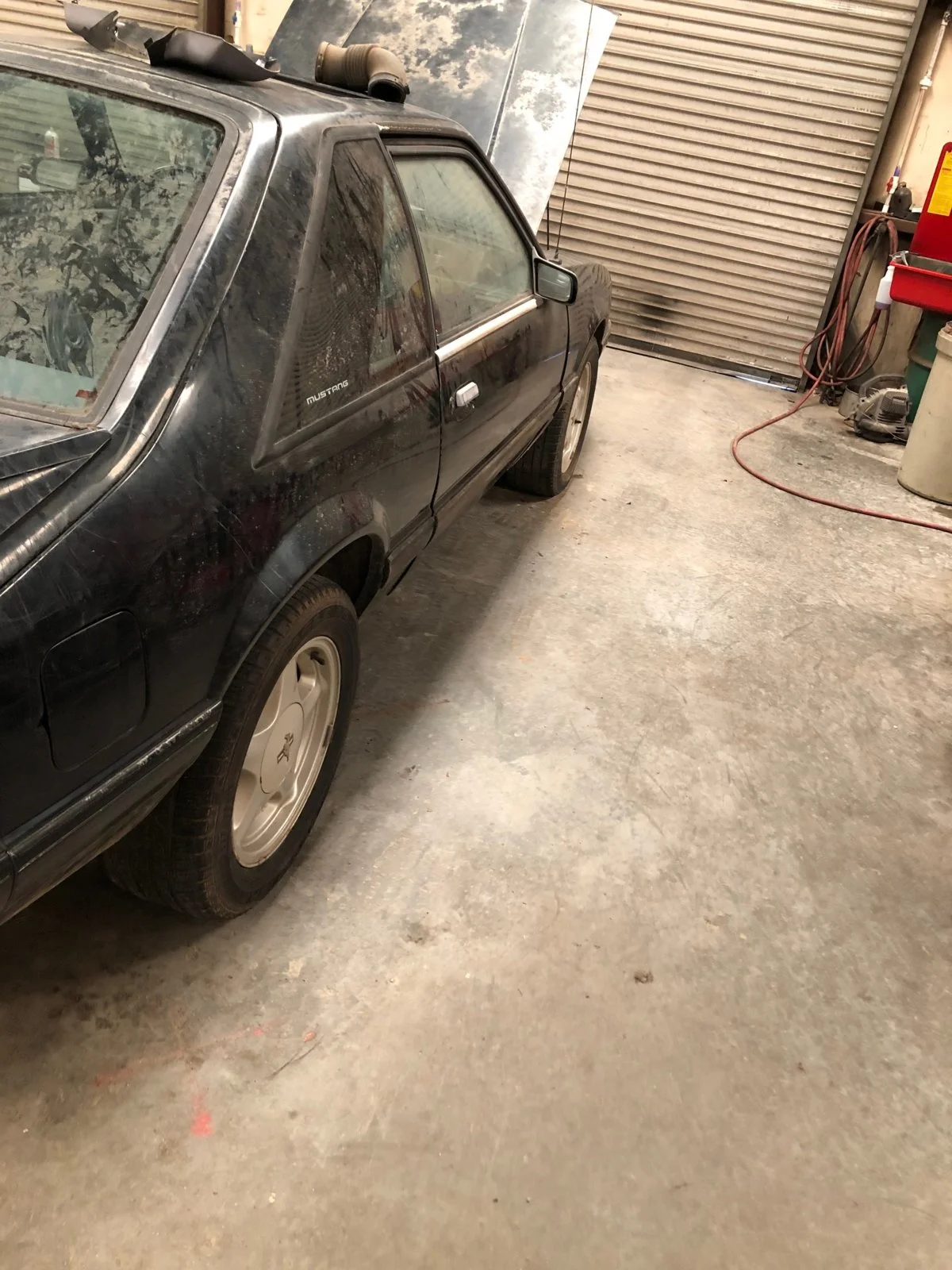

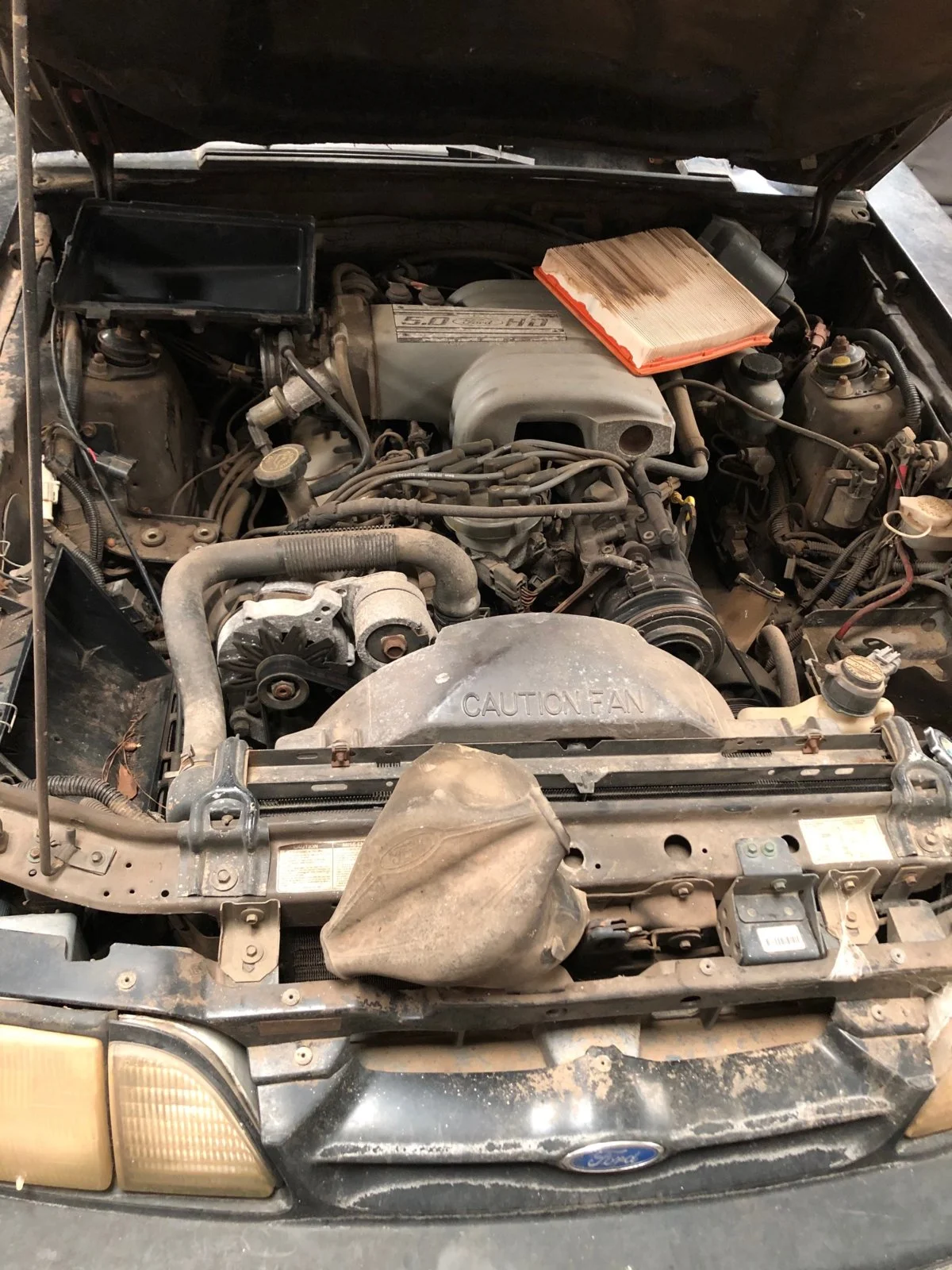

Thanks for all of the assistance! I am going to attempt to post a picture of the mustang here in just a second on this thread. I hope I can figure out how to do it correctly. The car is really rough right now (looking at pictures) and fairly rough in person cosmetically (no rust!). The important parts are in good shape, and the body is honest. I would rather have one like this that needs paint than one that has been pushed through maco and has 500$ worth of bondo. Has anyone used the carpet from LMR? Considering an order from LMR today. Thanks again for all of the info it has already been a tremendous help!
Solid looking. It's a little rough around the edges but you will enjoy the process I'm sure. Old car guy tip here.....don't throw anything away. When I go thru one I get a giant plastic tub from WalMart and everything related to that car has it's own tub(s). We have a tendency to say "I'll never need that part".....until we do and it isn't made anymore. I'd also go over every bit of that wiring and make sure it's legit. That goes especially for the old alternator wiring that has burned down quite a few foxes. You should rename this thread as your build thread and post your progress along the way. Very good that you got initial pics of it just as it sits now. It would be cool to see it progress and be a shiny beautiful Fox one day.

Contemplating ordering the 130 amp alternator conversion kit for my car. Replacing the wiring that comes with the kit and a inspection during the process should take care of the fire hazard right? I would hate for this thing to catch on fire in my shop!
It won't (it shouldn't) catch fire sitting (not running), the issue is the connection at the alternator overheating and I believe it was resolved by 1991 by ford, the alternator upgrade is worth the effort as long as you update ALL the grounds between the alternator and the battery/block and engine compartment sheet metal.
IMO, The 3G alt/big 3 wiring upgrade is a must.

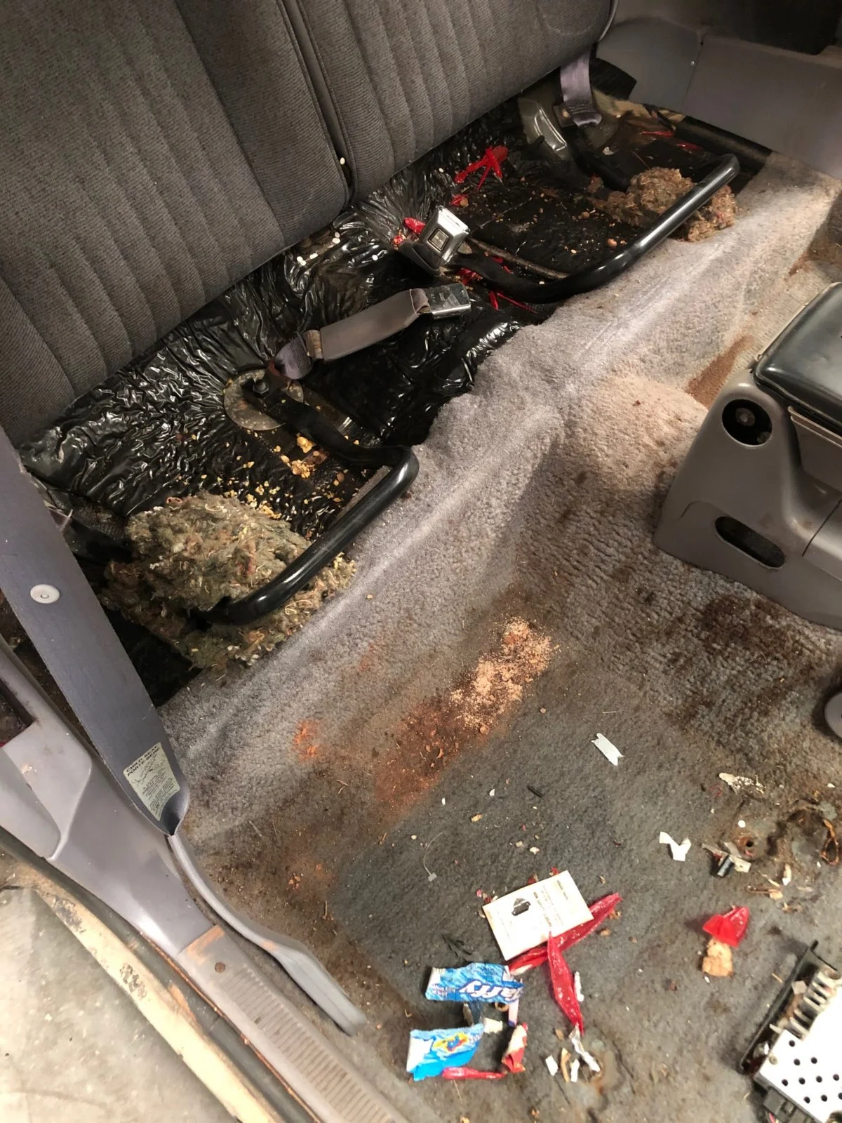

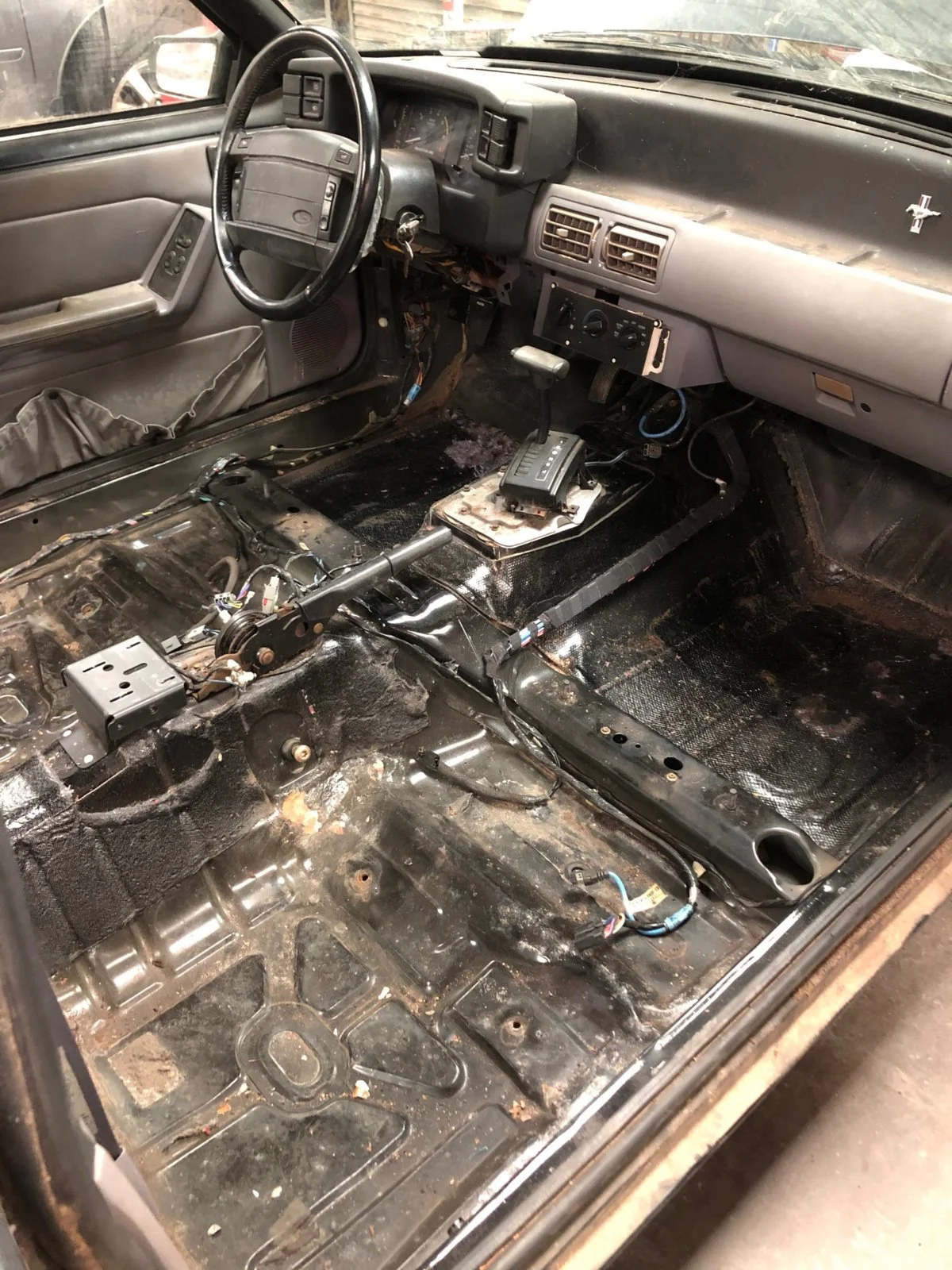

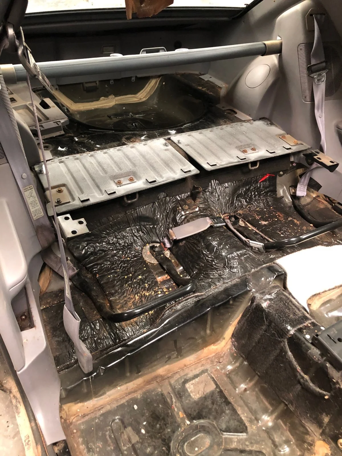

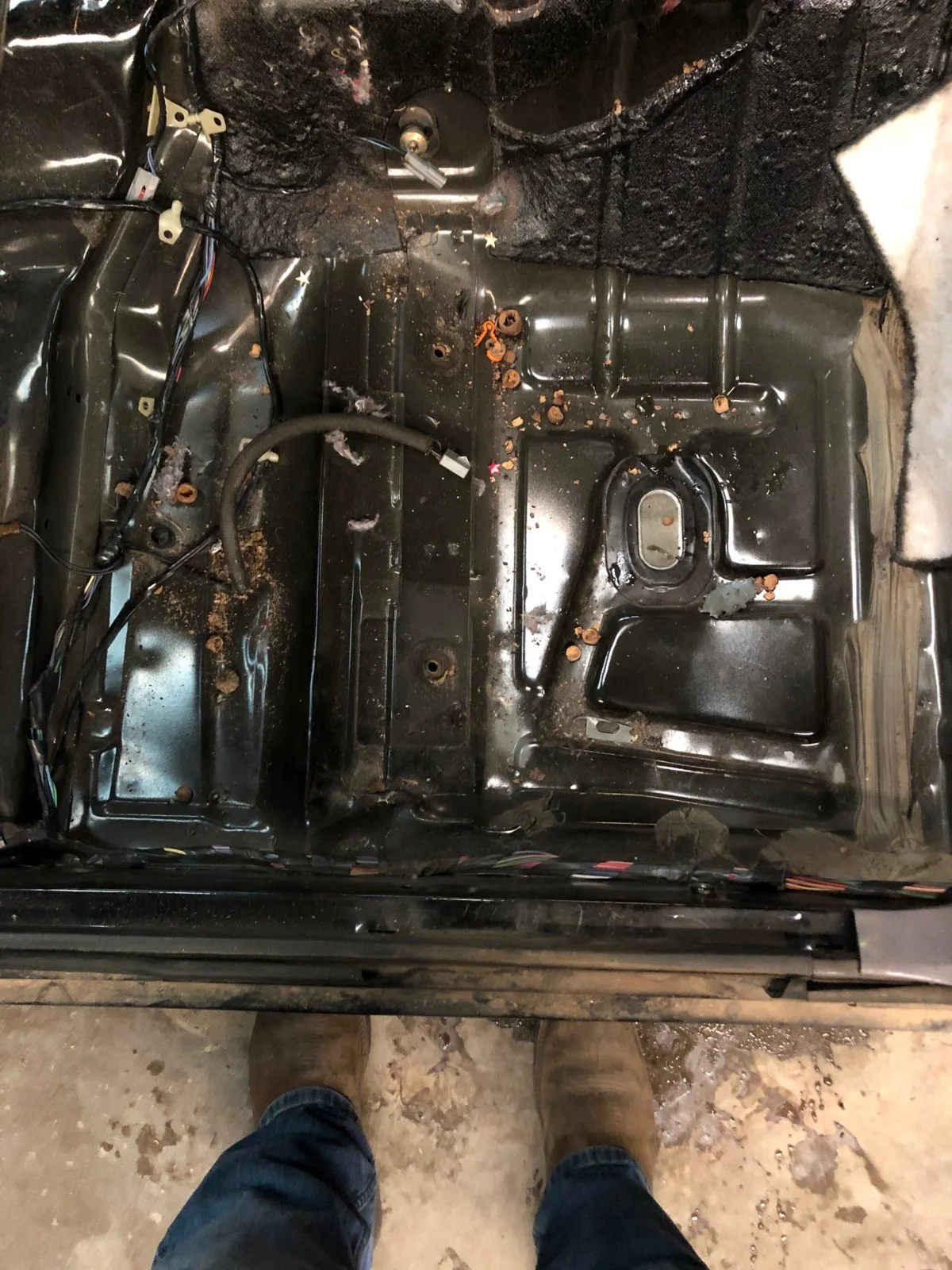

I have the carpet completely out now and am going to try to pressure wash it and clean it as well as the seats. I believe you can see part of the carpet in some of the pictures I posted, it is really rough. The front seats are pretty bad as well, the back not so bad. Does anyone have a suggestion on which type of cleaner to use? Has anyone used a pressure washer for this before? I was told to do this by a local car dealer (said he does it all the time on cars from the auction) and I have never done it before.
If you go to Home Depot you can rent the carpet cleaner for $23.00 for 4 hours. It has the scrubbing suction devise. Make sure you get the hoses their included. You soak the seats and suck the dirty water out. Keep doing it until your seats almost look new.
