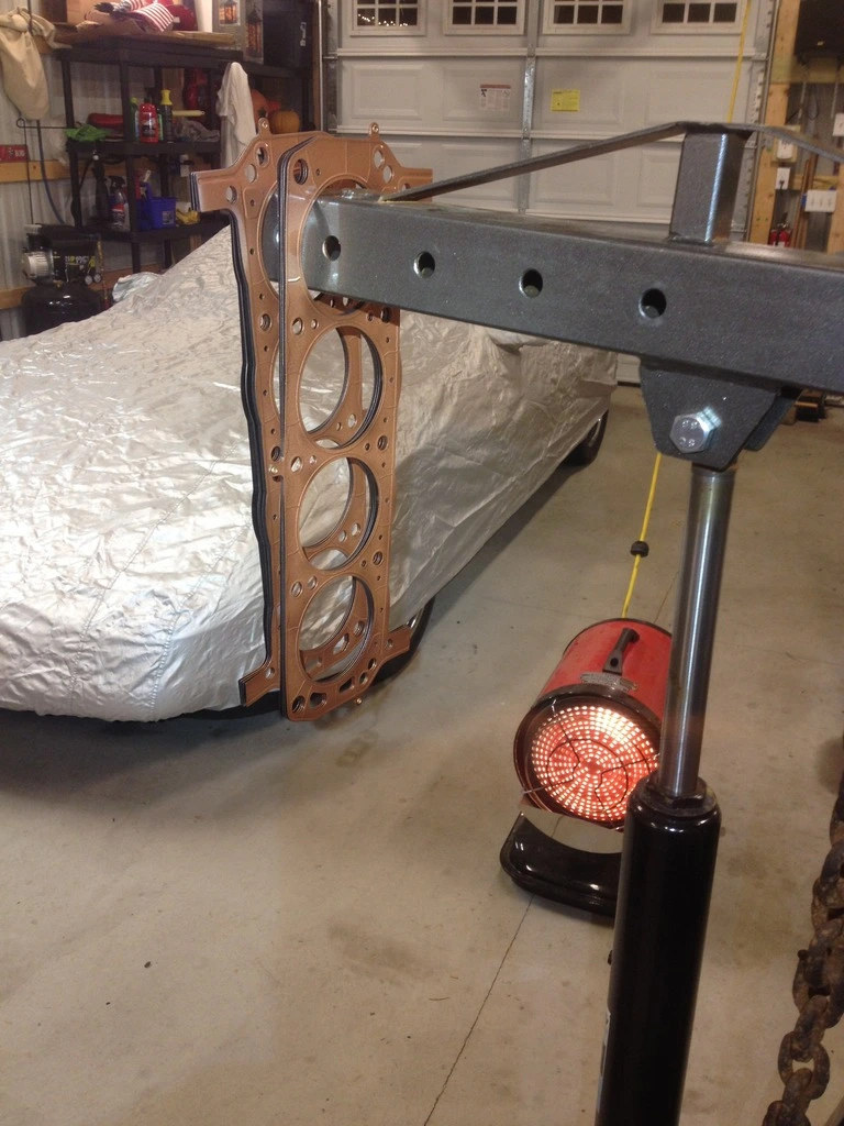

Heating the Cometic gaskets to get the Copper spray to set up. (cold in garage)

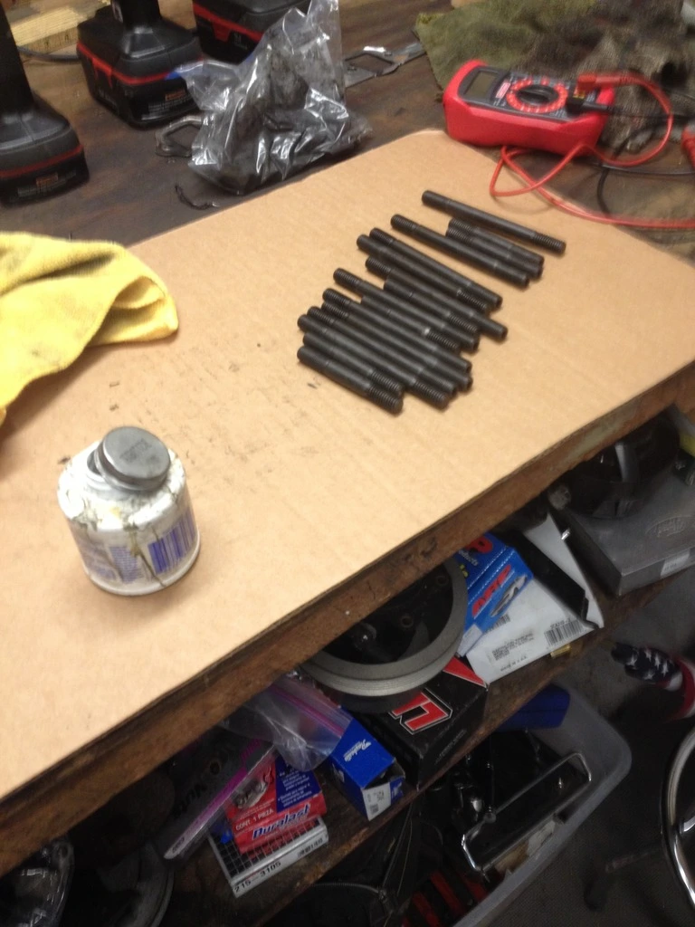

Cleaned up the ARP studs

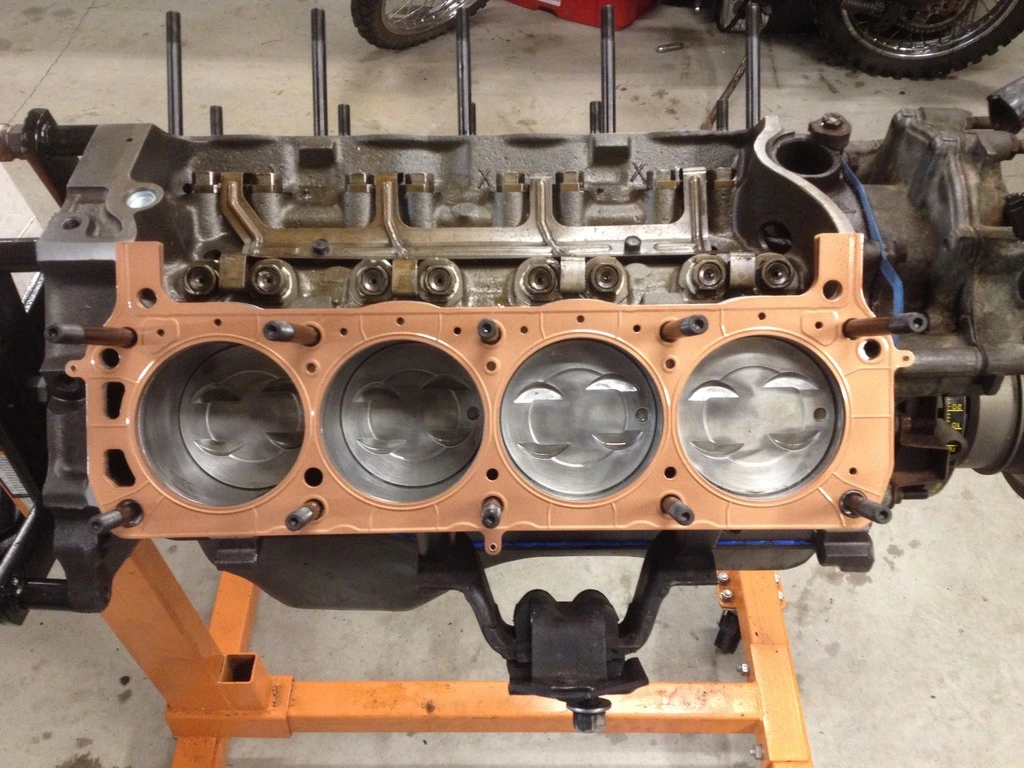

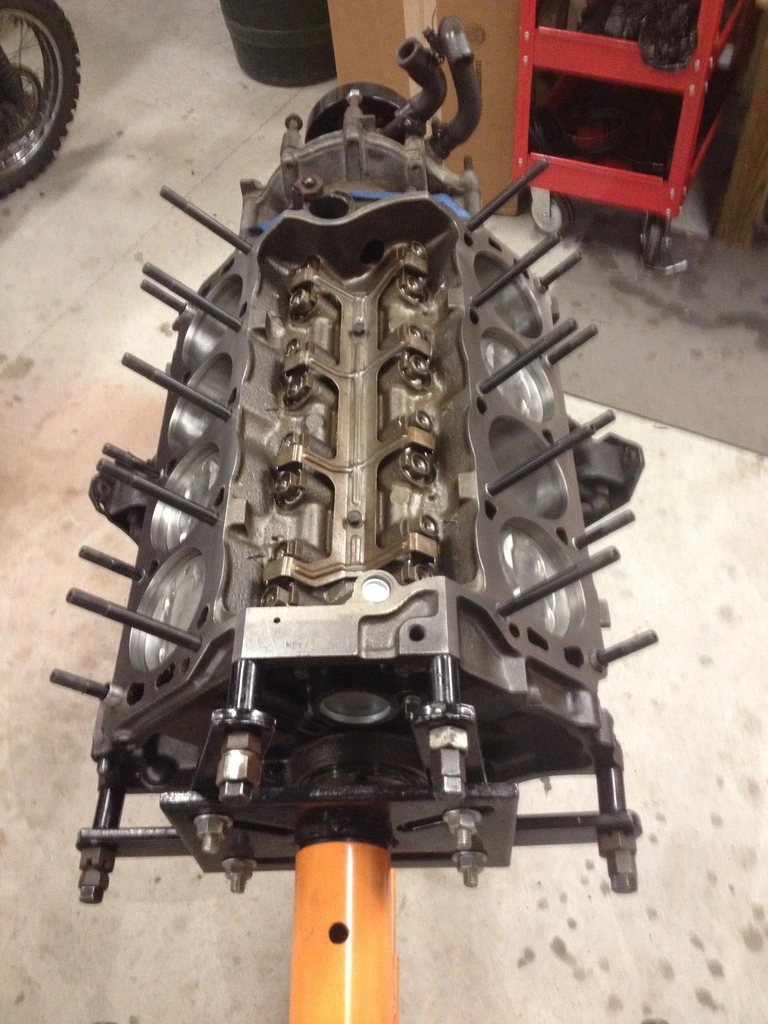

Studs installed in block
Gasket on block

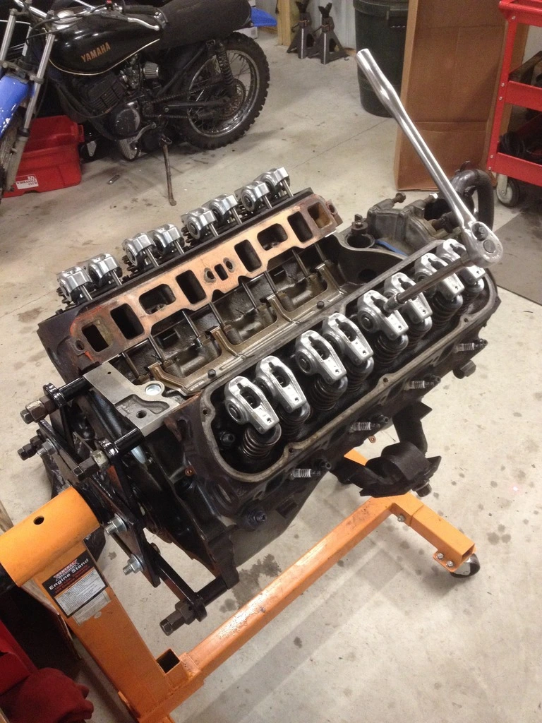

Heads on and torqued down
Btw, those are 1.7 ratio pedestal mount rockers.
I ordered the Cometic gaskets in a thickness with lifter preload in mind. The goal was to make up the difference for the block decking and head milling.
Turned out perfect. I'm getting about 3/4 turn to tq spec from zero lash. No shims needed.
