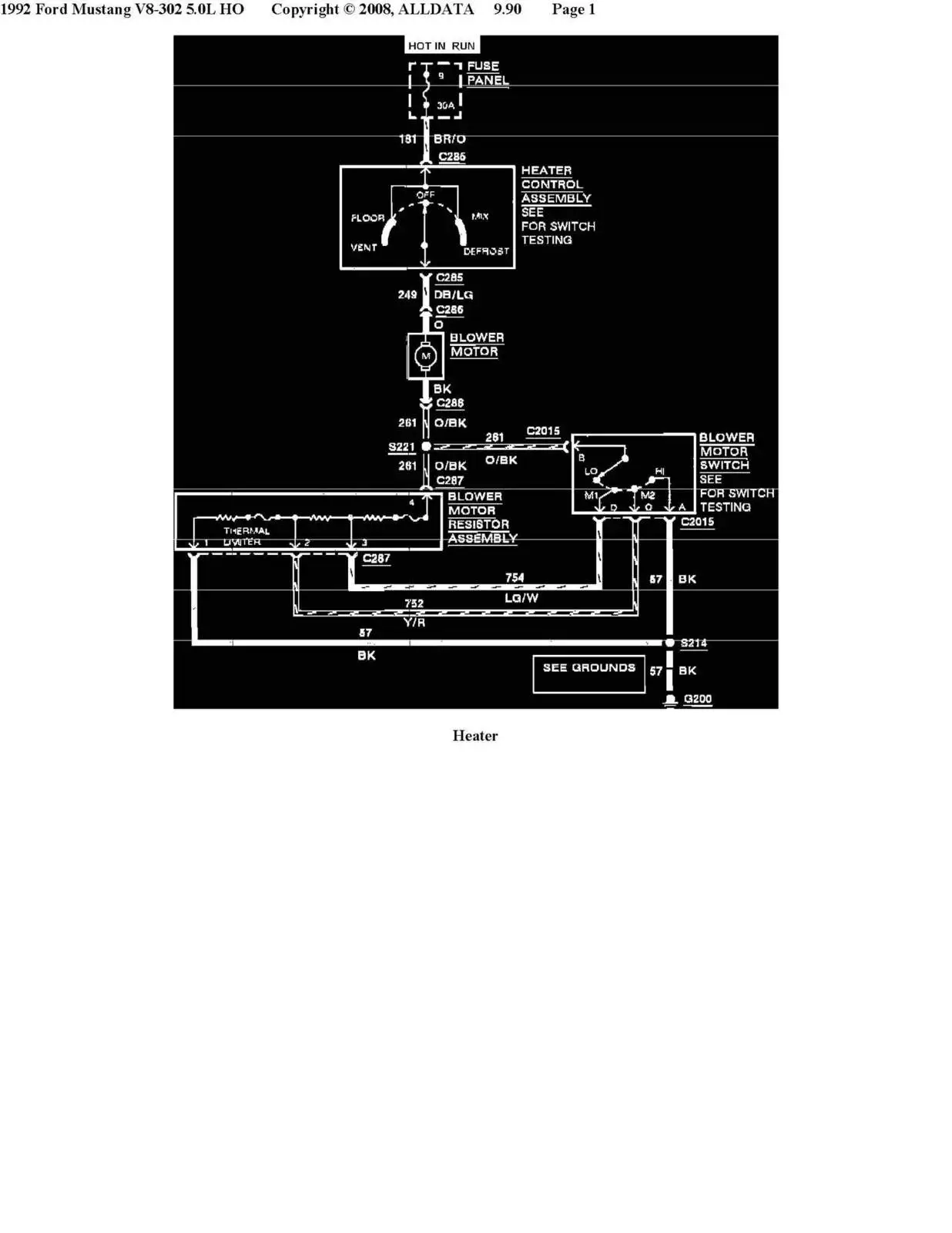

Does the blower work when the selector is set to high only? If the blower works in the high only position then I would suspect the issue is the blower motor resistor. If there is no fan action in any setting then you more then likely have a wiring issue.
1. Check for open circuit voltage at the blower motor connector while unplugged, should read 12V. If not, then check wiring from switch to blower motor for breaks.
2. Check voltage drop across the motor while plugged in, should read 12V. If you get less then 12V while doing this test, then something in the circuit is using unwanted voltage. Next step would be to trace power and ground sides to see where the resistance is occurring.
Use this diagram as reference.

Slightly diffferent version of the same thing...
The diagram is for a 93 Mustang, but should be typical of 87-93 Mustangs...

If you check out the diagram, you will notice that the blower has power anytime the ignition switch is in Run and the selector switch is in some position other than off. This uses current sink wiring, in that the device is always has power and the control part of the circuit provides a ground. No ground, no run. In automotive circuits, the ground is the return path for the power to get back to the battery.
Look for 12 volts at the brown wire on the blower motor with the ignition switch in Run and the selector switch is in some position other than off. No 12 volts: then the fuse, the wiring that feeds the selector switch or the selector switch is bad. Good 12 volts, then ground the other side of the motor: if the motor is good it will run.
Good 12 volts and the motor runs: the problem is in the wiring to the resistor assembly, the speed switch or missing ground between the speed switch and the car body. Turn the ignition switch to off, set the selector in center position. Set your DVM or multimeter to Ohms, choose the lowest range. Then check the resistance between the black wire on the switch and bare metal on the car body. You should see less than 1 Ohm. More that 1 Ohm means you have a bad connection.
