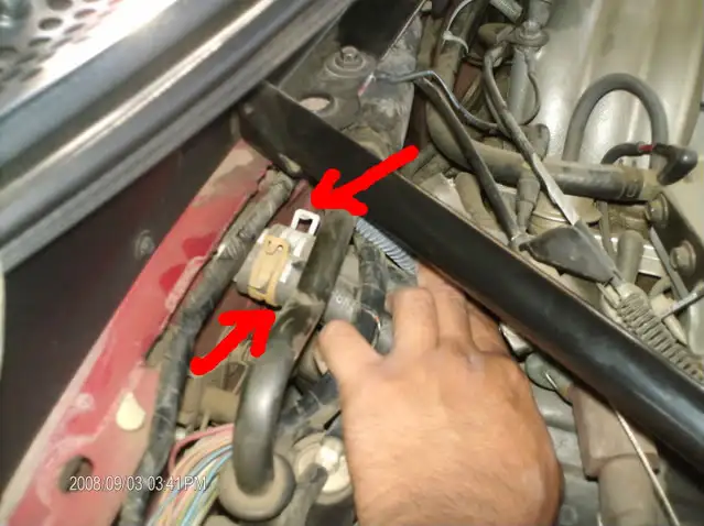

to bypass heater core.
1.on cold engine,open radiator petcock on lower passanger side of radiator.drain coolant.close petcock.
2.disconnect two rubber hoses on passanger side firewall in engine compartment.(red arrows).these lead to the heater core.
3.find small peice of pipe,connect the two rubber hoses to either end.this will bypass the core.
4.refill the cooling system.(be sure the radiator petcock is closed).
as for the small hose pouring out coolant,i belive that is a vent tube for condensation to escape.should pose no problem.i think once all the coolant has drained out of the core,it should be o.k.
if i'm wrong about this,somebody please correct me:)
Thank you for the tip. I as soon as i get off work today I am going to try that fix. I am hoping that that will be a good work around until this weekend when I can replace the core.
last night I installed the fix. Instead of connecting the two rubber hoses together I took both hoses off of the hard lines they were connected to and since they were over and under each other I cut one of the hoses I took off and made a U hooked them both together and that should take care of it until I can get a new Heater Core put in.
