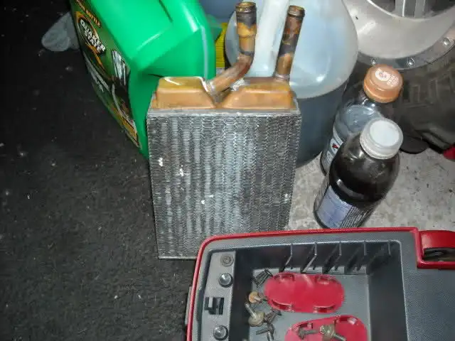

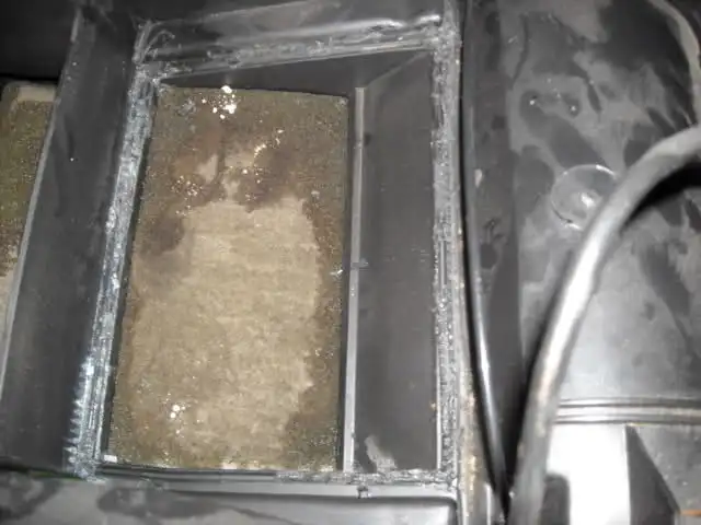

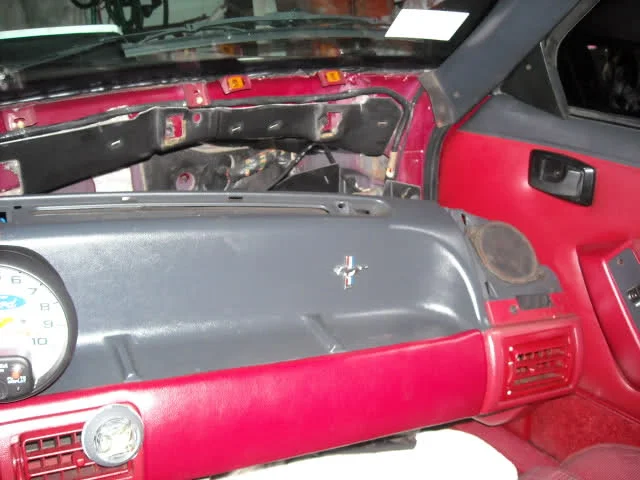

UPDATE
Well i got the old sob out what a pain in the a$$...got to wait till tomorow to put it back together..when the new core will be here....shouldnt be bad putting it back together...took about 3 hrs to get the old one out
good luck to anyone who tries its a royal PITA
