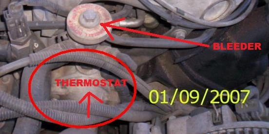

When you fill the cooling system are you opening the bleeder?

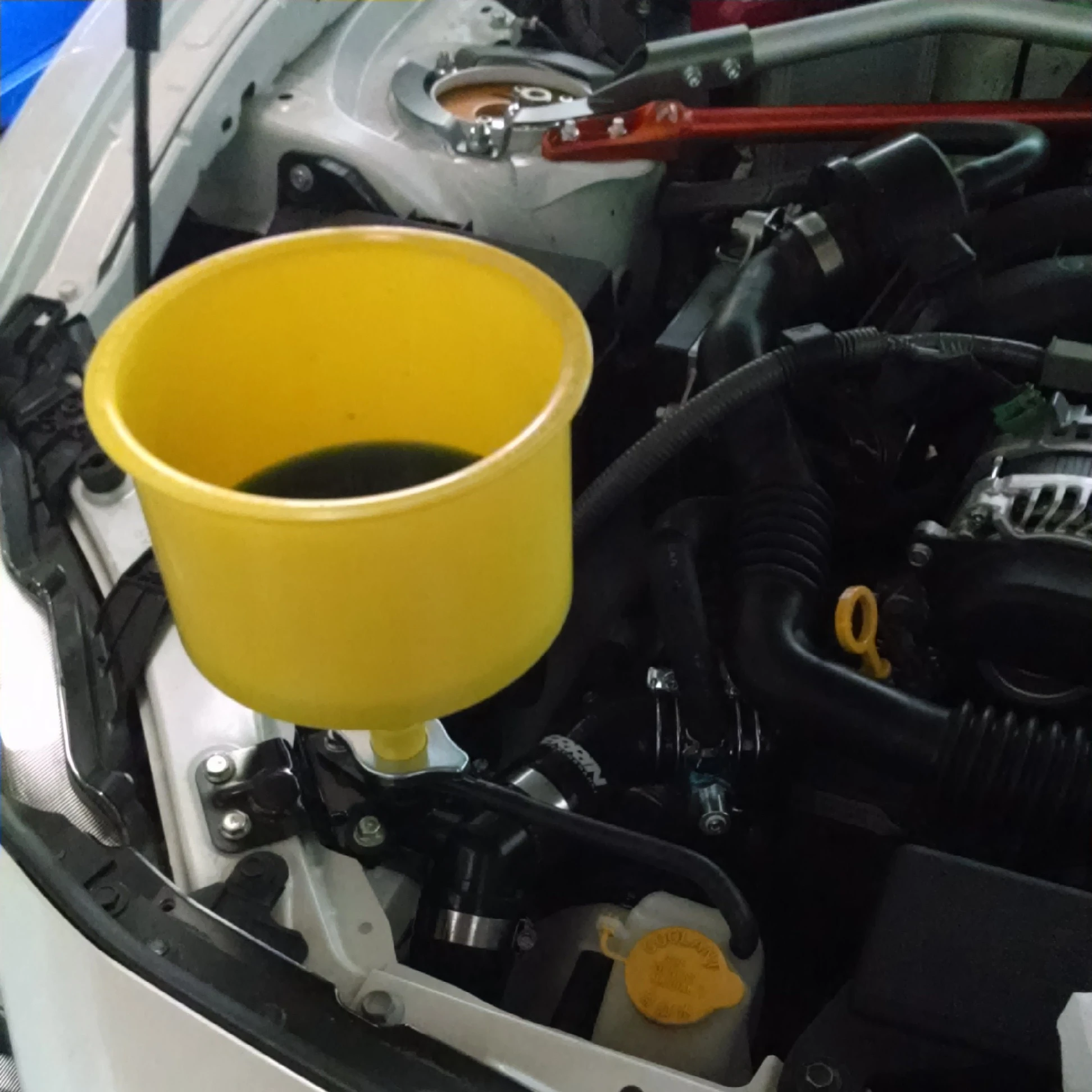

Have you tried using a coolant fill cup to burp the system?

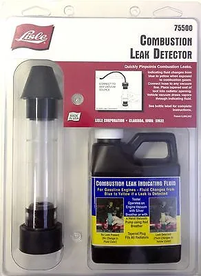

Most importantly have you checked/had it checked for blown headgasket(s)?
The bleeder:
Fill Cup:
Combustion Chamber leak detector:

1.) Have you opened the coolant bleeder screw?
2.) Do you know where the coolant bleeder screw is?
3.) That's where/what it is up there.
My recommendation to you is to drain the cooling system the best you can. Take the bottom hose loose from the radiator and drain the coolant into a drain pan. Put the hose back on.Now would be a great time for you to have a no spill fill cup,but an ordinary funnel will work,just be a little messy lol.
Put the fill cup/funnel into the radiator and fill it with green antifreeze..
Open the Bleeder screw,it should start spitting water/coolant after a moment or so.. keep the fill cup/funnel 3/4 full and watch the bleeder screw-once it quits spitting and a solid stream of antifreeze comes out-Close the bleeder screw.
Start the car and turn the heat on.Wait for the thermostat to open (and the cooling fan to come on)and suck down the antifreeze,top it off and check the heat from the vents,it may be necessary to raise the idle a little for a minute.If it starts puking antifreeze there is still air in the system . Shut it off and fill the cup/funnel back up and let it sit until the coolant level drops. Repeat the bleed procedure if needed.
And if you still have trouble,it will be time to dig deeper into the cooling system and verify what is and what isn't working
